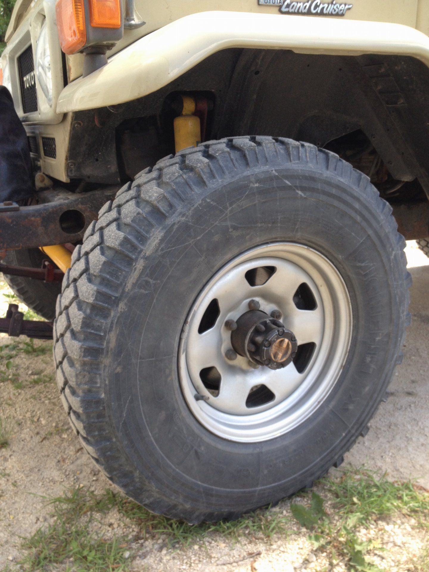

Pulled the OME shackles to clean the pins up and re-grease. Not the first Cruiser I've seen with the anti inversion shackles installed the wrong way (and upside down in this case) :hmm:

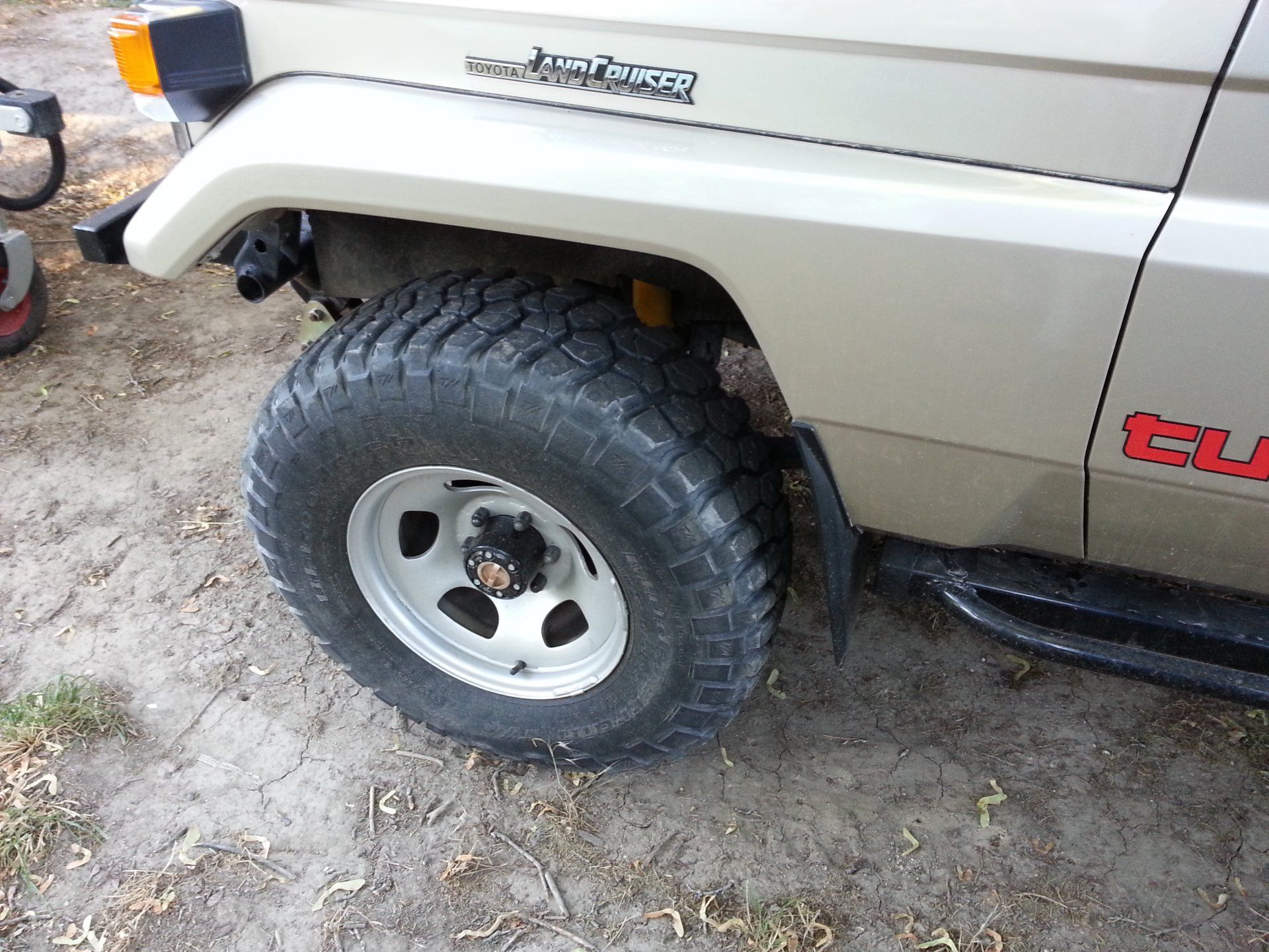

This wheel/spacer combination responds very well to the 89-94 IFS Pickup steel wheel open caps.
Stance with 1.5 spacers and 285/75/16 rubber

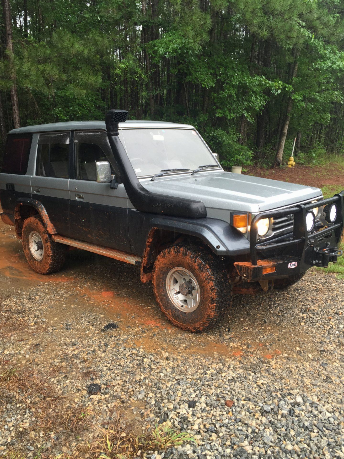

On the subject of wider stance and stability --
If one were willing to undertake the cost and custom work required what would be the pitfalls of leaf sprung 80 axles under a 70?
I know linked 80 axle setups have been used with seeming success.
I reckon the steering would be the most involved part of the idea.

Way wide and very complicated. You basically take a vehicle that can be operated under any conditions and turn it into a low speed trail truck.
You pays your money and takes your pick.
