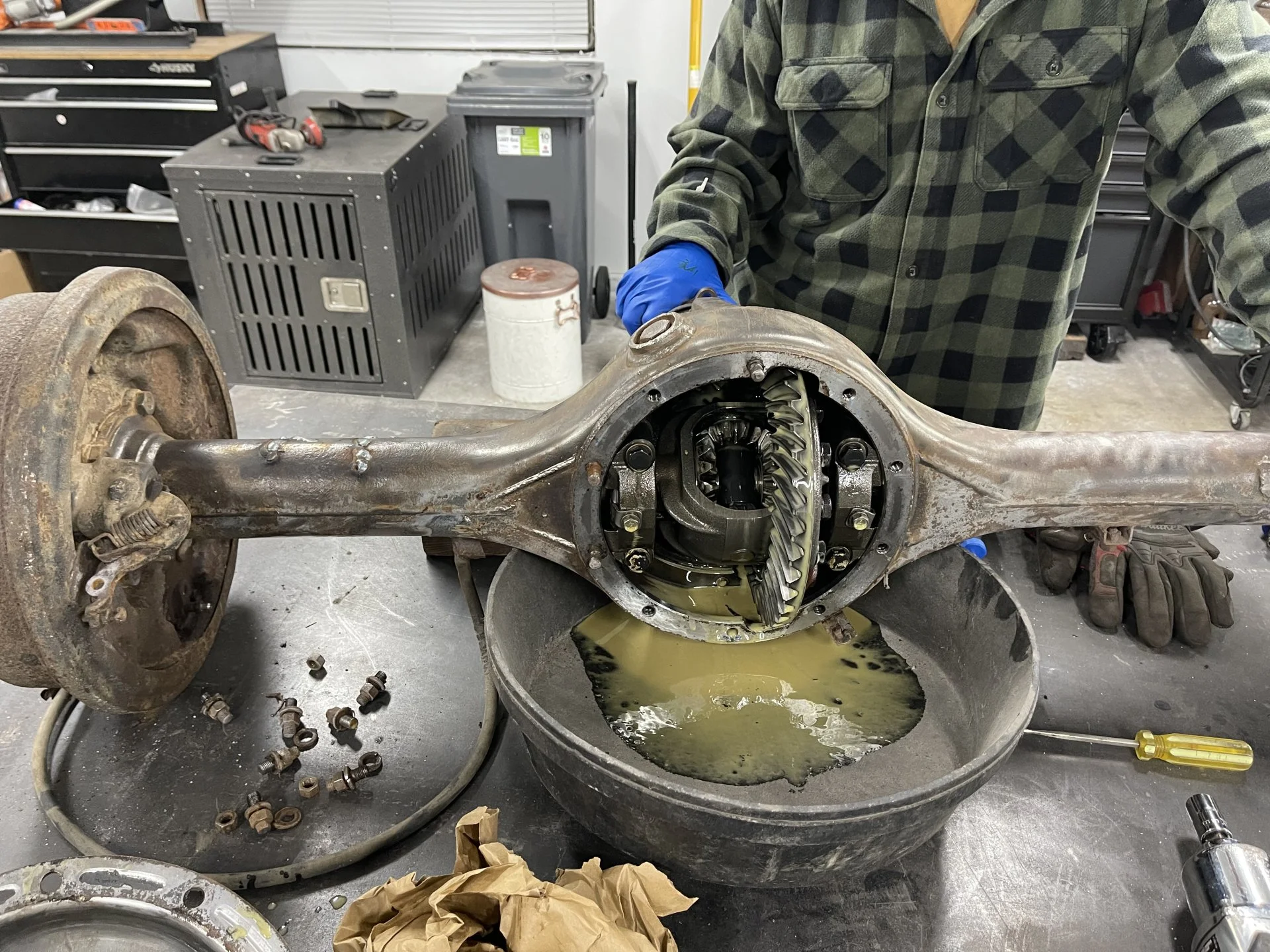

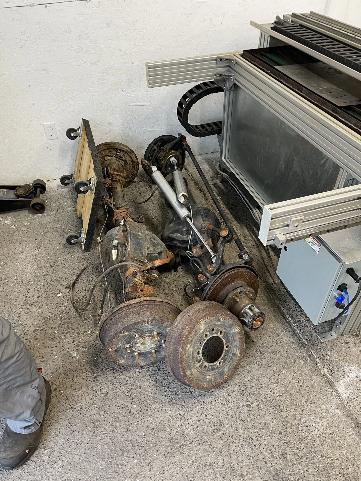

I recently picked up a set of what we’re supposed to be BJ60 axles with 4.11 gears, a lunchbox in the front and spool in the back. Unfortunately I ordered them off of a Facebook ad and had them delivered, without ever physically seeing them. I’ve now pulled them apart only to find that they are both 3.7 gearing and both are open. I looked for indication to prove that they are at least 60 series axles but the info I’ve found to date is inconclusive. The Center section of the front is stamped 41111-60. Hoping to put them under my 77’ 40 but now don’t know how to proceed. Any ideas?
my guess is 60 series axles, but a wms to wms measurement will prove what they are
that is some homemade high steer going on

I tried and got a sorry message but apparently the seller has no money. At this point I don't want to throw good time after bad. I'm planning to order gears and lockers but just want to ensure I'm getting the right parts. I believe ARB makes a locker specifically for a 9.5" SF rear that works with the c clips.
60 series axles are wider. Measure them and compare.

3.70 is 1/79-up FJ40 and 81-87 FJ60. The lockouts are from a 60.
