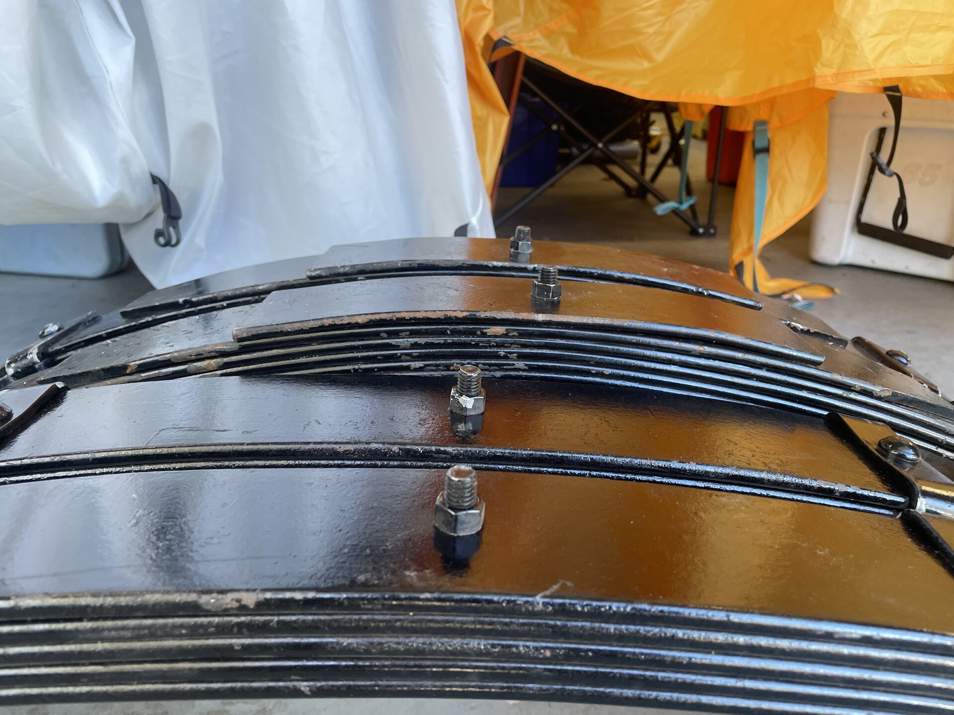

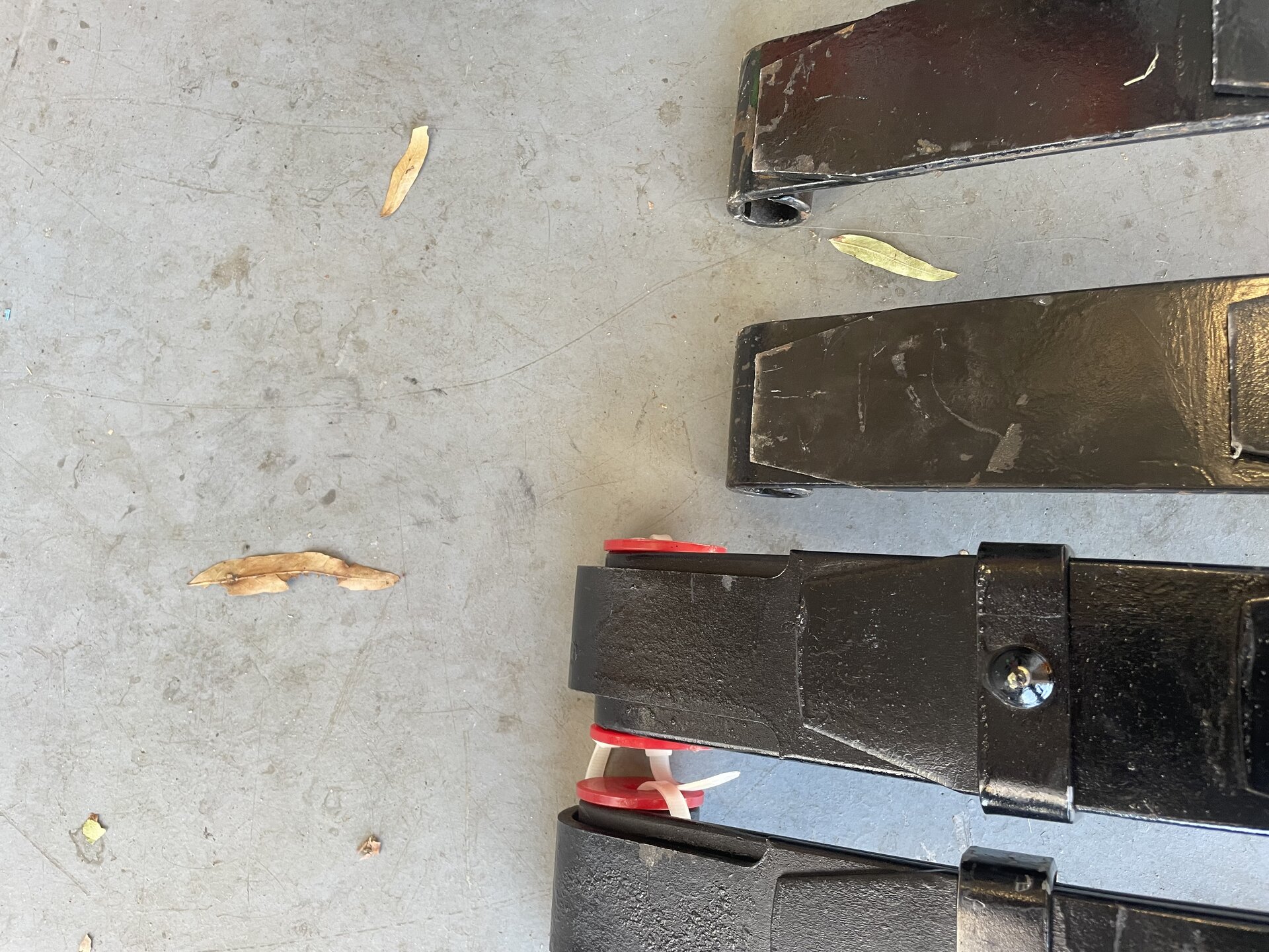

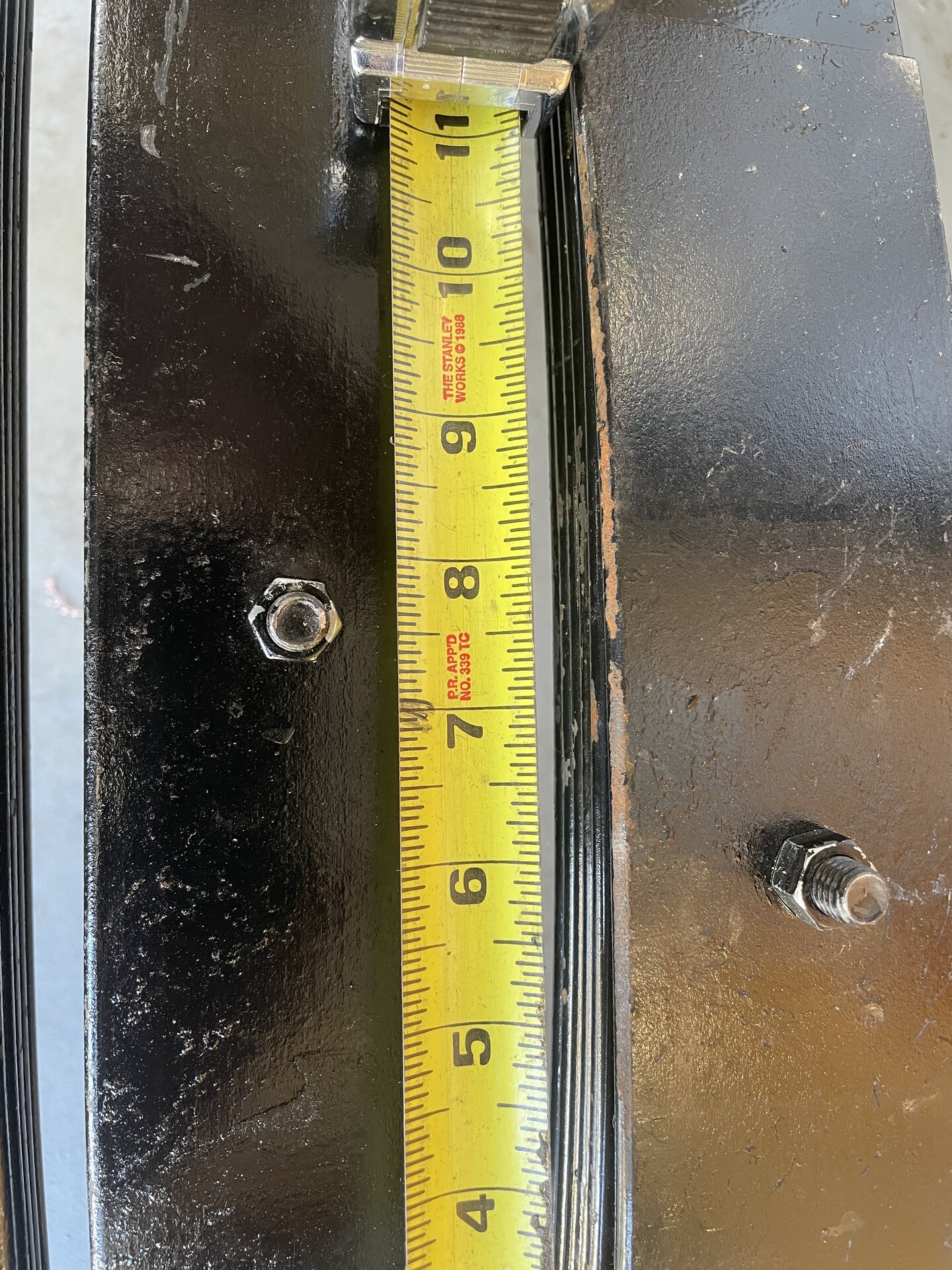

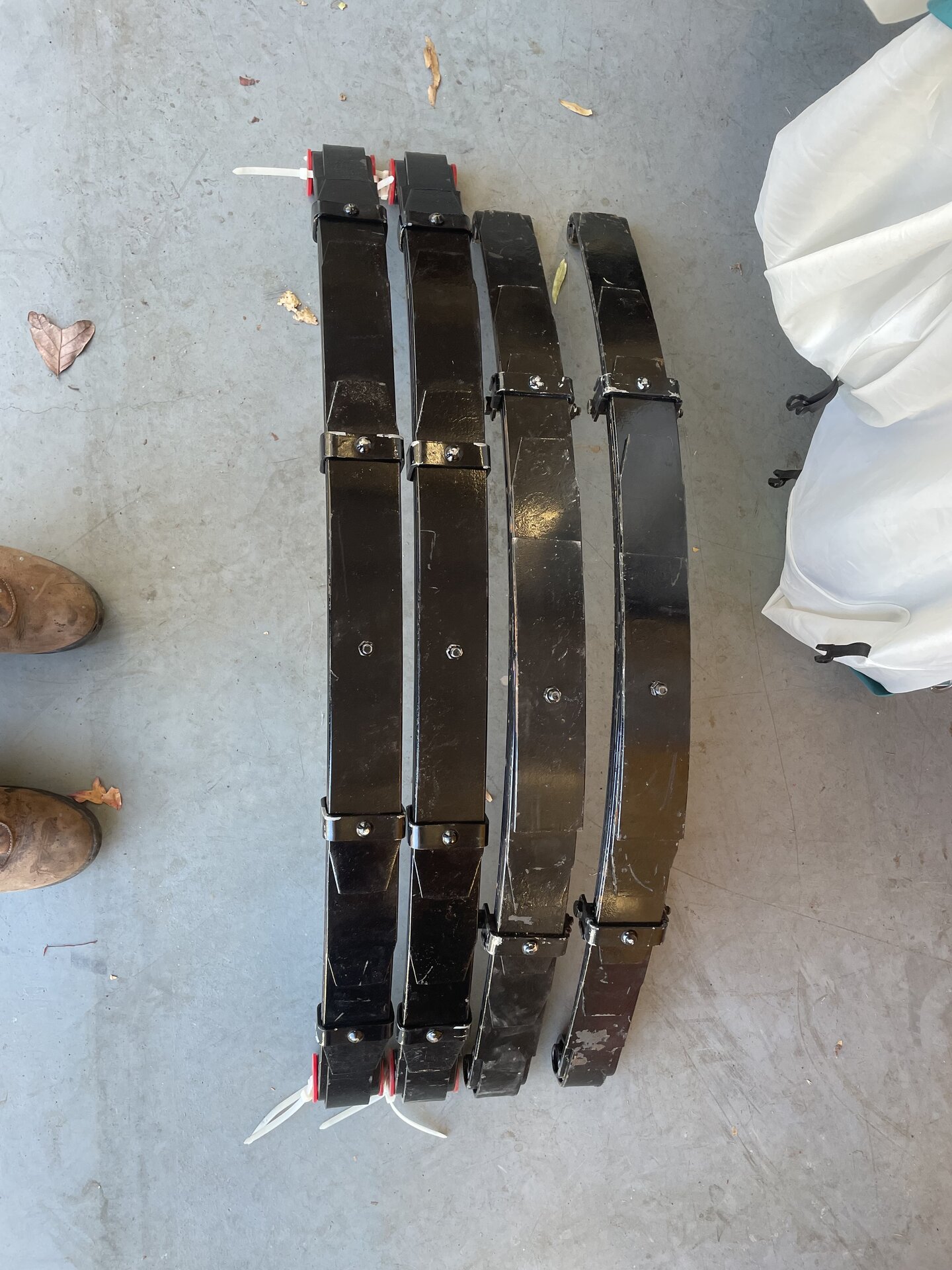

My new springs came in for the rear of Lynchburg Lemonade. Pro comp 2.5". Compared to the Dobinsons, they are longer and move the rear axle back. More like my clapped out Rancho's. Hope to smooth out those bumpity bumpity trails.

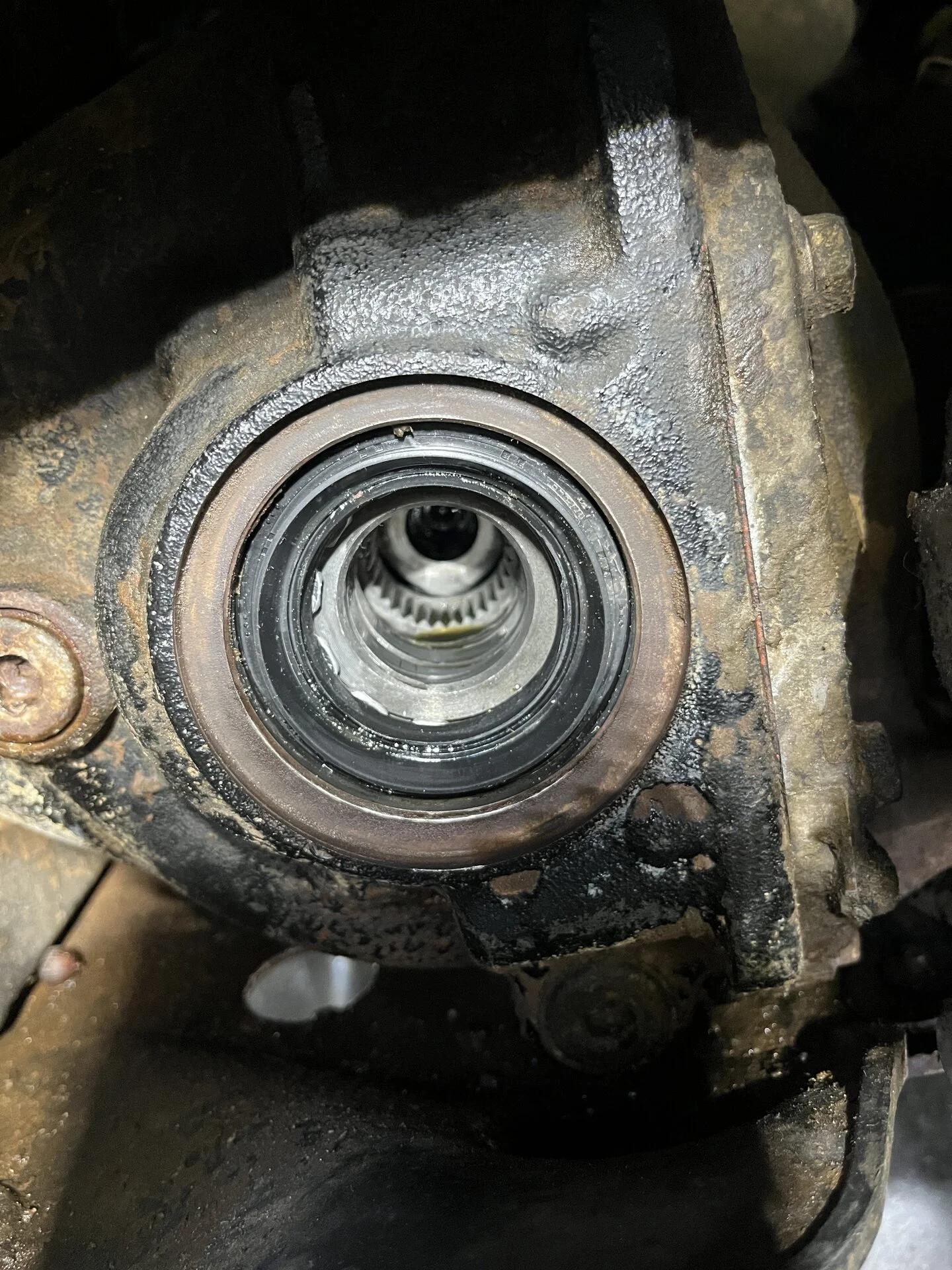

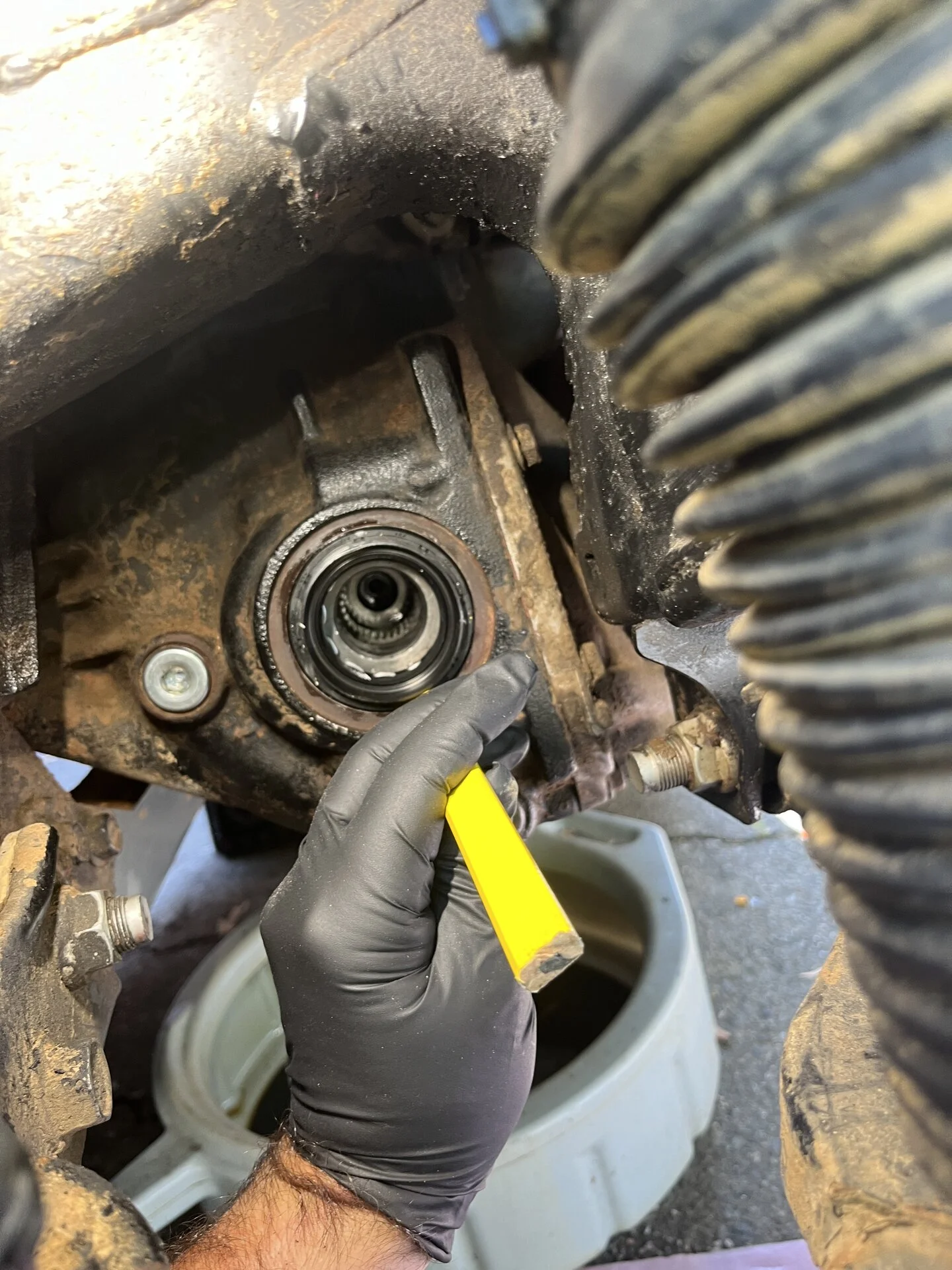

PS drive axle seal started puking diff oil. I blame it on Ed seeing that's the last place I was before it happened :flipoff2: also when I pulled the seal it was filled with grease on the back side facing the diff. Weird....
pic for affect
Also, just because the parts store says it has the correct part in stock, bring your old part and size it up.
Glad you got it sorted. How did you make sure you got it in far enough but not too deep??
Will be installing this afternoon. To answer your question though I plan to use a piece of hardwood long enough to clear the A-arm and use the lip as a guide. When its flush with the edge the wood should "bottom" out. Small taps in a circular motion like when I am installing races and other hub seals. At least in theory it works....

Got the seal in. Carpenter pencil FTW! The piece of hardwood I was going to use was just ever so too big.

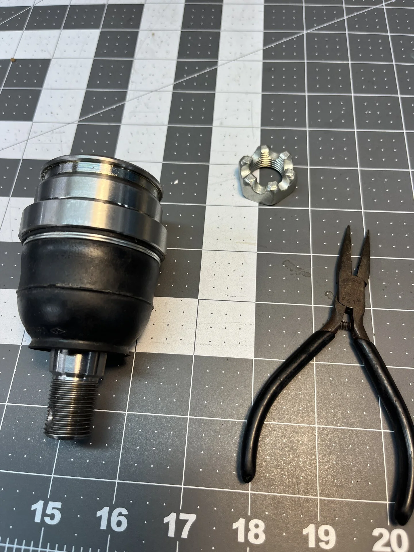

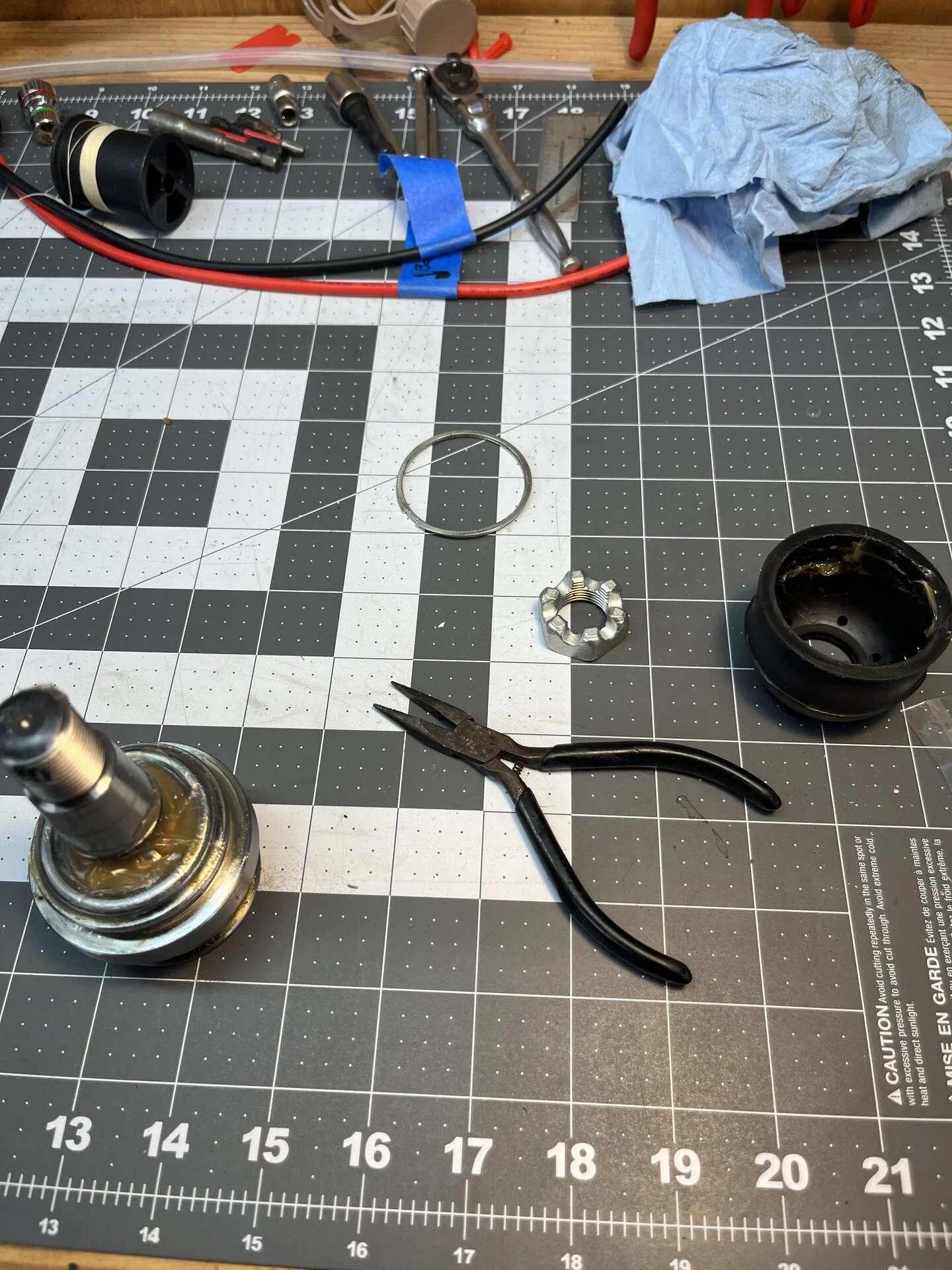

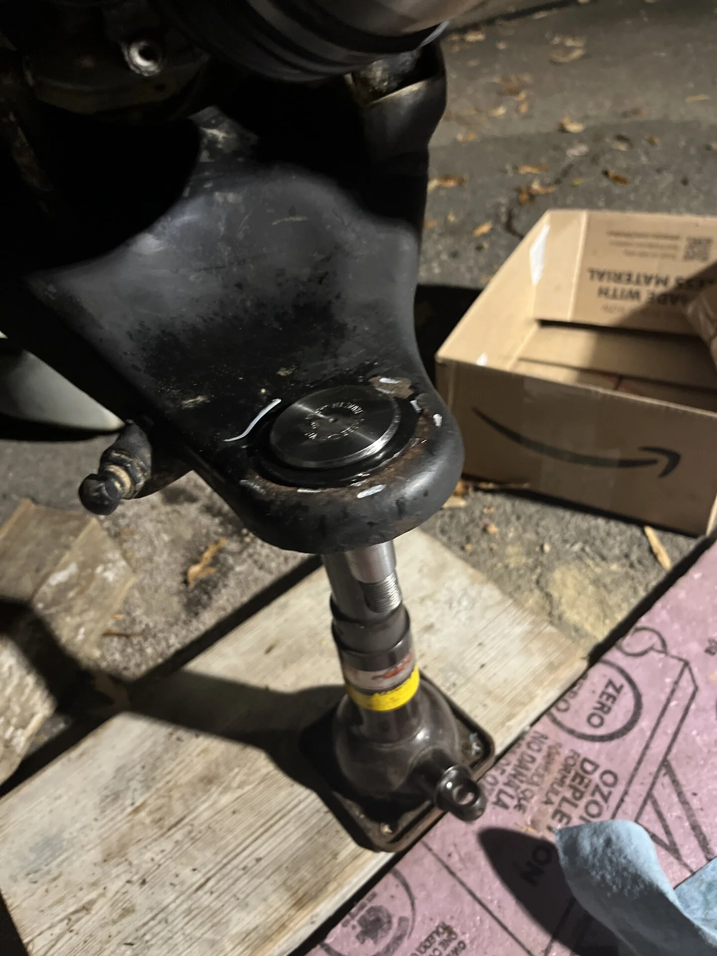

As I was putting the knuckle back on the LBJ stud was spinning and would not allow me to tighten the castle nut. Good for me I had a LBJ on the shelf. Bad for me the ball joint tool set I ordered a month ago had not arrive. So off to the parts store to rent one. Yep those kits suck and would not work. Thanks @captainva for the loaner set.
