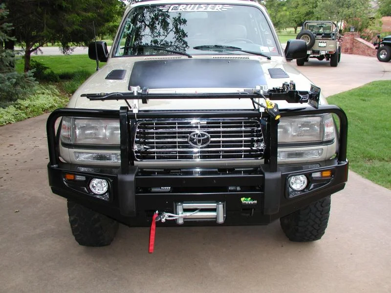

Grill and emblem painting done.
First we used the green scotchbrite material to lightly scratch the chrome finishes. Then applied a self etching primer, paint and then clear. Grill was done with Rustoleum graphite wheel paint. Emblem was shot with PPG dune beige.

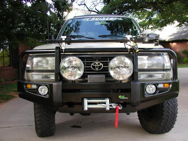

Now for installing the Lightforce 240 Blitz and winch solenoid box.

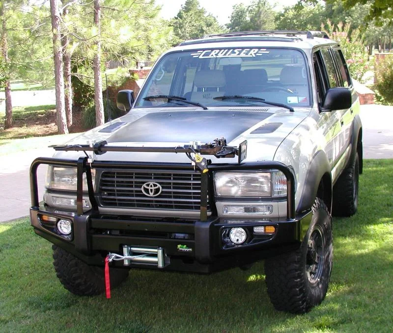

Lights and winch wired up. Sprayed truckbed coating on the winch solenoid box to help with the UV rays. Installed a 1 1/2" piece of square tube to raise the lights up. Also we drilled new holes in the Ironman bumper just back and to the outside of the original holes to reset the lights back and further to the outside. Ran the wiring through the original mounting holes. Treated the drilled holes with POR 15 and all is good to go.

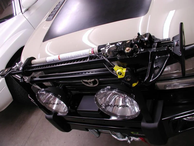

Thanks for that site. Did you purchase the jack there as well and did it come all black or did you paint it?
I bought the 48" jack here: Hi-Lift Jack Part HL-484 - 48" Jack
I also picked up the jack isolator and mounts there as well.
The 48" jack originally comes black with a red handle. I taped off the warning label, painted it Dune beige and left the black alone.
Here's another angle:
