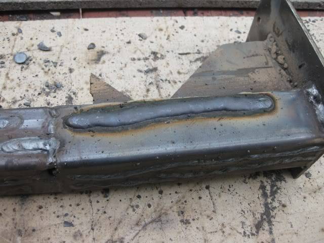

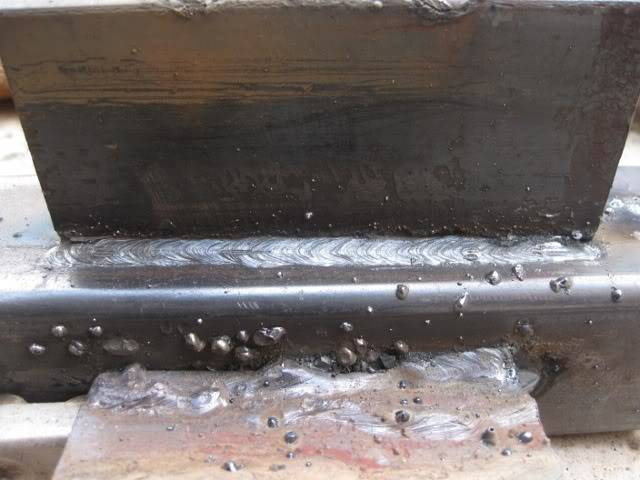

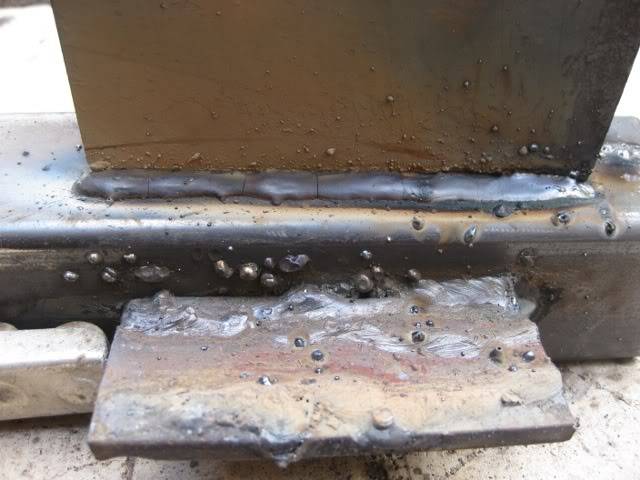

Here are some pics from today. Not great, but I've experienced that little Aha! moment, where the slag finally was flat as it should be. My biggest improvement came when I set my left elbow down and used my left hand to steady the end of the long electrode on the piece. I also jammed the rod against the surface (while maintaining 15-20 deg off vertical). I am slowly learning that I can gently raise the ark just slightly above the surface to make it glow nicely:
I'm still crooked and all over the place but at least I know what to look for now:
Not great, I know, but at least it's better than the last 4 days, believe me... :D
Looking much better. The travel may be a little fast, so try slowing down a bit. It also looks like there is a little under cut on the vertical side, so pay attention to the top of the puddle too. Try scribing a soap stone line parallel to the weld. It is easier to see, so it helps keep your bead straight.
I see what you mean about the undercut - yep. I creates a weak point. This was the very first 'clean' run where I jammed the electrode in the groove and just dragged it there - hence the undercut. The speed is still a factor - the pics show still fast travel - I know... but I've made a lot of holes too when I went much slower, so somehow I have to find a happy medium.
I was also going to comment on the under cut. Thats at the top where the bead meets the base metal, at the last few inches of your weld, its not flush right there, there wasnt total fusion. I had a ton of issues with this learning to weld a cert plate in the 2g, or horizontal position. If you slow down and watch that top side you will see the base metal flow down into the puddle and become one. It will be nice and smooth instead of having an overhang. That undercut is where your weld will break. When i first saw that base metal become molten and flow into the puddle, i was like. ahhhh, Sweet! Keep practicing, you'll get it!
sorry for explaining what you already know, i must have been typing at the same time you were.
If you are burning through the 1/8, concentrate the arc on the thicker piece and then "wash" the puddle on to the thinner part with a slight weave. Looks good though and it isn't likely to break. Test it by bending it over just to make sure that it bends without breaking the weld. If you don't test, you don't know it is good. Once you have tested enough good ones, chances are the next one will be good and you will know when it isn't.
