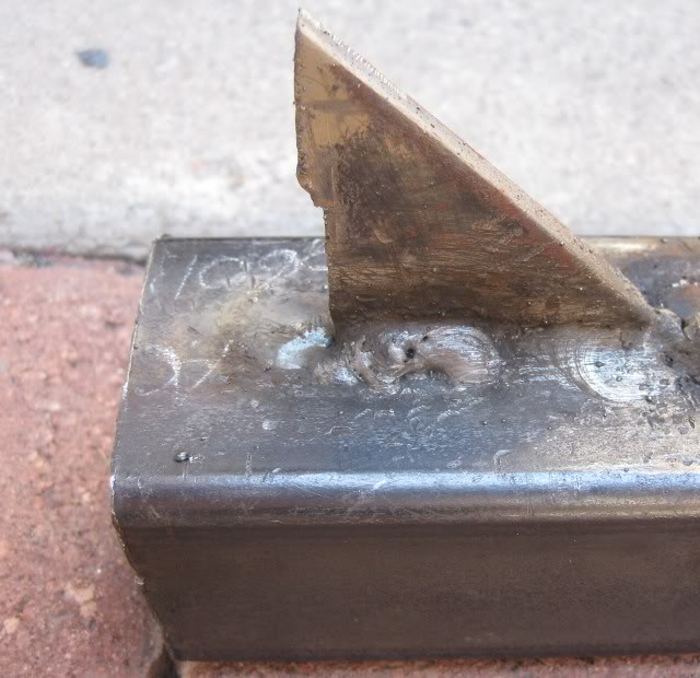

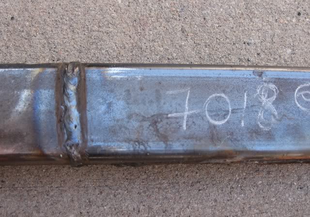

Here are some phots - again, they aren't great welds, but believe me they are much better than the fist set (which I dare not photograph):
Here is the quare tube done with 7018 and about 105A DC:

Here is one I did with the 6013 AC (after having a horrible time with DC). It's not a great bead overall because I think I missed the first time and went over it the second time, but I can't help but be happy about the right side of it - still not sure how I was able to finish that bead off so smoothly - was never able to repeat that:
Pin_Head - I have to say that once I switched to AC for 6013 electrode I saw significant improvement in the results. If I had to pick one electrode right now, I would have to pic the 6013 and put the selector on AC - at least for what I'm doing now.
Still don't know how to finish the beads off properly so I don't end up with a hole at the end. Any tips or constructive critique of the above would be welcome.
I was taught to whip the rod back into the pool in the direction of the weld when your finished then pull off, Quickly.
It looks like the holes in the weld could be caused by foreign mater, like slag, in the weld that prevents the weld from flowing there.

I was taught to whip the rod back into the pool in the direction of the weld...
Having trouble visualizing how this would work... got any more on that?
try to watch the puddle and not the bright light.pause at the end of weld and then pull off.it is very important to relax wile welding,practice is the best way to improve your skills we all started out like you.ive been welding 25 years and some days i just have to walk away and come back later .
Today was frustrating... I've put together a new fresh assembly and got ready. I tried 7018 first, then 6011, then 6013 - I tried various settings with them (AC, DC+, DC-) and various amp levels and they all looked like sh&t.... I feel like I'm not improving at all - even with all the good tips I'm getting - I got frustrated and walked away (mad). :bang:
dont be frustrated or mad.just walk away for awhile.hey i bet you learned that 6011 and 7018 dont work so well on ac do they,6013is made for ac 6011 and 7018 are not. post photos of all your welds in question ie crappy looking,maybe someone who had welds that look like yours will see them and tell you how they got better.everyone is different on how they learn,but with pics we can get an idea of what you r doing or not doing.just practice and relax try to lean on something or prop your arm some how,maybe hold stinger with one hand and rest eletrode on other.if your body is stiff youll weld like crap everytime.when you walkaway maybe watch some viedos on welding. try weldingtipsandtricks.com this guy has good pointers on all types of welding.just dont give up practice!
