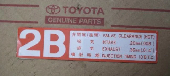

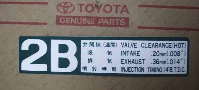

I have a march/april 1981 BJ44V with the stock 2B engine in it, doing a resto and stumbled upon the engine valve cover decals for the 2B engine @ cruiserparts.net
I found out that they offer 2 versions: there is a orange version and a green version, they are the same except for the timing info.
what version do I need? how can I find out?

green 2B decal
2B Valve Clearance Sticker Green [11293-57030-G] - $12.99 : CruiserParts.net, Toyota Landcruiser Parts
orange 2B decal
2B Valve Clearance Sticker Orange [11293-57030-O] - $12.99 : CruiserParts.net, Toyota Landcruiser Parts
one has the same info as the B engine, the other as the 3B engine...
since mine is pretty close to the 3B introduction date, I guess I need the one with the same timing settings as the 3B?

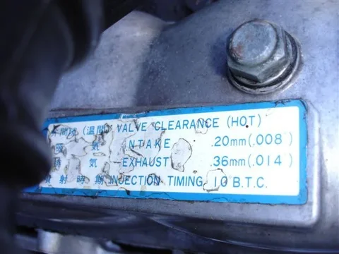

Here's mine for a 1979 B engine:

I had trouble downloading those images before but they worked OK today:
I would guess the 2B decal that match the B series clearances is what you need.If you had the engine like mine with all of the 3B series stuff, you would use the 3b clearance info...
Looks like the clearances are the same but it is just the injection timing that is different Craig

Interestingly ToyoDIY lists just the part number and price for the sticker without giving an orange/green option. (I was wondering if these Cruiserparts stickers were reproductions ... but their images certainly imply "genuine Toyota".)
Edit: We've since discovered they sell both "genuine Toyota" and "reproductions" (with the reproductions aimed at being perfect reproductions of originals."

IIRC the decal of the 3B said 14 BTDC
but when i look at the other decals on the cruisercorps.net site they also have 2 different B engine versions, also with 10 and 14 btdc... a black and a blue one
how confusing, this completely ruins the idea that newer engines had 14 and older 10 btdc.... or... :confused:
