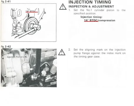

The August 1980 B-series Engine Repair Manual (pub # 36047) applies to August 1980 production models of BJ40, 42, 43, 45, 46 and 60 cruisers and it clearly states 14 degrees:

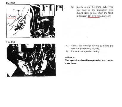

While the 1977 B/2B Engine Repair Manual (pub # 98260) clearly states 10 degrees:

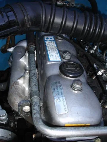

But I can narrow it down further because my July 1979 BJ40 left the factory with a sticker on its valve cover saying 10 degrees BTDC:
So the change from 10 to 14 must have occurred between July 1979 and August 1980.

Actually I'd hazard a guess that the change in injection timing (10 degrees to 14 degrees) occurred EXACTLY when the 3B engine was introduced (which coincided with the publication of the new B-series engine manual ........ that is, the publication of 36047FSM to replace 98260FSM).
So my guess is that August 1980 was the introduction date for 14 degree injection timing for B and 2B engines while the 3B engine never had anything else other than 14 degree timing. (Prior to this date, I believe the B and 2B engines had 10 degree timing.)
