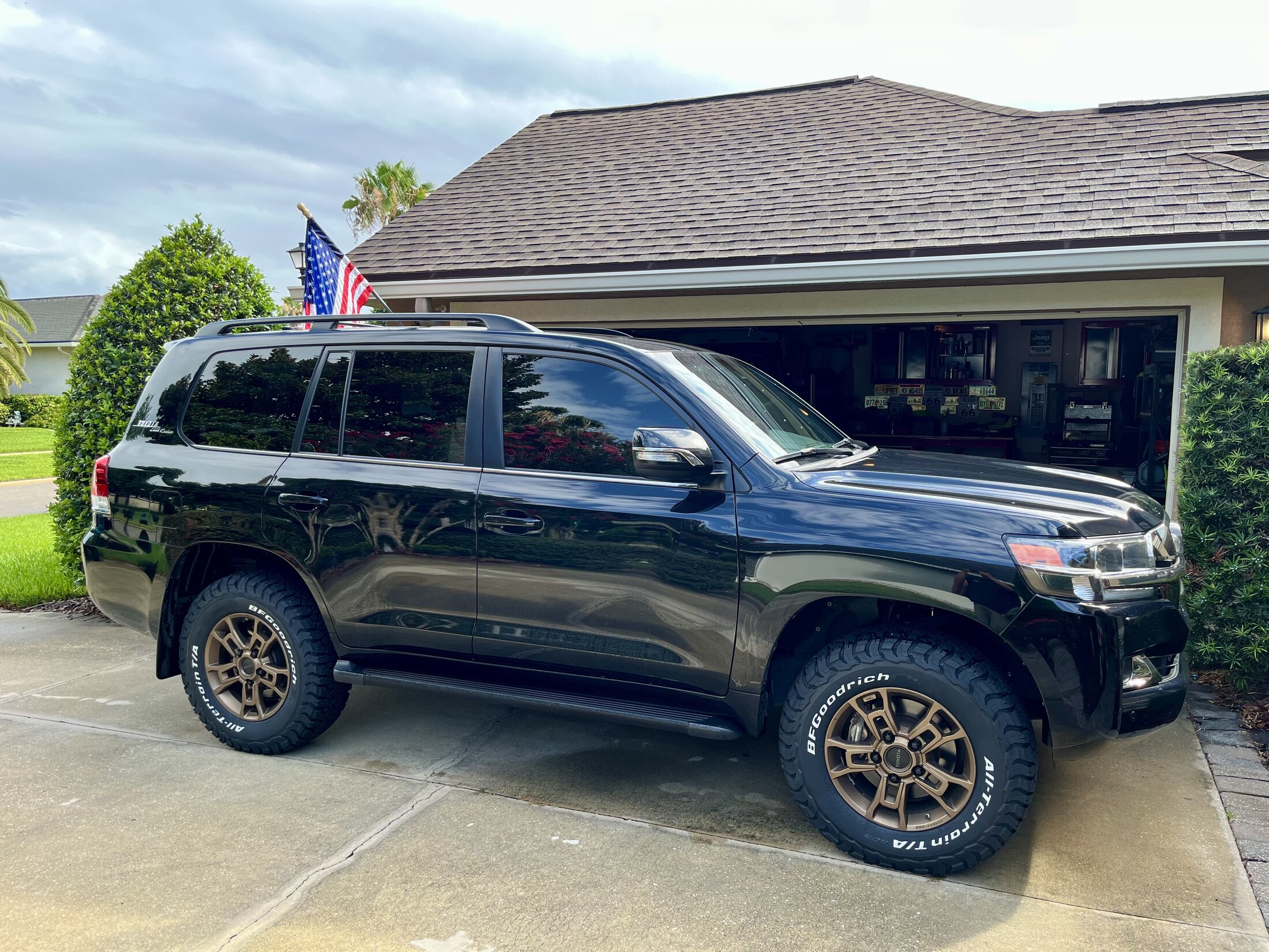

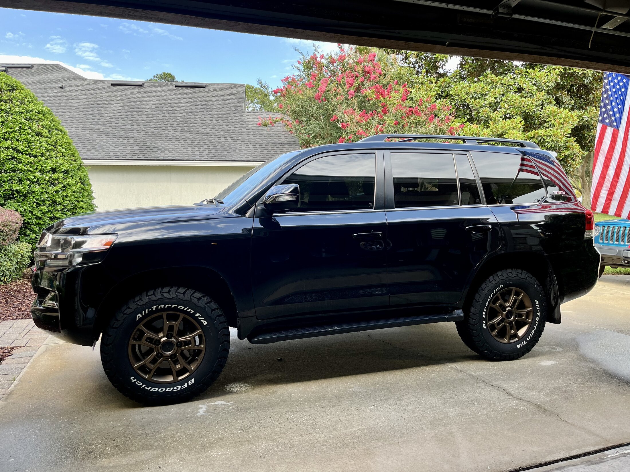

Just had this Westcott kit (Front Only) installed on my 2 row Heritage Edition, along with some BFG KO3 tires, turned out nice imho. This vehicle is only a street machine for this stage of its life, once it transitions to more of a trail rig the full suspension setup will get swapped in.
Just had this Westcott kit (Front Only) installed on my 2 row Heritage Edition, along with some BFG KO3 tires, turned out nice imho. This vehicle is only a street machine for this stage of its life, once it transitions to more of a trail rig the full suspension setup will get swapped in. View attachment 3658787
Looks fantastic. What size tires are you running?
NIce. Would you ming sharing your ground to fender measurements front and hear? Also, any additional pics? Are you still happy with the set up?
