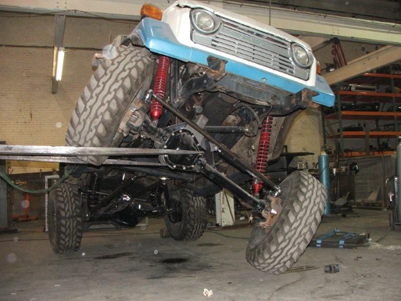

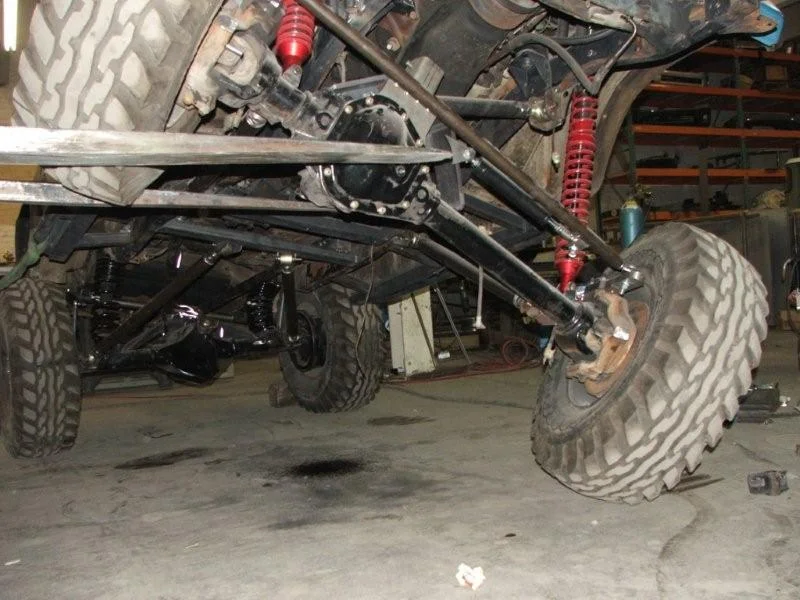

Very nice machine. More pics of the suspension. Especially the 3-LInk front. I'm trying to determine how I'm going to link my piggy. Fun stuff. What size tires you runnin?
These are just a few of the shots from the build. Cam may have more detailed shots of the front 3 link. I am sure we will test it further in Moab later this month, but so far, I am very impressed! Props to the IPOR Crew. :clap:

more details please sir:
axle specifics
steering
motor
suspension pics
Dana 70 rear w 5:29 full width & Detroit
Dana 60 front "
2 pc Humvee wheels & 36" Military OZ tires ( Now grooved :hillbilly: )
ram assist
350 TBI ~ TH400 ~ NP241 clocked & rotated + SYE kit
Swayaway Racerunner Coilover up front w/ sweet upper bridge
FZJ80 coils in back with sway bar

Maybe it is just me and the pictures are deceiving but....
attachment.php
attachment.php
That is a pretty steep pinion angle, at least it looks like in in the first picture. It also looks like it rotates the pinion up under flex, like it would on leaves. It should not do that with a linked suspension.
Just something I noticed....
Thanks for the input.
These pics were taken at the shop back in 09' when fabrication and testing were being completed. ( you probably noticed the lack of driveshafts ) The links were adjusted properly before the truck left IPOR and has been working great. No binding or other pinion angle issues.
