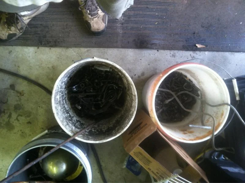

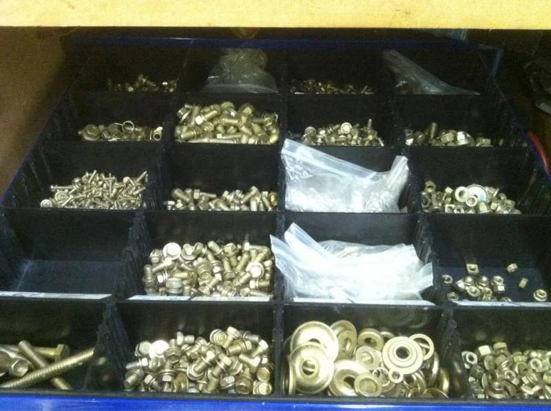

Cleaned and acid washed 3 gallons of bolts and hardware. Going out to the player to have a yellow zinc finish put on them. Should all come back looking like the bottom pic.

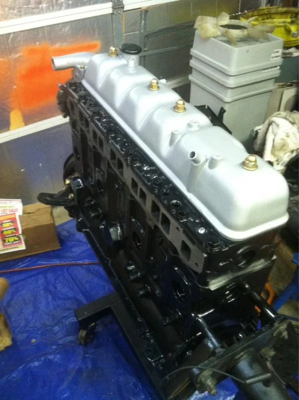

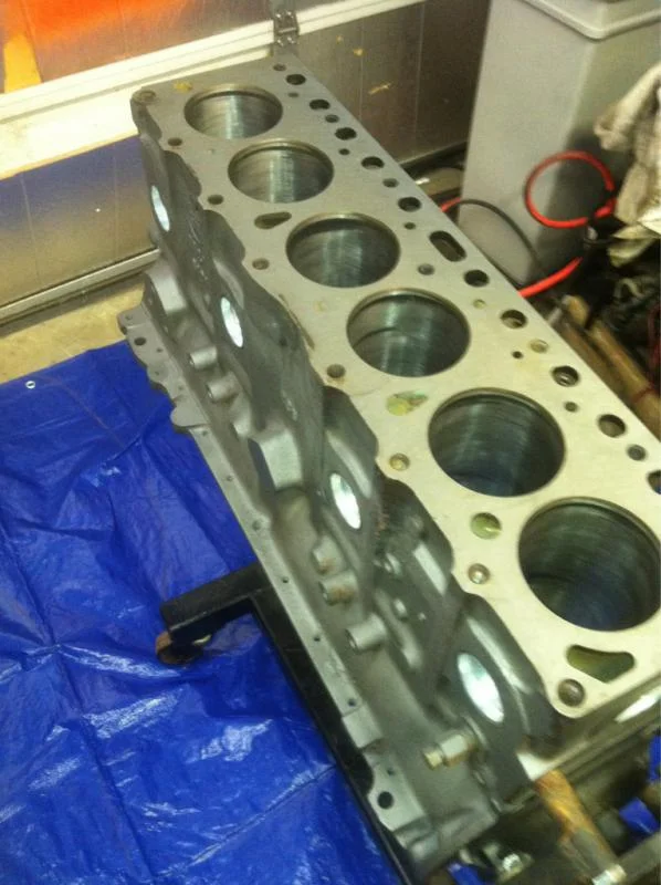

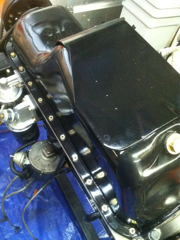

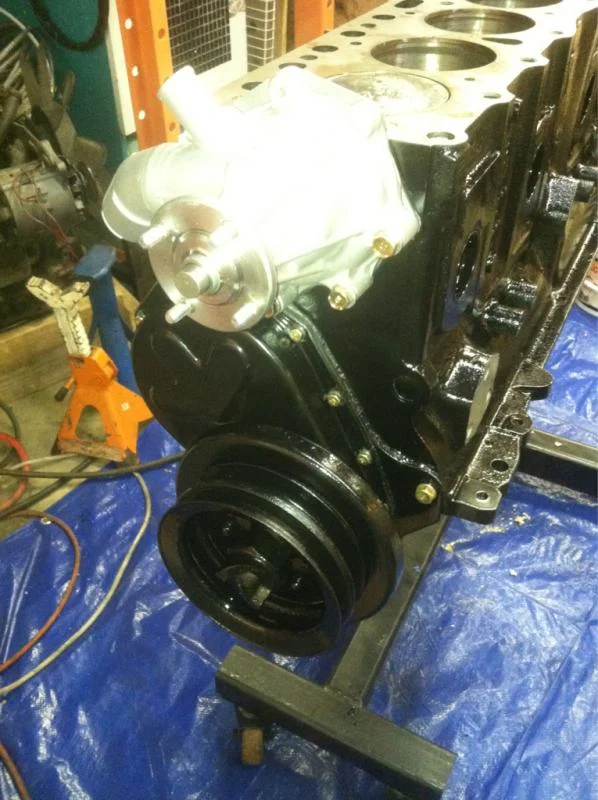

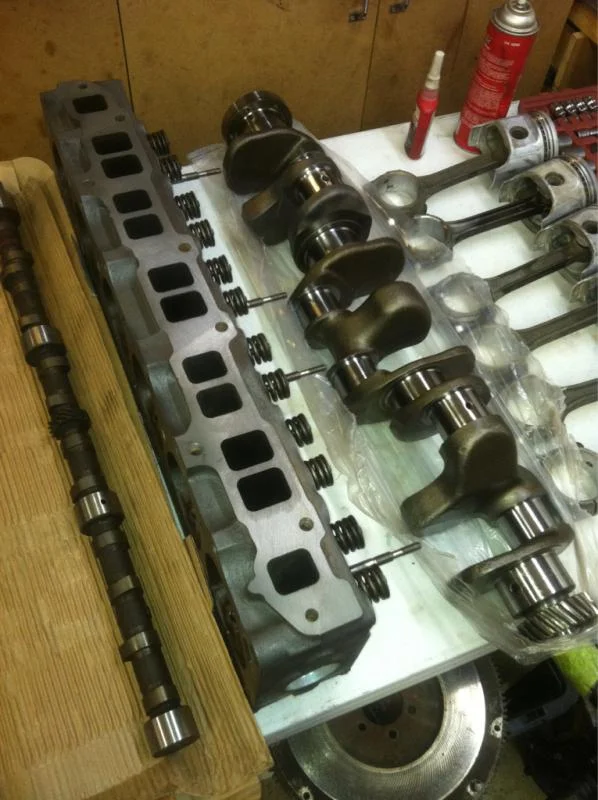

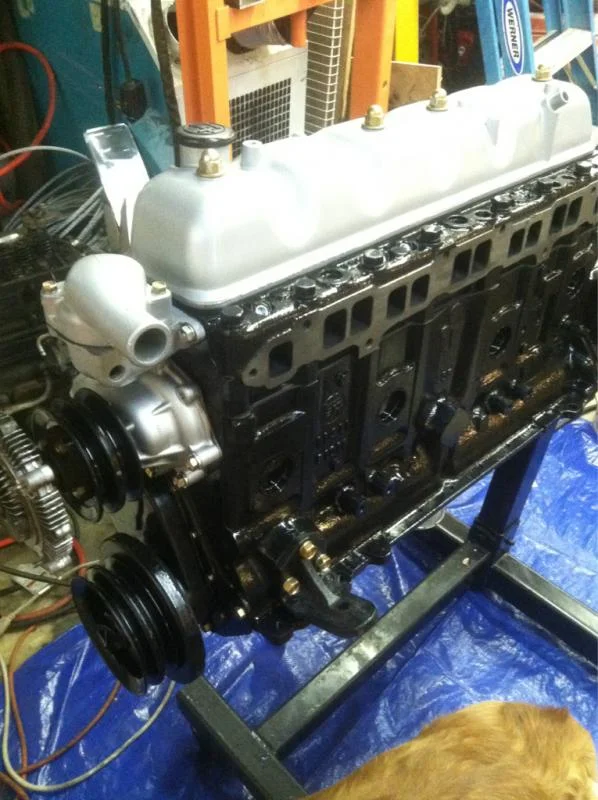

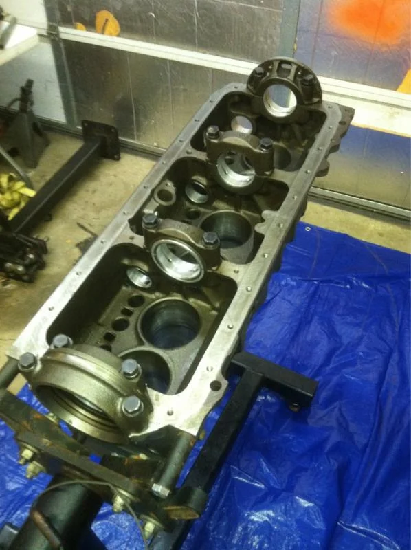

Last motor to be put together in my old shop. Balanced, decked, shaved, delta cam, connecting rods resized and balanced. block has been line bored. Ill try to keep updates flowing.

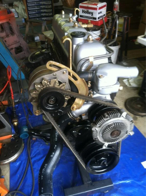

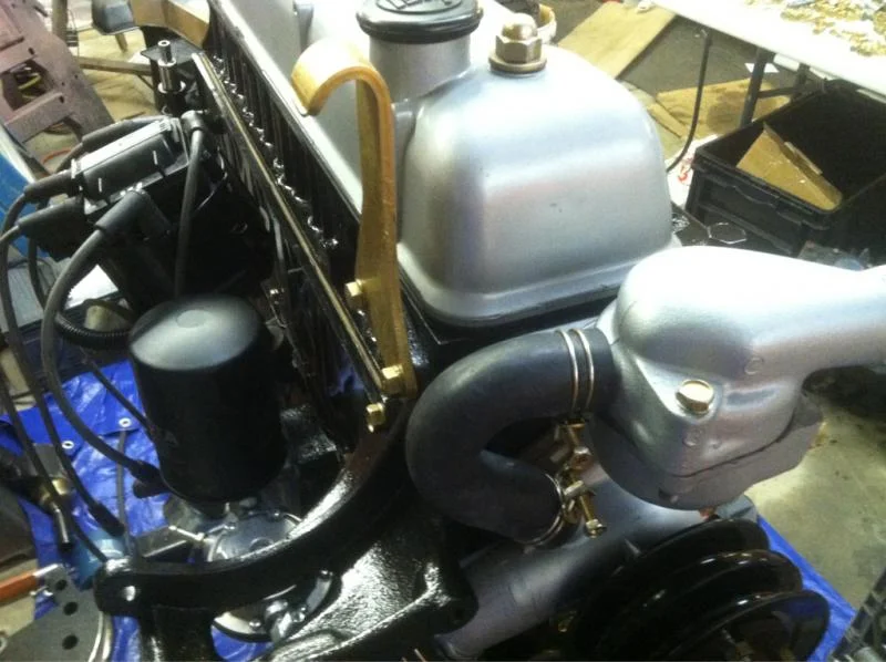

It gets better. Much better. Building this for a gentlemen that bought a cruiser for his 15 year old son as his first vehicle. Wish I had a dad that cool.
