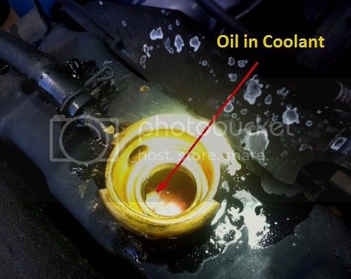

Hmmmmmm......that's not good. I continued to watch it and then noticed there was some yellowish substance floating on top of the coolant. Not a lot...but definitely noticeable. Got to be oil. Well....crapola!

First I let the engine get up to operating temp. Looked in the radiator and see what looks like oil on top of the coolant but no bubbles this time.

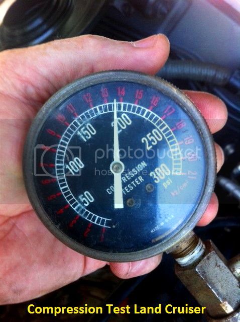

Next step: Compression test all cylinders to see just how bad this might be.
Whew.........well at least that's good news. No cylinder less than 180 psi, most 190 psi.
So looks like I need to start gathering parts and try to find a place in this one dog town to have the head serviced (probably isn't one here).
