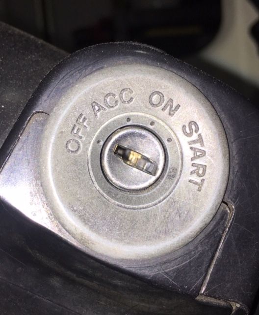

I'm familiar with what my 4 positions SHOULD be doing but I just noticed today that the engine would turn over when I had it in the ON position before I even made it to the START position. Then on a separate attempt it would not turn over until I had it fully in the START position.
If it is turning over in the ON position what is that telling you? I have a bad ignition switch or maybe the ON and START wires on the back of the ignition switch are touching causing it to start the engine in either mode?
BTW...here is my ignition switch
1911505
