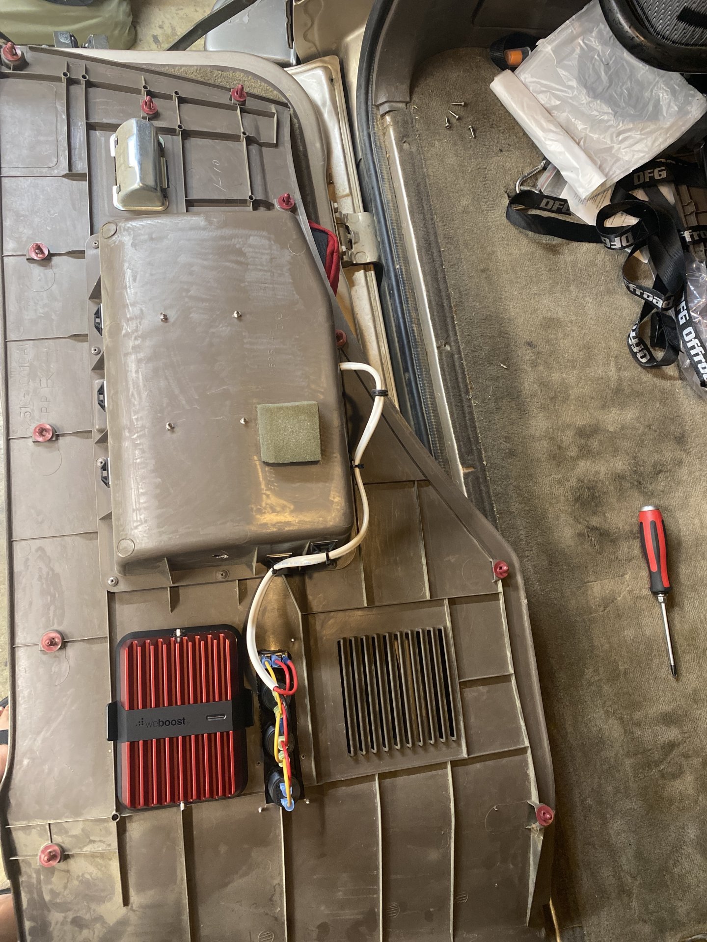

I bought a weBoost Drive Reach kit from HuddExpo. This was the Overland kit so it came with the truck mirror antenna and direct wiring kit. I picked up a Yodateq rear quarter panel mount for the antenna also.
For installation, I mounted the antenna to the mount, and ran the cable through the rear taillight, and into the wiring grommet to get into the quarter panel.
I filed a notch into the taillight, and drilled two holes along the top edge for zip ties to hold the cable in place (I know black ties would look better, I was out).
I removed the old cell phone hardware from inside the quarter panel. I reused the bracket to mount the booster. There are two hot wires inside the old loom. One is always hot when the 15 amp cell phone fuse is in place. The other is hot when the ignition is on. I used the 'ignition on' hot wire for the power to the booster. I grounded this to a clean bolt in the jack area. Both the ground and the supplied 3 amp inline fuse are accessible from the tool compartment door.
I snaked the front antenna wire under the carpet up to the center console. The antenna is mounted near the hand brake. Both antenna cables are coiled up and secured with zip ties. The power light can easily be seen reflecting off of the quarter panel metal, and can be checked by opening the tool compartment door.
Everything seems good so far. I have yet to get a real good test with it, but doing signal strength tests shows that it works.

The hardest part was figuring out where to get power from. I wanted it to stay in the rear of the truck so I had to check the old cell harness for power in multiple setups (fuse in key off, fuse in key on, fuse out key off, etc).
There was also lots of staring. Is this cable going here? Can I mount that there? There isn't a whole lot of pictures out there for 80's hence why I posted these.
Also, in order to get the spring to work on the Yodateq mount, I had to grind down the bottom nut a bit. Otherwise, it is too thick to allow it to be tightened adequately.

Bumping this bad boy for advice on installing in the passenger rear quarter. I have a power block so I’m not worried about power. Mostly looking for guidance on the mounting of the gadget. I’ll
Pull the interior antenna along the passenger side near the door jambs and behind the dash where my phone sits. External antenna will need to ride on the PS as well.
@bonestock, the only think I'd keep in mind is that the light on the top of the unit tells you if it is working or not. You may want to mount it in a way that lets you check on the light.
Since mine is in the driver side panel, I can open the jack door, and see the light reflecting off the skin of the quarter panel.
I have a @orangeboxxfab PS molle panel mounted at an @Delta VS attic bracket. I think I will mount the weboost gadget on the window side of the molle panel. My only concern is that it could get hot in the sin there but the whole thing is basically one giant heat sync so we will see.
I did a similar install but on the passenger side. My plan is to use the Wits End 1/4 panel mount for the base of the WeBoost but until then it is sitting on the floor behind the center console.
