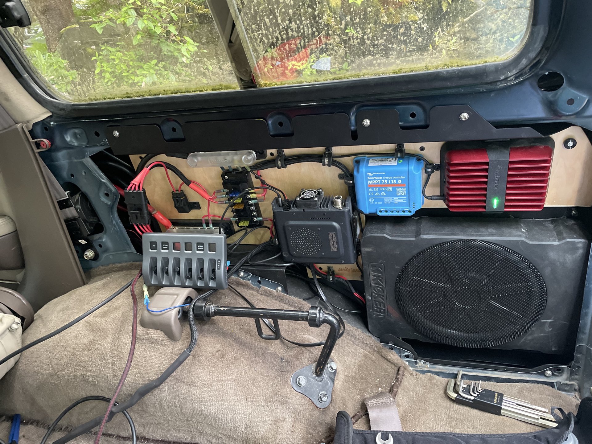

I thew a Bluesea systems switch panel in to control all the stuff in the back - weboost / HAM / Solar charger / Fridge etc.
Two things...
Do you have a picture of the panel and switches installed?
Also, what part of Portland are you from? I grew up in Boring, Oregon and lived in Gresham, Clackamas, and a few other places around there.
Ya know, I see lots of useable space on that QPM :flipoff2:
