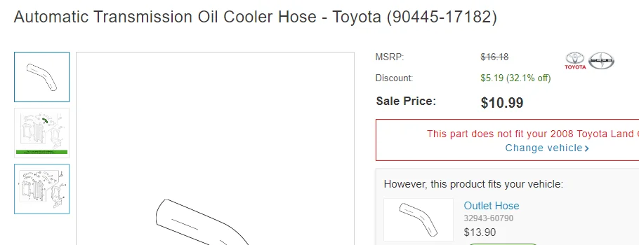

This is the hose that i'm looking for but having some trouble finding that one specifically. Not sure if they are interchangeable with the others you listed. All depends on the suffix apparently. Il keep digging and see
View attachment 3543270This is the hose that i'm looking for but having some trouble finding that one specifically. Not sure if they are interchangeable with the others you listed. All depends on the suffix apparently. Il keep digging and see
Part number 9044517182
I'm getting these results. Not the same hose on the diagram but for $14 I'll see if its interchangeable. Thanks for the help

Also, part 90445-17182 IS the correct part for the AT cooler hose that attaches to the bottom left-side of the radiator despite the Toyota parts website listing it as incorrect for a 2008 and the part thumbnail showing a different hose.
