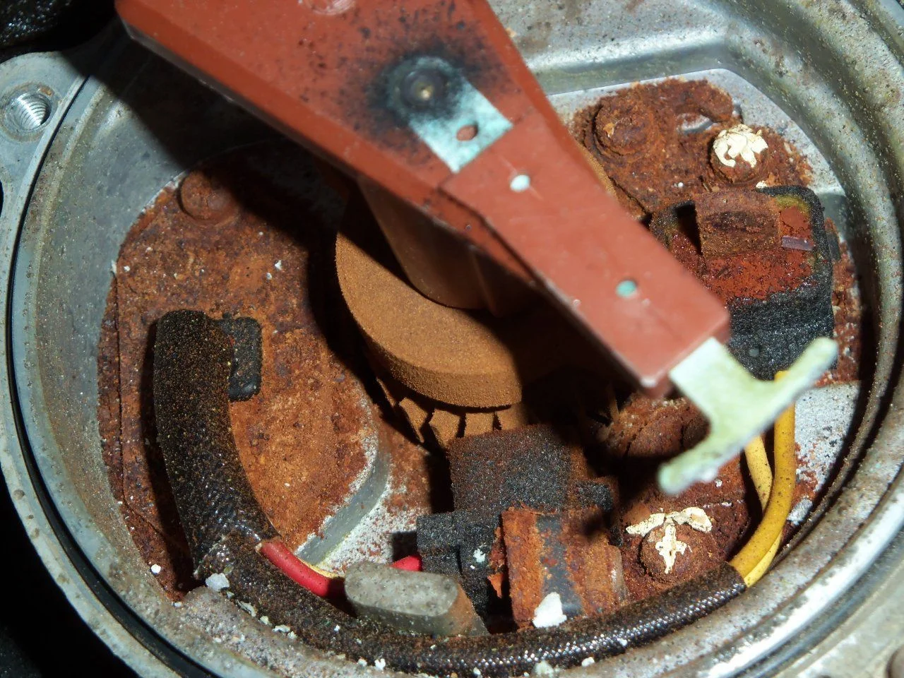

Tiny holes are on the bottom side of the distributor housing.

not the cap...

Have you changed the cap and rotor, I had a similar issue with moisture. Didn't realize the tube from the cab slipped off so a dusting of rust formed inside the cap. Had a rough acceleration until I changed cap and rotor. Make sure both vacuum lines are on your two vent Dist. Cap and the O ring is in place for you Dist. Cap.
There are 3 holes in the base. Breathers? I plugged the top most one with RTV and it keeps most of the water out and still allows air in thru the other 2 holes. So far no corrosion visible in dizzy.
Oops! I am talking about a 1 FZJ motor.
