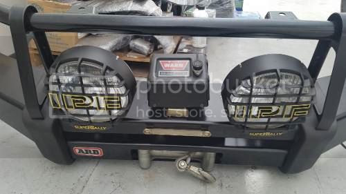

Have this exact setup. No problems with mounting, I've got the control pack sitting right on top of the winch drum.
