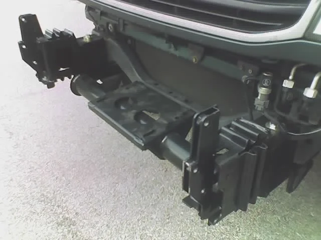

Did the ARB Deluxe bar change at some point? I have the Deluxe bar on my 01 and it has the winch mount on a separate piece that is mounted directly to the frame. Then the bumper bolts to the winch frame. It sounds like yours is different than mine. Maybe because of the difference in years? Is this also when they added those cutouts for the fog-lights like on the Sahara bars?
In this pic, you can see where the winch mounts on the "sub-frame" and then the bumper bolts to that piece.
Greg -
Yeah, yours looks stronger, but they changed the design for the `03+ Deluxe bar (not exactly sure why, as I like your winch-mount better). I will say that even though the winch now bolts to the front face of the bumper, it has lots of internal bracing, much more so than the 80 Series bar which also mounts the winch to the front face.
Also, the `03+ does have the cut-outs for the foglamps (which are very cool!).
I bet it had to do with weight. That sub-frame on my bumper is heavy!
