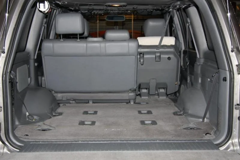

Hi,
My name is Charles Warfield. I am not yet the proud owner of a 100 but I hope to be soon. I have a tech question for you experts. I have recently got my hands on a 98 lx 470 to use for final fitting of my new 100 series drawer systems. The question I have is what if any differences are there between the 98-06 rear cargo areas? I am hoping that there is a negligible difference. I know that in the 91-97 there is almost no differences at all, and I am hoping the same is true of the 80s younger brother. Thanks for any help on this one..
For details on any of the drawer systems that WOR offers vist www.warfieldoffroad.com I do not yet have specifics up on the new 100 series system but they will come shortly. The new system will look just the same as the 80 series system.
Thanks for any help.

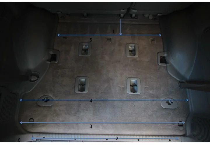

Could someone get some measurements? I need to know the width of the back area from the panel to opposite panel at about the height of the ash tray, and aprox two inches off the second row seat, and again then just before the paneling curves near the tailgate. Also I need the width from door jam to the opposite jam when the tailgate is opened.
See footnotes that tie to attached picture. These are measurements from a 2006 LC100 with A/C. The ashtray is roughly 2" behind the bottom of the seat base, but as noted below the upper part of the 2nd row seats (not reclined) sits about ~8" from the back of the anchor trim piece. Hope this helps.
1. Using an elbow square held plumb, the back of the seat comes out 7 7/8” from the edge of the 2nd row seat trim piece
2. Tail gate plastic flap / trim piece measures46 5/8”
3. Dimensions just inside plastic trim, measured over the d-rings, are 53 3/8”
4. Measures 43 1/4” just inside plastic trim
5. Measurement at ashtray depth is 42 7/8”
6. Rear opening of the 100, before trim starts to curve up, measures 52 1/16”
about a 1/3" on each side for number 4. Number 3 has about 3/4" room on the passenger side and just over 1" on the driver side.
the height of the rear edge of the second row seat, when folded down, looks to be about 10 3/4" high off the carpet, right next to the seat. however, the floor seems to hump a little bit towards the back, and from the top of that hump, the same rear edge of the folded second row seat looks to be about 10 1/4". This dimension is important for using the drawers to complete the "bed" platform.
