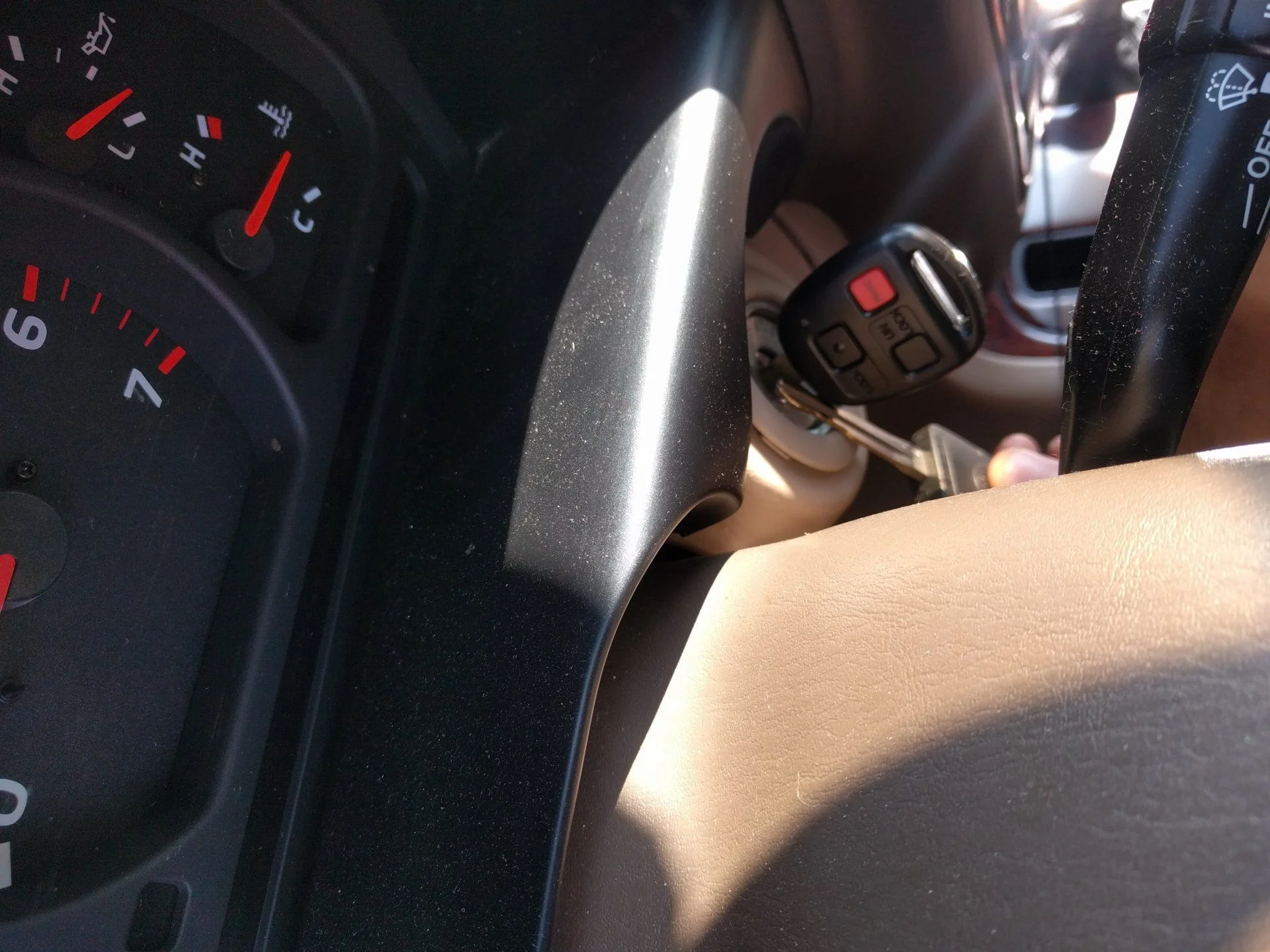

The keys were not in the same ring and the "copy" did start up the car. I just tried again today, and the only way I got it to work was by touching the "copy" with the one that works as in the picture. By itself just wouldnt :/
I still cant figure why it worked the first time on its own and not once more?

Makes sense although I dont think it's my situation and here's why: Last Thursday I went to the LC with 2 key and tried one more time the "copy" one (the original key was in the car nearby the ignition) It did not start up the car. I then made the metal of the original touch the metal of the copy(inserted in the ignition) and it did start up the car. Though it was due to physical contact not really proximity. So in light of the new information (to me) that these keys require battery for the chip to work, perhaps my "copy" key has a dead battery.... I'll check sometime today if there's a way of prying open the "copy" without breaking the case.
If anyone has already opened theirs, do these key have 2 batteries? one for the buttons and one for the transmitter? I'm asking this because the dealer gave me my original key in two parts, one that is just the buttons and one working key(no buttons)
