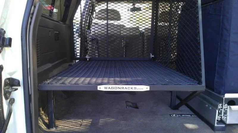

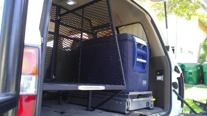

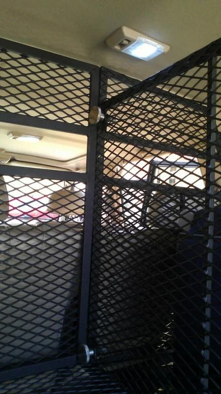

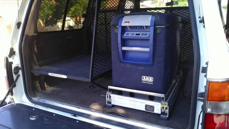

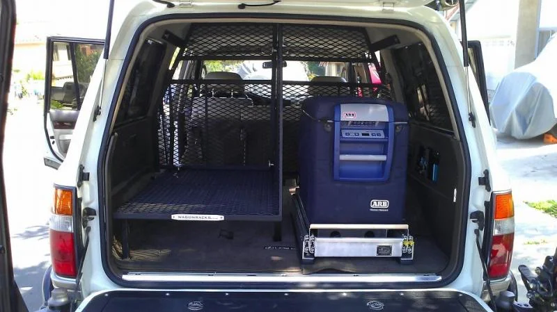

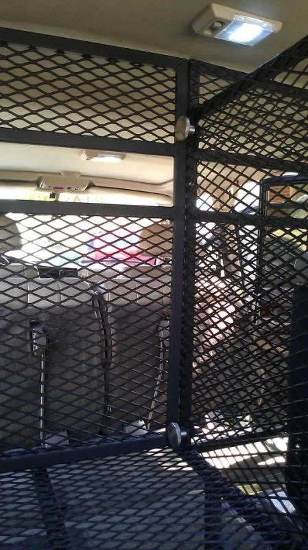

I wanted to show off a recent custom interior cargo rack I built. Customer told me in words what he was looking for, a crude drawing was written up and approved and this was the end result. Customer wanted the middle divider to house the fridge, roller drawer goes under the rack on the left hand side to handle smaller items, the stainless steel knobs are removed in 2 minutes and the left side barrier can be taken out to create a small sleeping platform with the 2nd row seat folded down. Customer has a RTT but wanted a 2nd option in case weather was severe. I also created a block off plate for the middle section on the barrier so the rear cargo area can be completely secured when leaving the car or if he is going to be putting it on a boat during his travels around the world.
