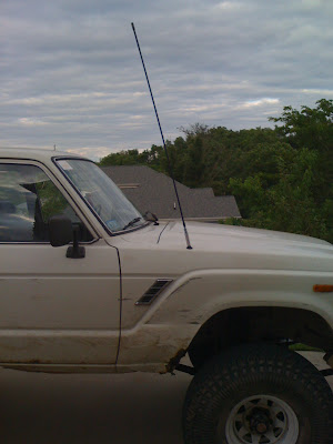

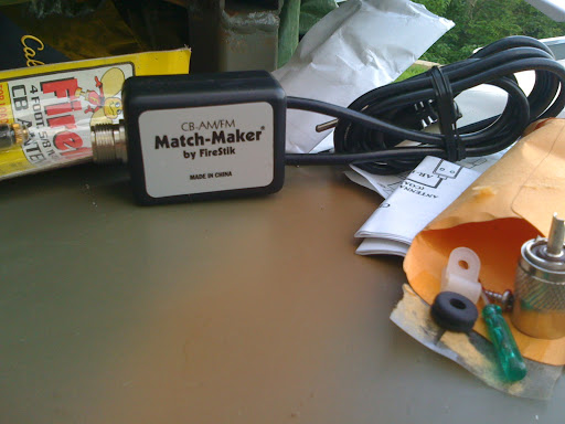

As we all do, I broke off my stock manual adjust antenna on a tree at some point. For a long time I was looking for a way to set up my radio and CB, which, at the time, I thought was only possible with 2 antennas. Well Kevin Rowland told me different. He has a slick firestick setup, mounted in the stock location and grommet, using a CB antenna coupled with the Matchmaker FM / CB splitter to use the same antenna for both CB and FM. I bugged him and bugged him to make me a mount to do the same. Well he designed it and here is the kit!

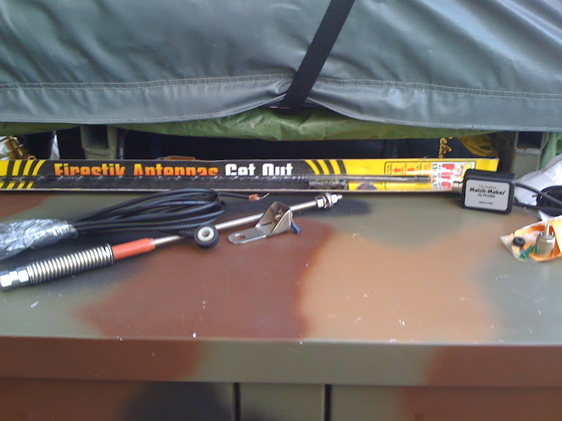

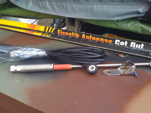

The first pics are pics of what Kevin included in my kit, which came with the antenna, mount and Matchmaker splitter. Everything is Stainless steel, so I never have to worry about it rusting.

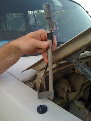

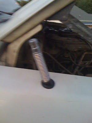

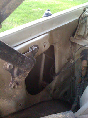

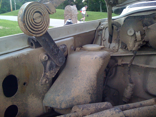

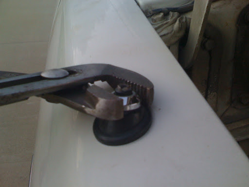

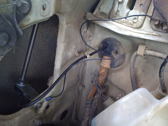

So to install it, you first have to remove the top bolt from the windshield washer resovior, and loosen the bottom two ( 10 mm bolts ). After setting that to the side next to the AC lines, you can see the stock antenna mount. It is attached at the bottom with one bolt, and then on top of the fender with a steel washer that needs to be unscrewed.

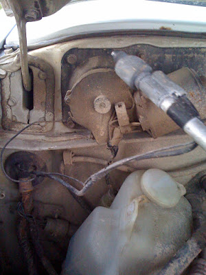

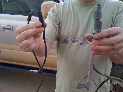

After removal of the antenna, you must unbolt the ground wire, which is connected to one of the windshield wiper motor bolts. You also need to remove the FM cable from the back of the radio and pull it through the grommet in the firewall. At this point, you are dissasembled.

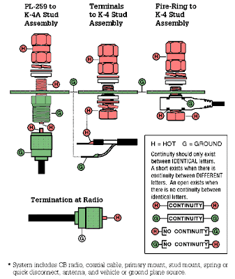

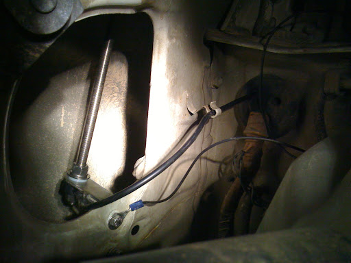

To install the antenna, first bolt the mount you got from Kevin into the stock bolt hole using the supplied bolt, so that the flat portion of the mount is facing the top of the fender as pictured. Next, put the threaded rod down through the stock grommet and mount. Assemble the washers and Fire Ring as pictured.
Finally, clip the ground cable off of the stock antenna ( if not being sold or reused ) and run this cable from the mount's bolt to the original ground wire location. Screw the antenna onto the spring on top of the mount, and the antenna installation is done!

One thing I recommend is NOT pulling the radio antenna out if you can help it, but disconnecting it at the antenna then taping the new cable to it and pulling the whole thing through the grommet and up to the radio. That saves having to snake the cable around.

Good point on the radio cable. I had my dash apart so it was easy to get to. Had no problems.

Longer, higher quality fixed antenna with a good ground will always increase your range. I can't comment on how well the matchmaker works because mine appears to be defective. I tuned my CB setup to a SWR on all channels of 1.9, but when I hook up the matchmaker, my SWR meter reads a short. I will pick up another unit when I get back from CMCC.
