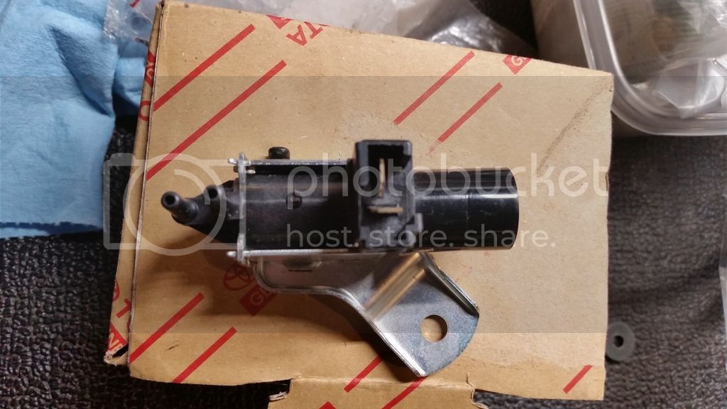

im looking for an fj60 vacuum switch valve vsv part# 89570-60060. I am having trouble locating one. Not on SOR, Cruiserparts, Cruiser yard. Amayama says to have one in japan, but site appears a little sketchy. Anyone with experience with them? or ....Recommendations where to get one?

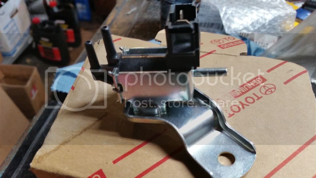

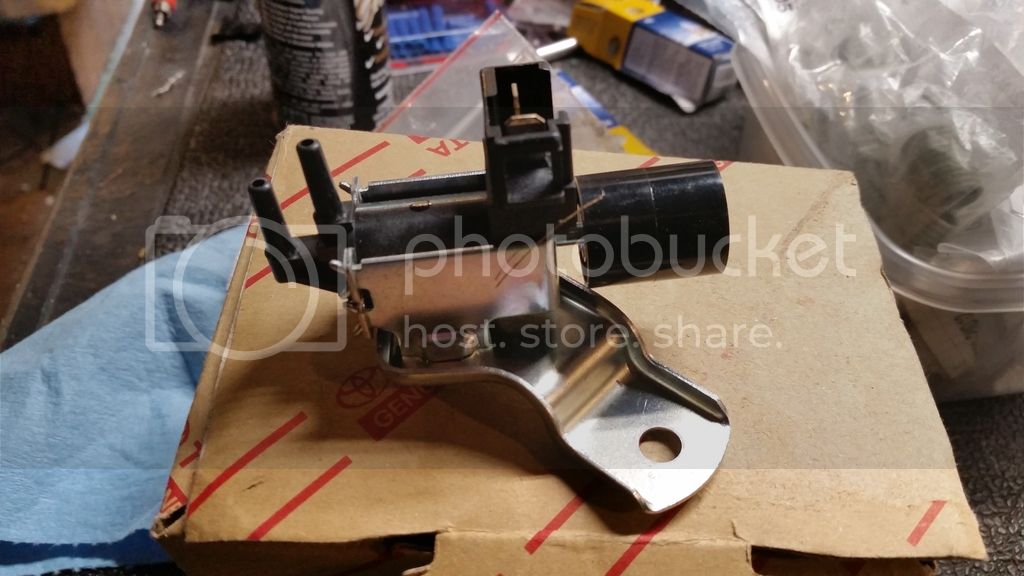

you can use another VSV from another Toyota as a substitute, might have to change a wire or connection but it will function the same, I think I have one I was going to use as a replacement, I'll see if I can find a part #
this will work, you will have to make a jumper or cut the round plug off the one thats there and wire it up. the black cap on it is just a vent/filter(to air), you can pull it off(and it has a metal pipe coming out) and hook up the other(3rd) vac line to it or if needed cap off the vent port(if only needed on application) these work for the AC idle up, fj62 vac solenoids etc, handy to just have around as a spare.....
the bracket can be removed and the bracket for the old one may fit but lots of places it will mount to and look correct.

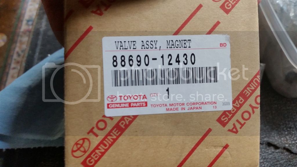

got this one just a few months ago, think it was around $30
New is discontinued from Toyota/Denso.
