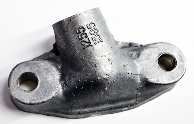

I use the part shown below. I drill and tap it to 1/8NPT. It mounts just above the oil filter.
I have it listed as GM #12551587
The part shown 12551595 may already be tapped :) I am going to order one to see. I still have 3 of the other on the shelf.
