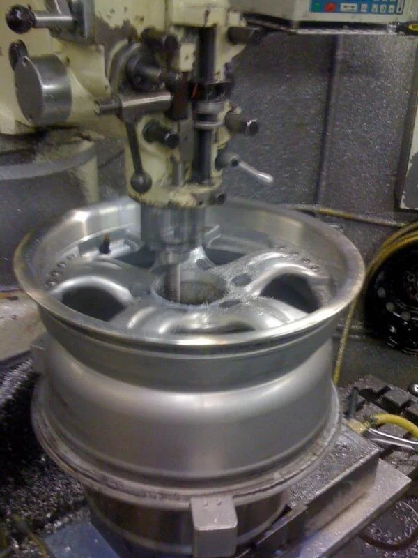

I had a set of TRD Ivan Stewart wheels from a Tundra that looked pretty sweet, so I thought I'd throw them on here.
Well, we all know that the front wheel hub won't clear most newer rims....so I had mine machined out to match the hub.
The guys at Precision Wheel & Tire in Englewood, CO did an awesome job milling out the center, and they fit like a glove!

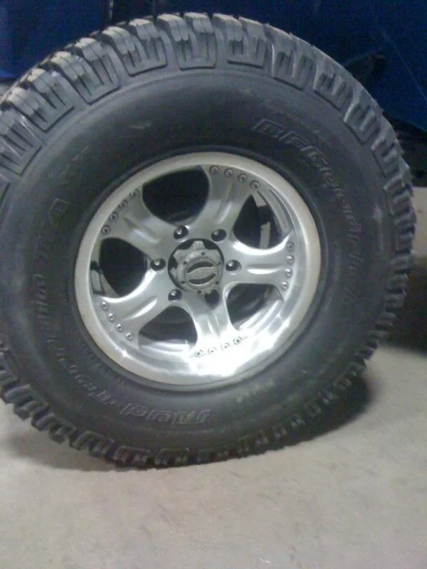

I ordered the 285/75/16 - 10ply tire, named the Guard Dog MTs, and they look fantastic - only 2 days after ordering, they arrived on my dock in Denver!
I couldn't wait to fit on the TRD rims....and man, they look sick!!! 33.5" inflated and ready to rock n roll!

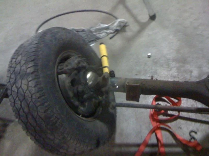

I ordered the deluxe Old Man Emu suspension for the 40 on Thursday from Man-A-Fre. They cut me a helluva deal on it, as their pricing was already a great deal - compared to what I found elsewhere on the web and thru the local vendor in Denver.
Nothing personal about not buying it locally, it just would've taken 3-4 days to get it, and I didn't wanna wait :)
I shipped it on our LAX truck from Man-A-Fre, and it arrived unscathed this morning in Denver.
TOTALLY AWESOME!! I'm totally psyched about it, as it has everything that I could possibly need for the suspension. I decided to upgrade the brakelines to the stainless ones from MAF. There is no sence in having to bleed the brake system with old rubber lines, and what better time to upgrade?
I'll post up the photos in just a second.
I'll be swapping the 76's front disk brake axle onto the Voodoo 40, but that's not until the Superbowl kick-off....since I'm not a huge Football fan, I figured I could get some work on the 40 while the family watches the game :)

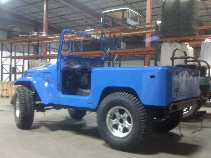

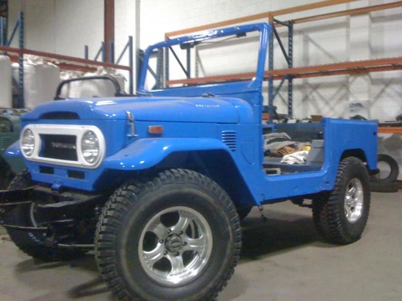

Here's a few photos from the past couple of weeks' work.

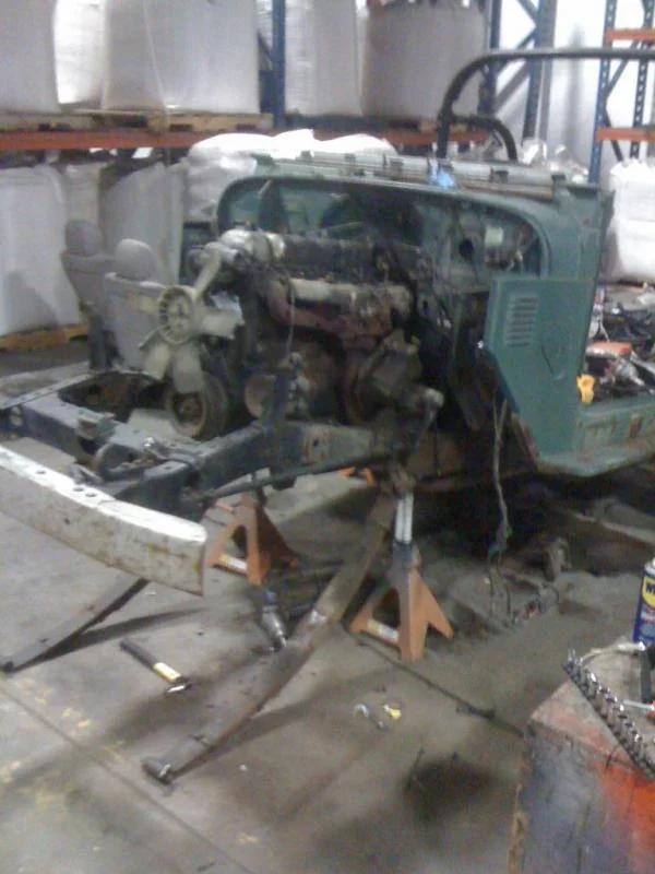

The Green Goblin (Donor vehicle) has been taken down to - well, not much left of 'er.
I'm going to swipe the 4spd and the xfer case out of it, and throw it in Voodoo...but I've gotta get the pressure washer out and clean up the 30+ years of gunk under 'er.
Maybe do that tomorrow during the SuperBowl. :)
Here's a close-up of the TRD wheel for Mossman40 . .. . they'll require a 1" spacer on your 40, as the steering links rub on the rim. Even with the 1+" of spacing, she looks sharp! Not too bad of an offset with the TRD wheels.
