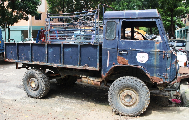

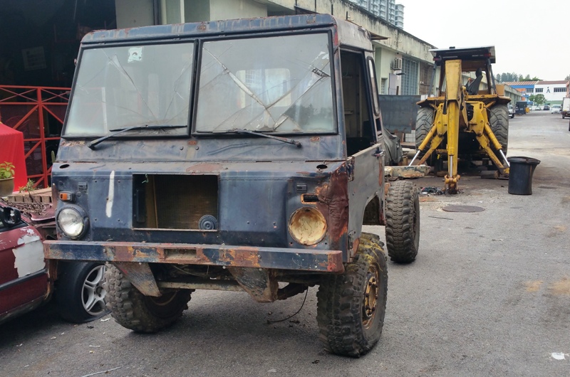

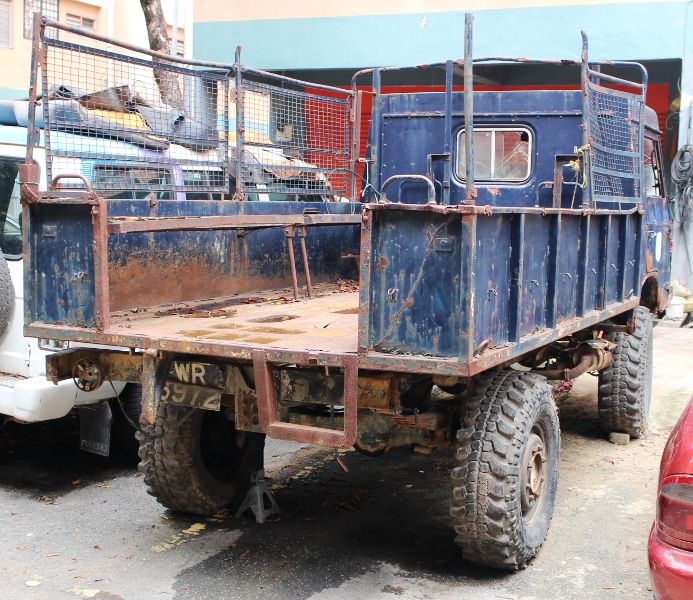

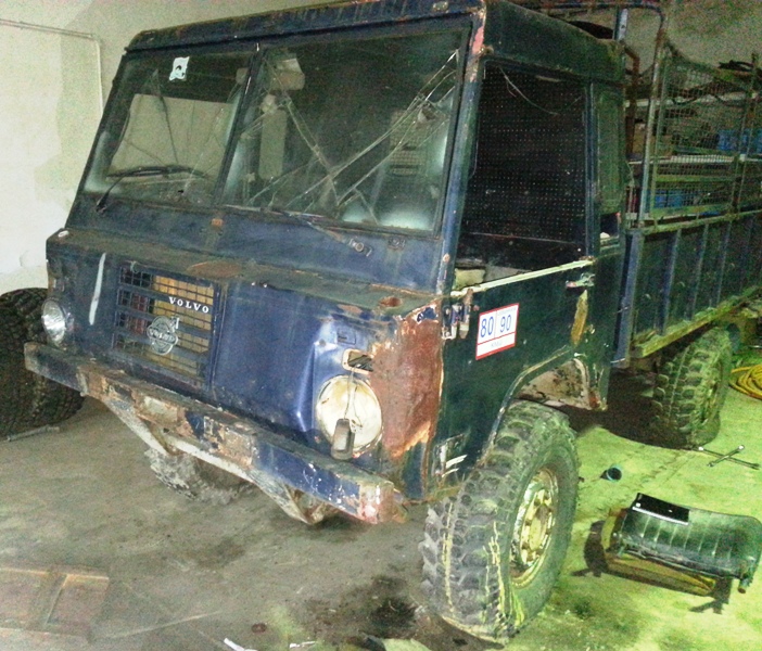

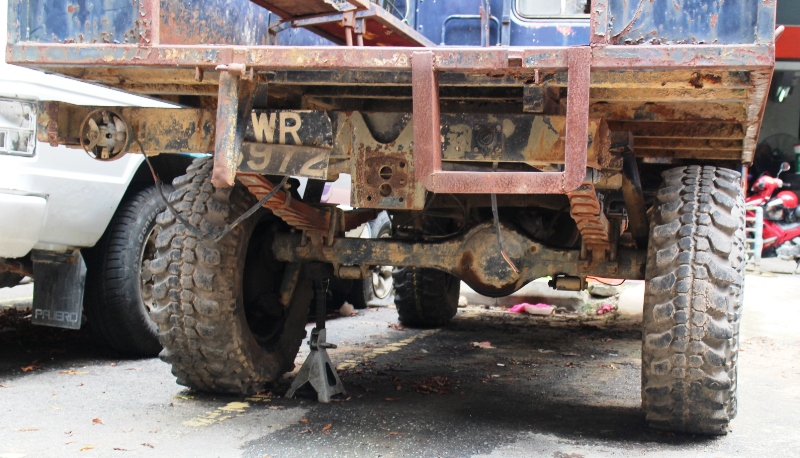

Pickup condition
It's ROUGH I know the tourist resort it ran out of and saw it being abused never thinking I would ever own it.
Right rear cross member is ripped of the chassis. Left side is bent.
It seats 12 people FRU policeman in full riot gear lol!
It's nice side
The wheels turn
Looks better in the setting sun in my friends private ship salvage workshop or does it?

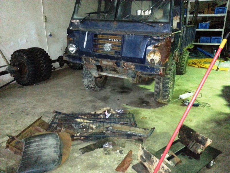

21 September 2016

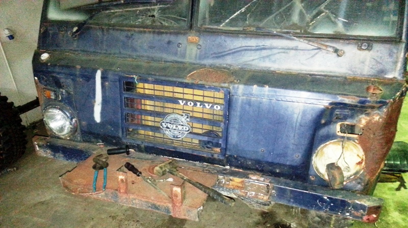

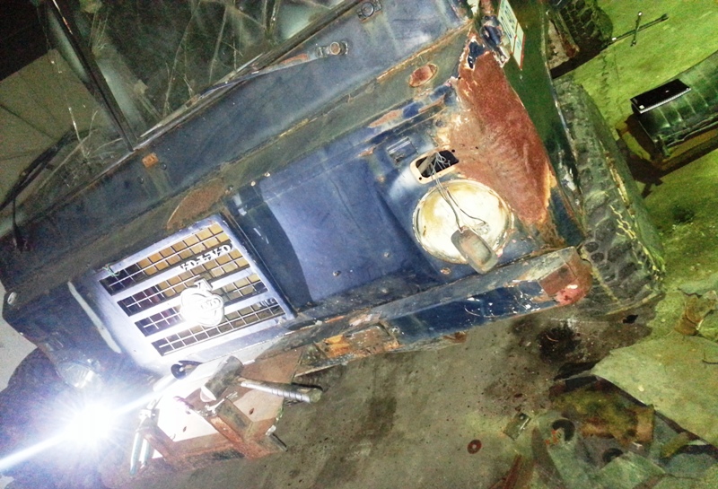

First nights work on it remove the ugly front winch mount
Finished looks nicer already

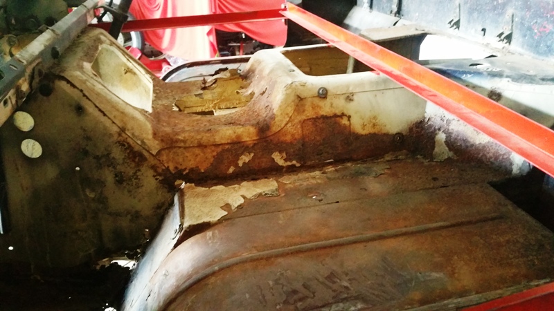

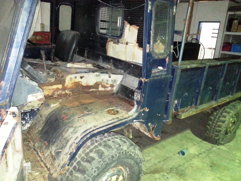

Removed the passenger seat and cleanup up. The rust becomes apparent.
The pile of scrap metal starts to grow. I'm sure they will make a compact Ford out of this soon.

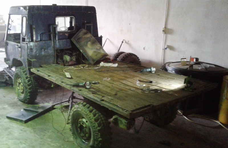

16 October September 2016

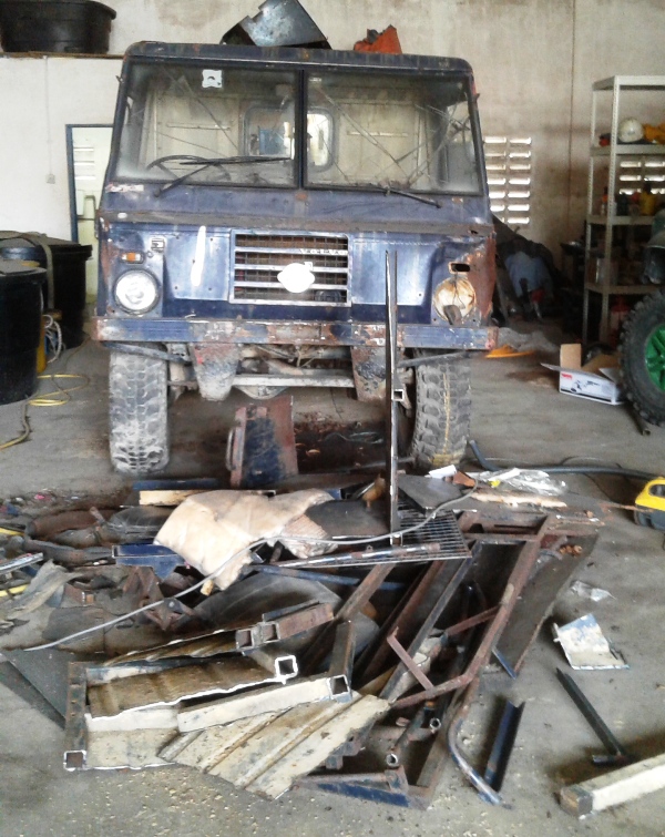

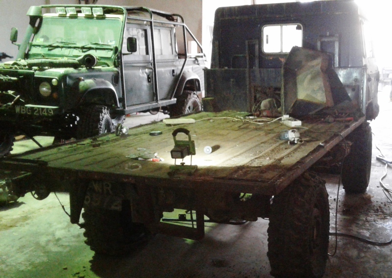

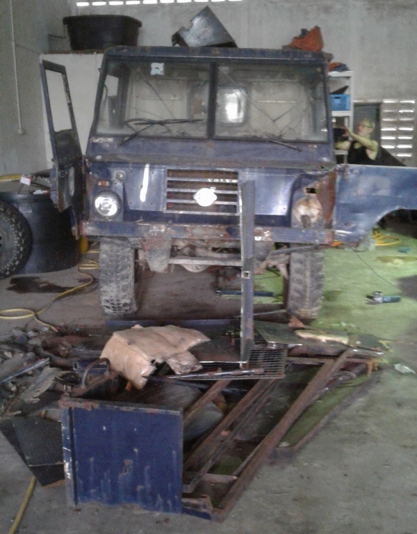

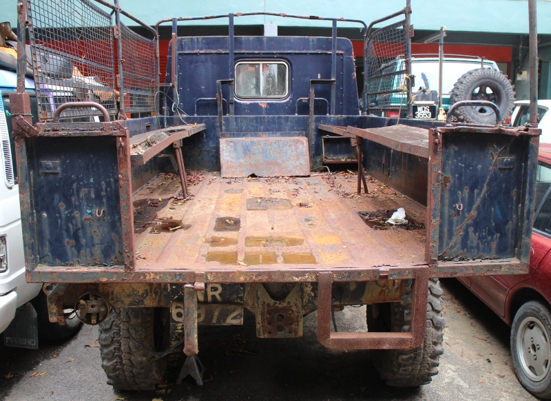

Two of us attack the rear tray object is total removal of it over the coming days

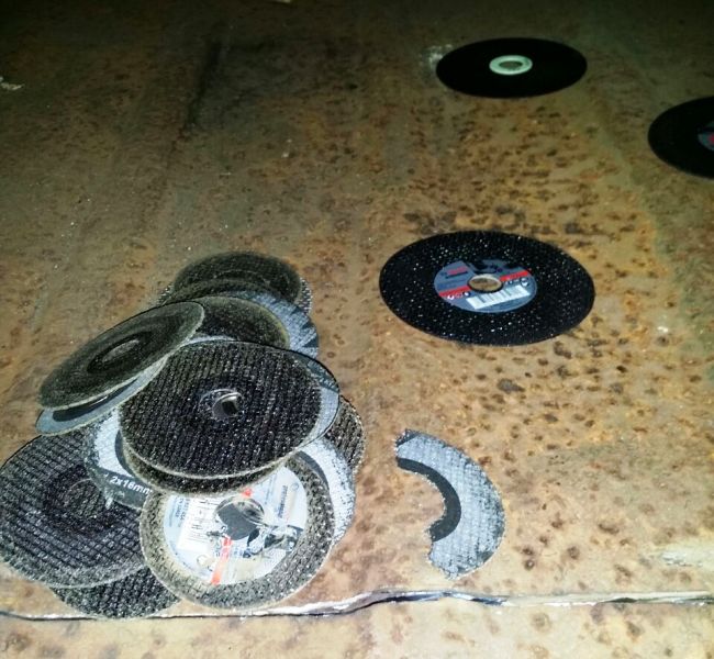

3 hours later and 38 cutting wheels are consumed but the sides are removed.
The pile of scrap gets bigger
Peter runs around and takes pics of the inside for me.
23 October 2016
New Makita 7" grinder in hand.
Commence to cut the bed up. A plasma cutter arrives Tuesday
2 hours I got this far.
Then I got a process going and 4 hours I had the left side removed.
The pile of scrap grows

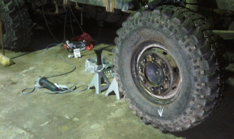

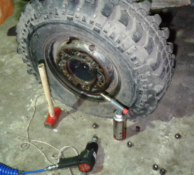

Had some free time tonight so decided to try and remove the flat tire and start removing the wiring loom or do the rollcage.
So first task get this flat tyyre off finally. Heat 3 minutes one side of the nut and then about 60 seconds on the other whack the breaker bar with the 4lb hammer a couple of times and hey presto I had a result.

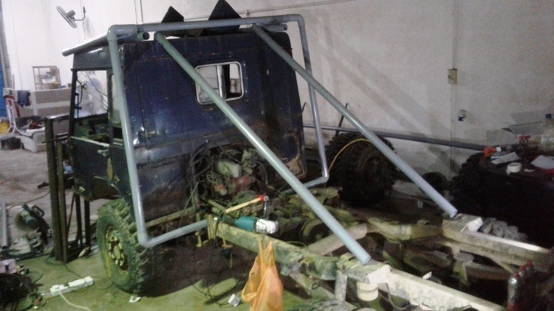

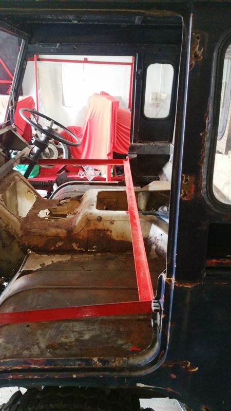

I decided it was late so started on the rollcage template and see how the sketch looks like in full size. I will finish it all off on Saturday so far it's looking good.

Had a few hours after the Kids CSR day at work so off to the Volvo with the repaired tire.

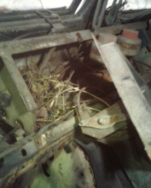

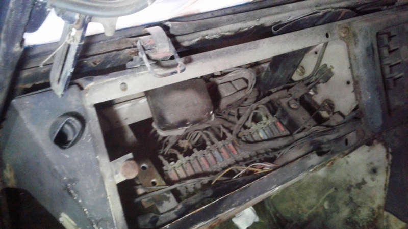

Started pulling the wiring loom while the light was good this truck is just full of surprises rodent nest inside the dash sigh. I'm still expecting a snake to slither out.
The rodent nest
Finally got the tire back on after cleaning up the ends of the studs with a cutting wheel to emove the burrs etc. Cheeck the other wheels all te same need to be heate removed and then cleaneed up and re-atached sigh need another 2 butane bottles lol.

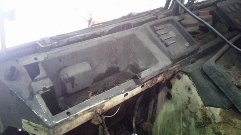

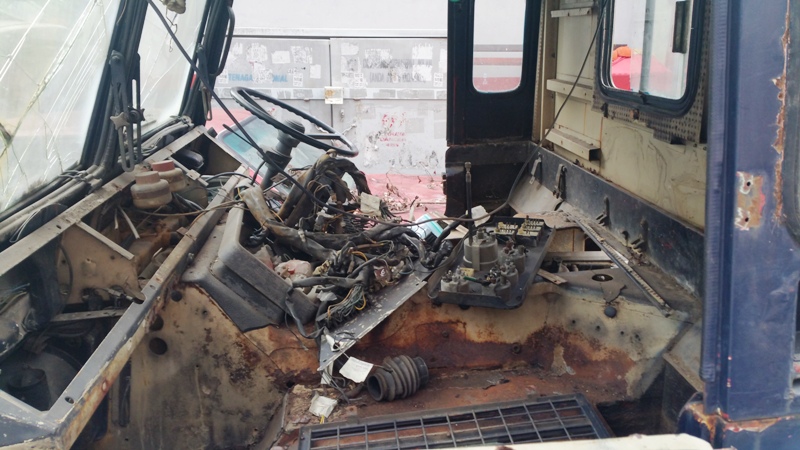

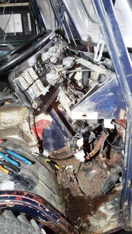

Told wife going to help someone on a PINZ lol. Headed over and started on the removal of the wiring loom and everything from the dash.
By the end of the day I have removed the dash panel and labeled the wire ends.

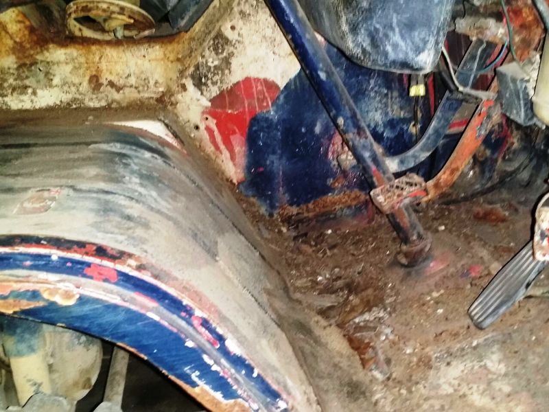

The brake/clutch pedal braket sigh its been bent by someone over pushing on the brakes HARD and rewelded what a mess. Need to strip it off repair, remove rust and the ugly chicken s*** welding reweld, and repaint.
Still trying to figure how I will get a 36 year old wiring loom out of the fire wall. I think I will have to cut it and label every wire sigh.
Worked on the PVC rollcage then time for home as the whole of next week is on Volvo 1

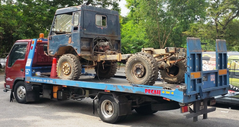

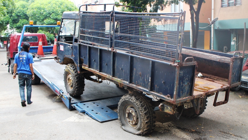

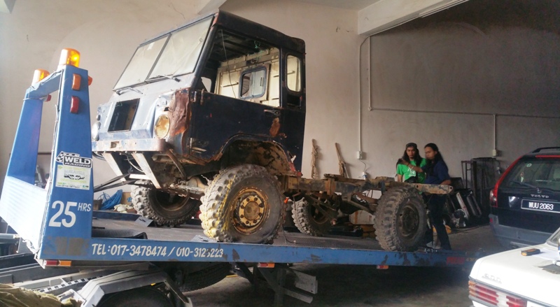

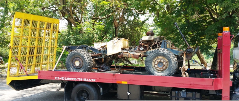

The tow truck picked it up from the current secret location.
Then it was ready to transport to the next stage of it's transformation into BADASS.
Then it arrived at the panel shop. So shocked they were they locked the doors lol.

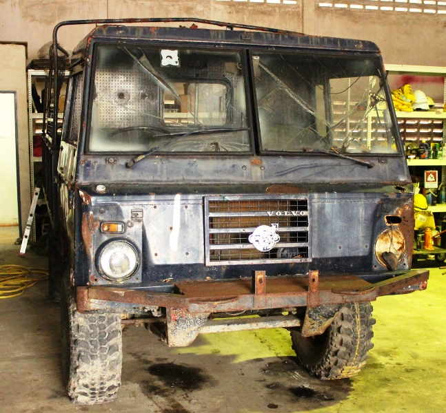

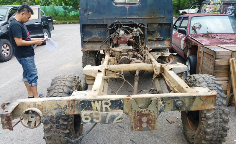

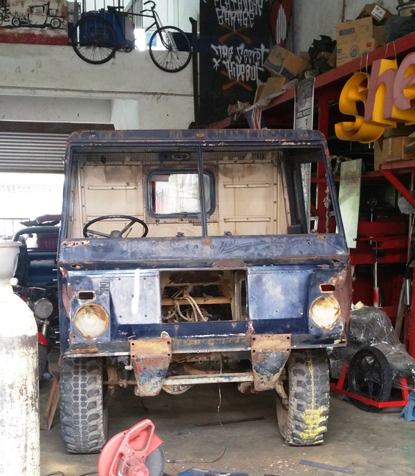

Daylight inspection shows the damage.
Right rear cross member missing. Middle Bent from a bad recovery the wire and the left side also BENT. It will be cut off and replaced by me later at the RACE shop.
The inside is a mess floors non existant.
Front is pretty bashed up as is the top of the cabin.

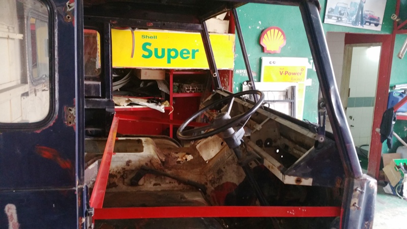

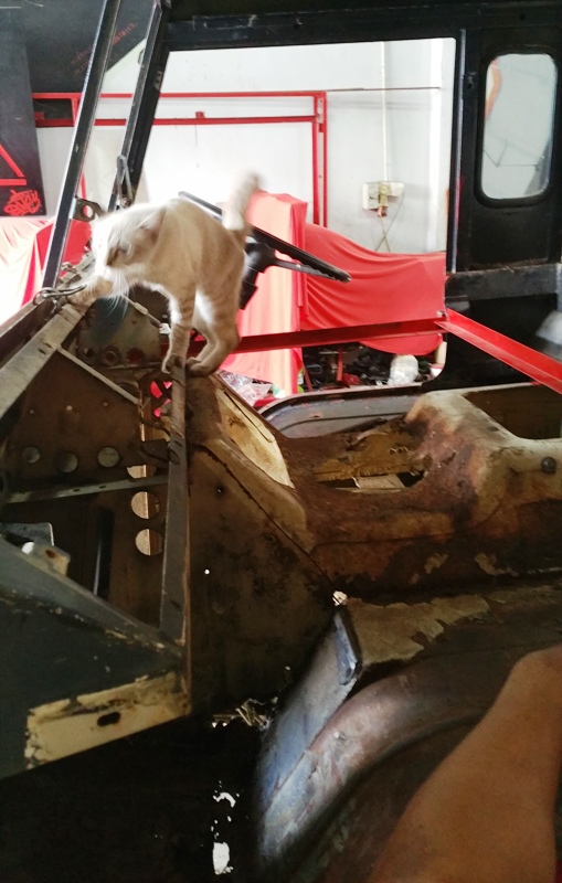

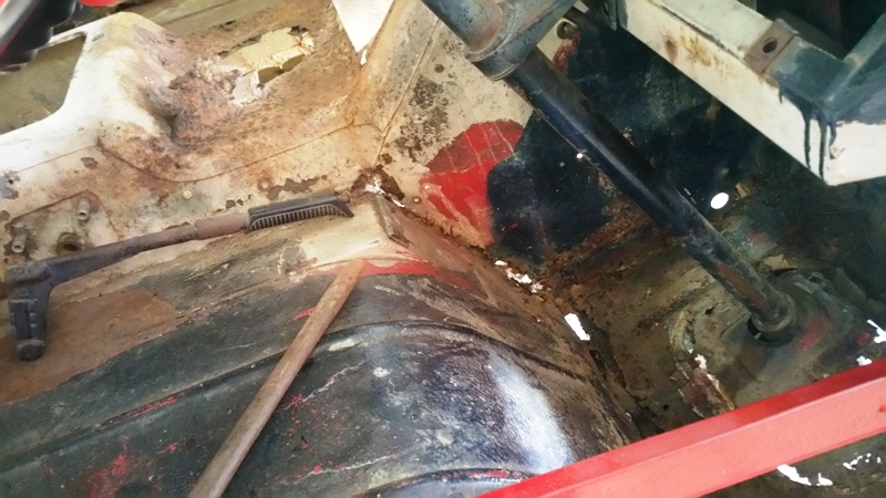

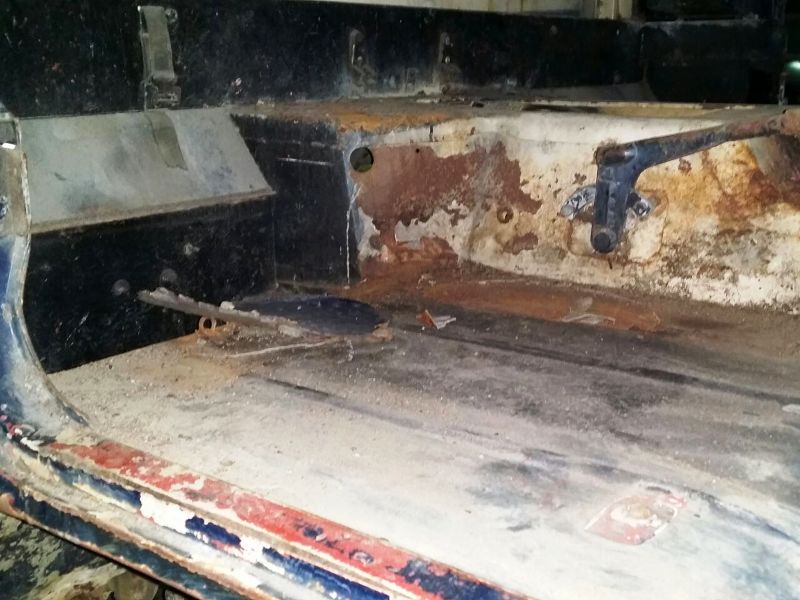

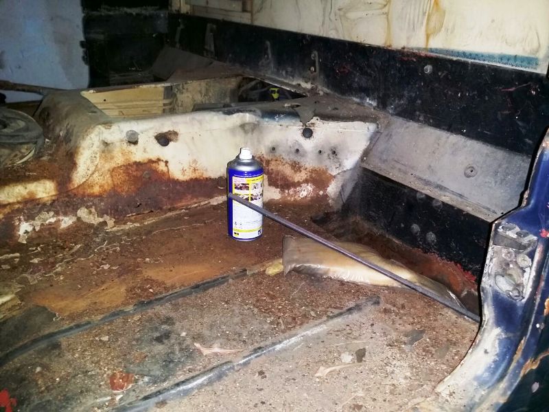

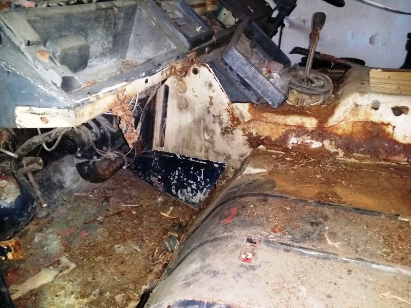

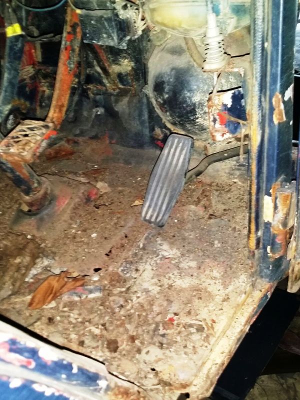

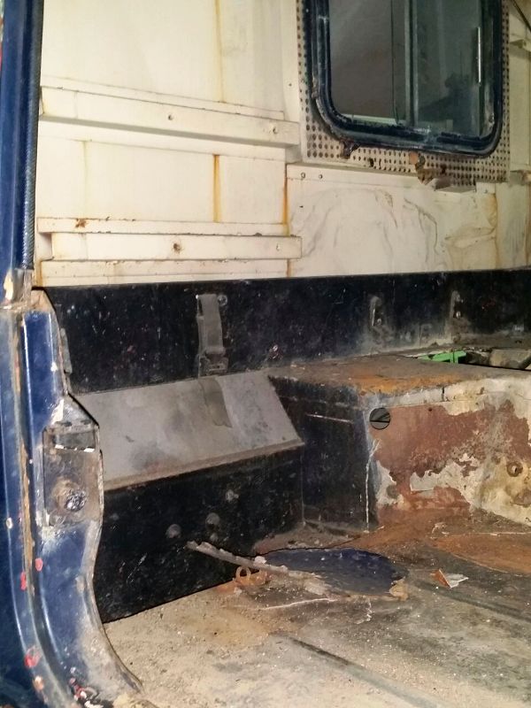

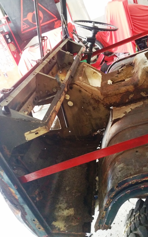

Inside view then the cheeky workshop cat decided I had food and started to investigate next time I will take him food. YUp the floor is rotten and are some of the interior panels.
Rahmat starts dreaming when its all finished I can go for a ride in it - maybe - lol
Yup its uite messy inside
Drivers floor is non existant. I have given them a plan to follow to make it easy to restore.

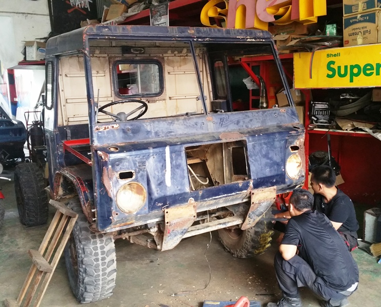

16 September 2017
Visit to Volvo 2 cabin workshop
First the cheeky workshop cat.

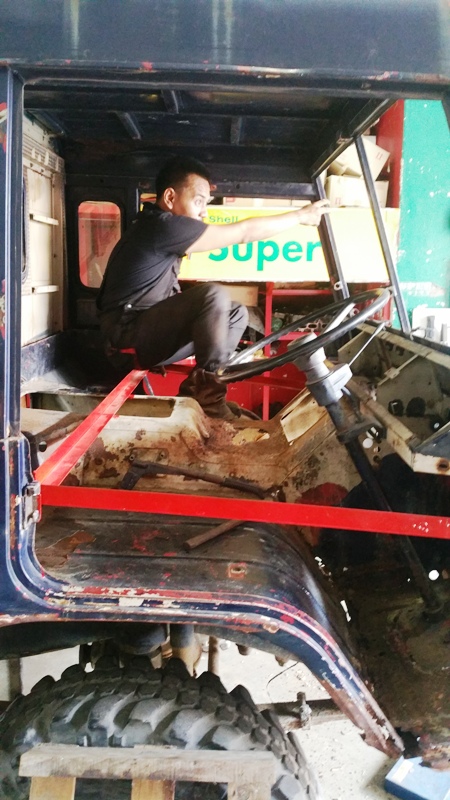

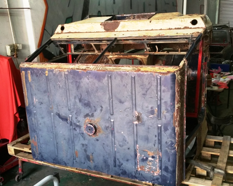

They have done tonnes of work stripping the paint off with a heat gun looking for holes and repairs etc.
The rear looks ok apart from the rear panel it has a few bad spots.

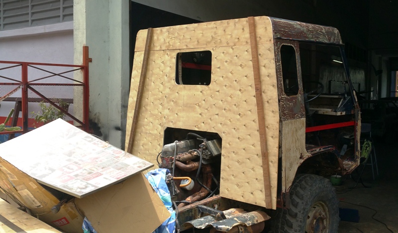

Then I started on the cabin template from plywood/ Next weekend will finish the front side so we can build the roll cage while the cabin gets surgery.

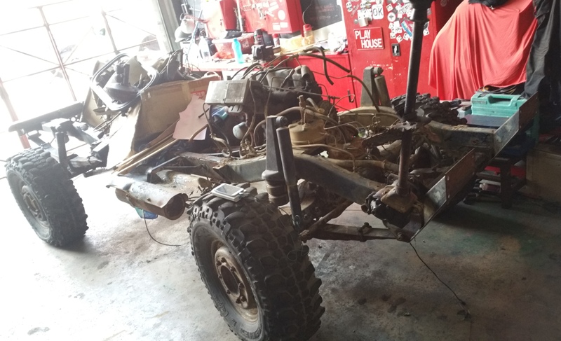

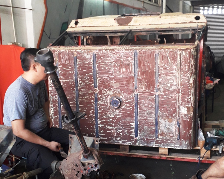

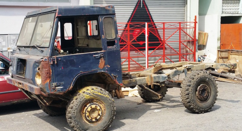

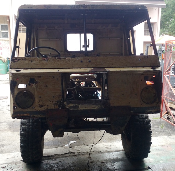

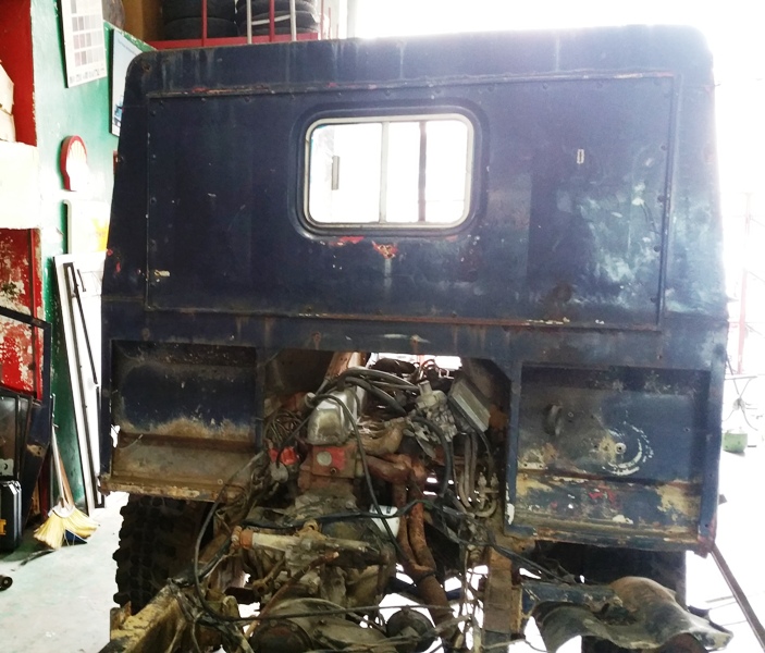

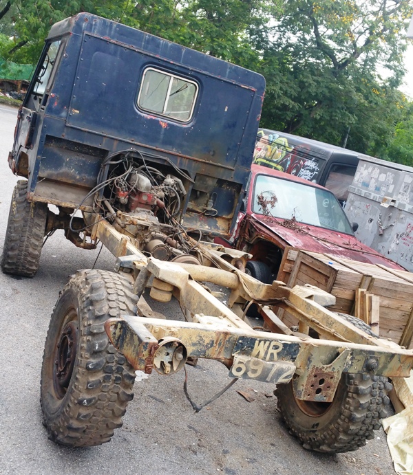

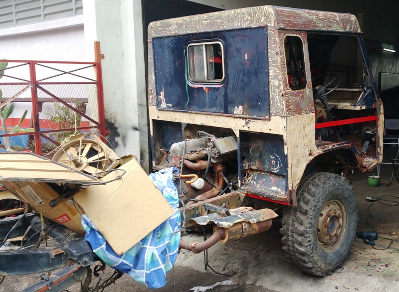

The Cabin and chassis have been separated after some difficulties with pulling the steering wheel off.
The chassis is ready to go to the rollcage workshop.

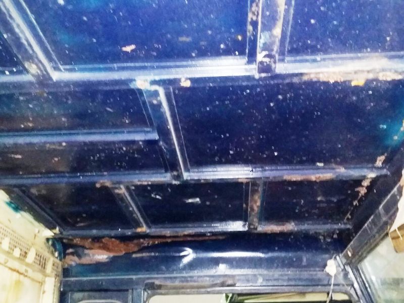

Saturday morning they have stripped the roof with a heatgun no sign of holrs or rust. Sandblasting is next.
The tow truck eventually arrives and is loaded up.
Then it's dropped in to its new home. It will have a PINZ for a roommate.

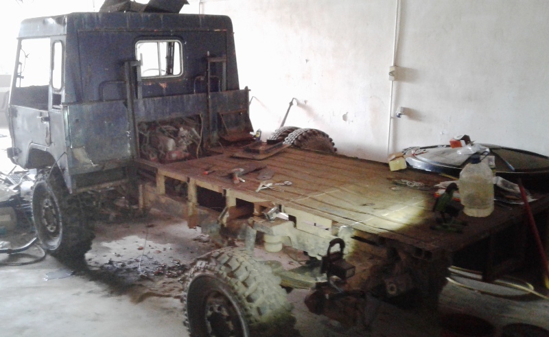

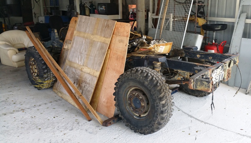

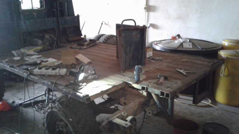

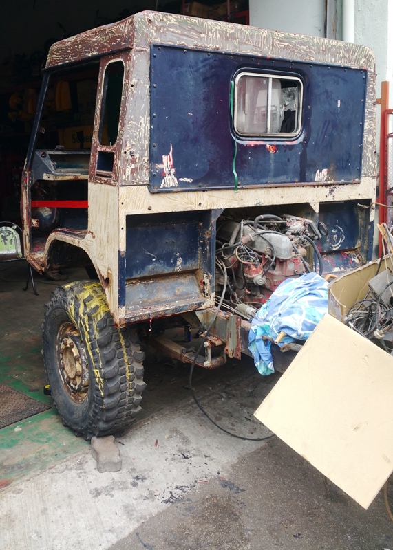

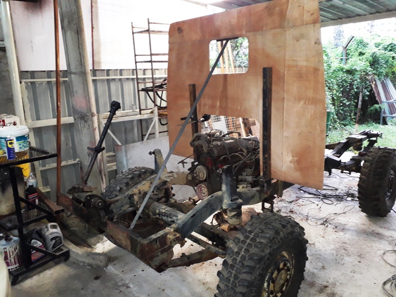

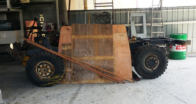

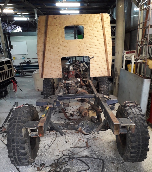

We mount the wooden cabin template raised 4" and then I start cutting of the rear bent up cross member. hours later its all made mincemeat with the 7" angle grinder and the little 4" grinder and it's ready for us to get the new one cut.
The truck is ready to go. New engine and gearbox has been ordered from the wreckers lets see if they can deliver a 3.0 ISUZU diesel and auto gearbox from a DMAX.
Front view of the cabin.
The wooden cabin gave us an idea and now the rear will have two parts. One will be old school wooden tray and sizes (for dressage) all removeable and the other will be alloy (for COMP and hooning)

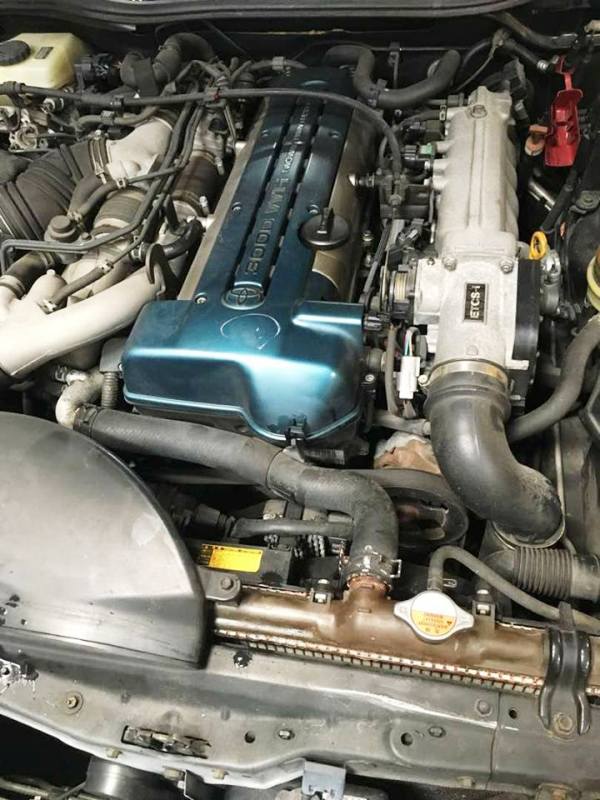

I cannot obtain and ISUZU engine and gearbox so went the other extreme since I hate the remaining alternatve of Mitsubishi engine/gearbox or toyota 1KZ/auto.
A 2JZ Toyota Supra VVTI 1/2 cut has been obtained and will be mated to a 4x4 auto gearbox.
Then it's going to a wireman to recover the loom and give me a turnkey engine and gearbox.
A lot of the other parts from the Supra can be used - DASH etc Radiator and all the overflow bottles and the headlights and indicators etc.

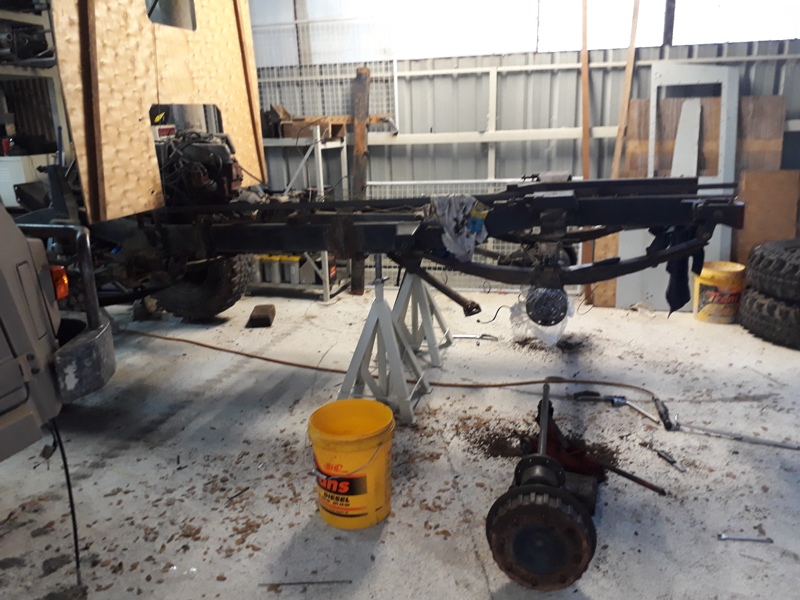

2 January 2018

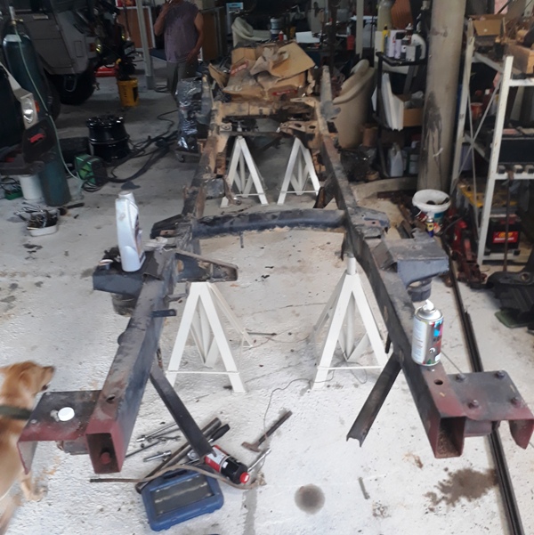

Volvo 2 is in 3 workshops.
Chassis in a shop near my office. Where rollcage and engine will be fitted.
Cabin in another workshop 10k from work - progress reports are not coming in neither are pictures - not happy. I am hearing from other customers from this shop they are really unhappy and just want a decent days woirk from this shop and it not be closed each time they turn up for work review and unasnwered phone calls.
Engine and gearbox and portals are taken to a 3rd shop 30k away where he is a trusted mechanic to do what I need.

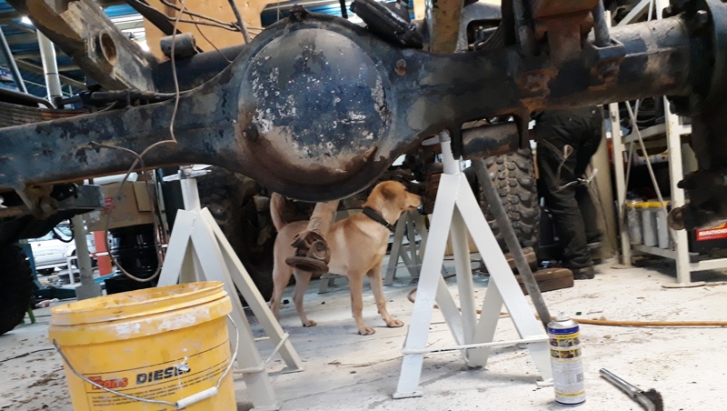

Work on Volvo 2 continues. After work I drop round to Volvo 2 workshop since it's 10 mins away from work and on the way home.

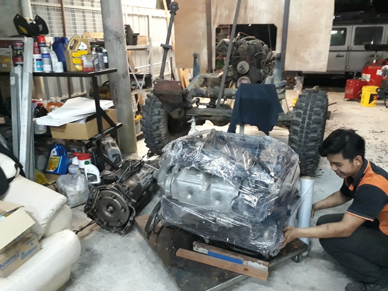

Had the 2JZ-GTE engine and gearbox in the Isuzu.

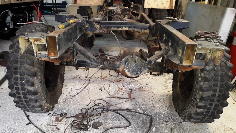

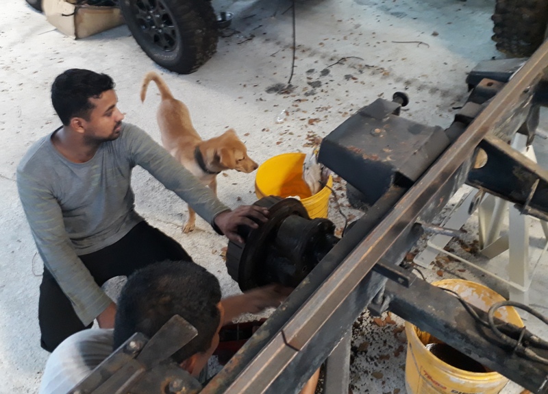

So we jacked up the Volvo onto it's new stands. Started pulling the Vovlo axles off. They do not get the last of off till next day as the broke 2 bars and went through 2 bottles of gas heating up the wheel nuts.
The engine was unloaded using the car hoist. I will collect the portals next week to take to the other workshop to get converted to Totota Discs and all new bearings etc.
We are waiting for the new bending machine to arrive from the good old USA before the rollcage bending can start.
The puppy decided he should help out.
The 2JZ is to be converted to single turbo and a general cleaup to make it a lot slimmer and less chances of hoses splitting etc. Currently it only has 1.5CM to fit inside the cabin tunnel.
