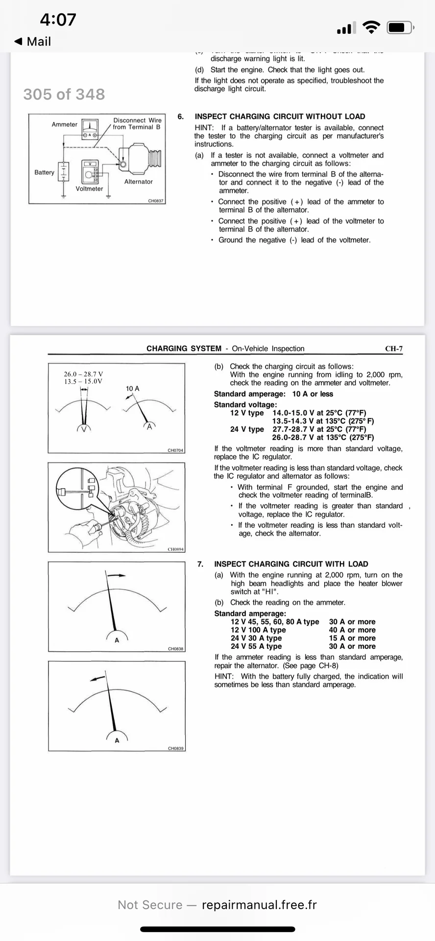

If you are referring to the arm on the voltmeter bouncing when the signal is on, I have heard it’s harmless, my BJ60 does the same thing. I can’t help much more, but flip to page 305 on the manual - it talks about what your running voltage should be at 2000 RPM.
Good luck.
Not sure about the tachometer bounce, but a little bit of bounce from the voltmeter is not uncommon when the flashers are running. It is just an indication of the varying electrical load from the flashers. You could try cleaning your battery, fusible link and ground connections in the engine bay to see if that helps any. Could also be aging connections behind the gauge cluster or even on the circuitry inside the cluster itself. At 14.5V @ 2000rpm I'd say your charging system is working as it should.
