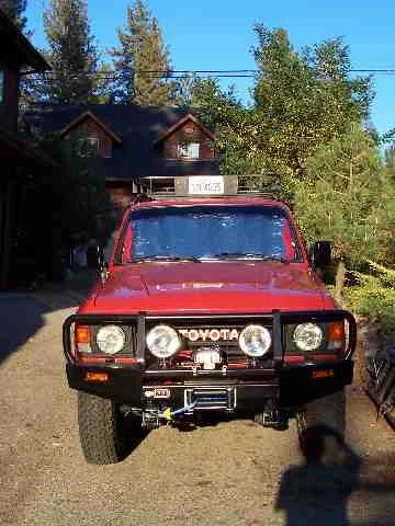

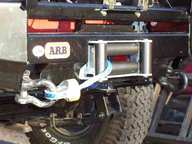

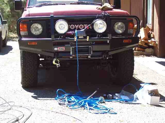

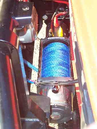

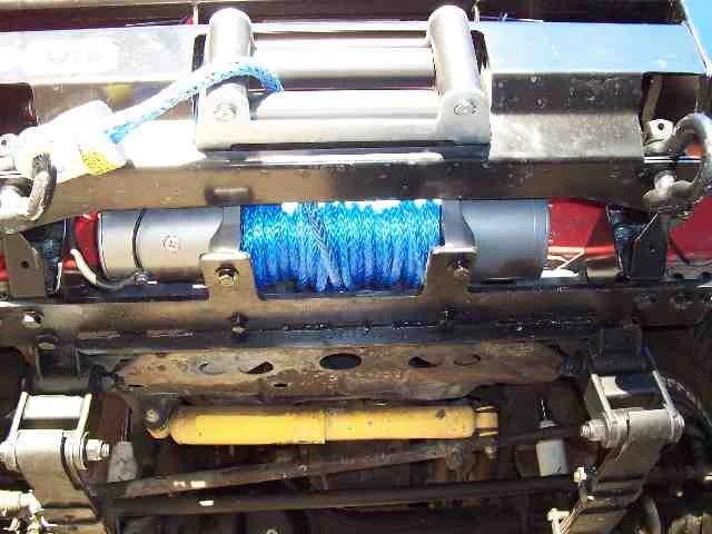

3/8"x90' viking trail line blue/winch safety thimbled eye/viking delrin roller.
Pictures worth a 1000 words.
But, you're not supposed to use a metal roller fairlead with synth line. They make billet alumn. or high temp plastic for the synth line
it's not a metal roller fairlead(viking DELRIN rollers made for synth,line.

Why would you use a plastic roller on synthetic line? This is possibly the WORST possible thing you can do. In rock climbing they teach you to never run a moving rope through a sling or allow the rope to come in contact with plastic during motion or stress. The rope creates HUGE amounts of heat and will eat through whatever its rubbing on.
Notice how ALL climbing hardware designed to slide on rope is steel, aluminum, or titanium?
And yes, the problem with any braided line, even cable, dirt can easily work its way into the internal fibers and weaken it from the inside out through constant use or vibration. The way climbers got past this, they switched to Kernmantle rope, it doesn't allow dirt into the interior nearly as easy as standard braided line.
except with this application its on a roller, not just sliding through a carabiner. I'm not sold on the plastic rollers yet myself but there is a distinct difference here.
