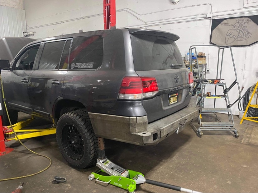

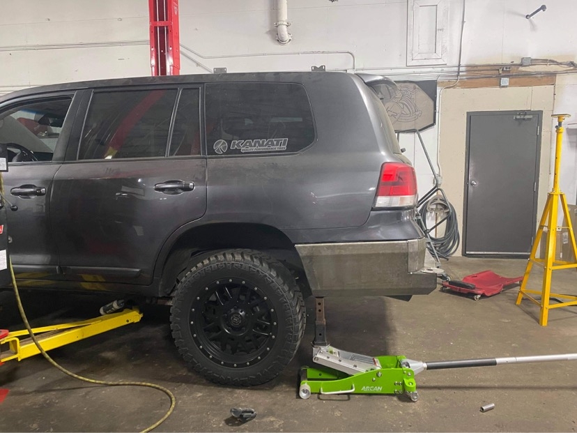

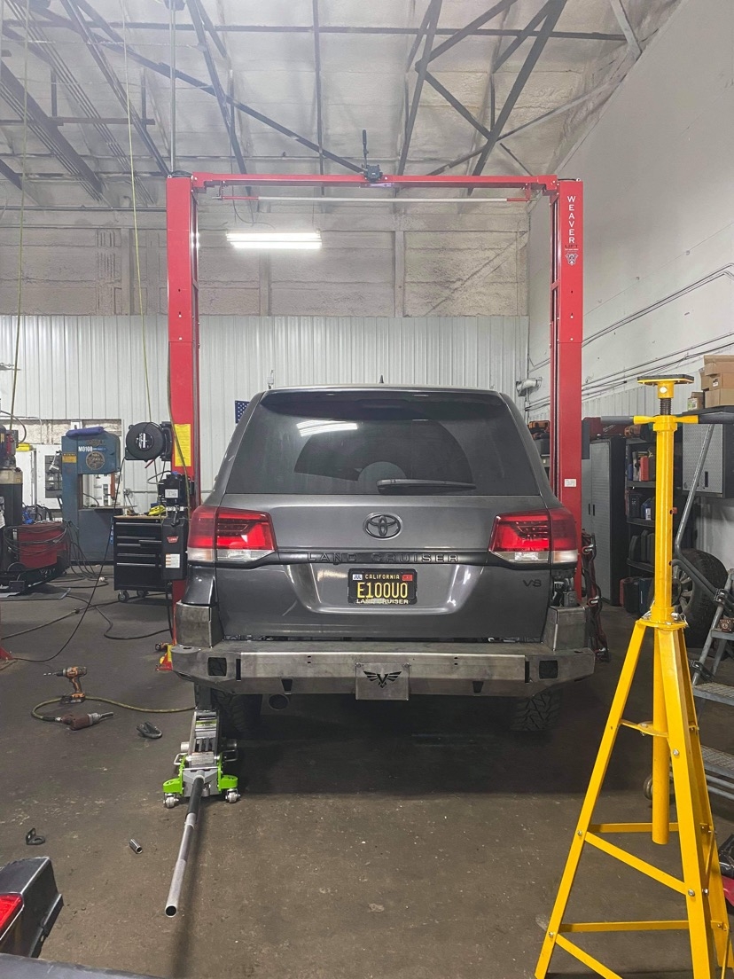

Testing flex on that strike rear
These bumpers will fit the 08-15 range Lc. The air bag sensors are inertia switches, so they will be unaffected. The rear will maintain the full factory tow rating, as it will retain the factory hitch.

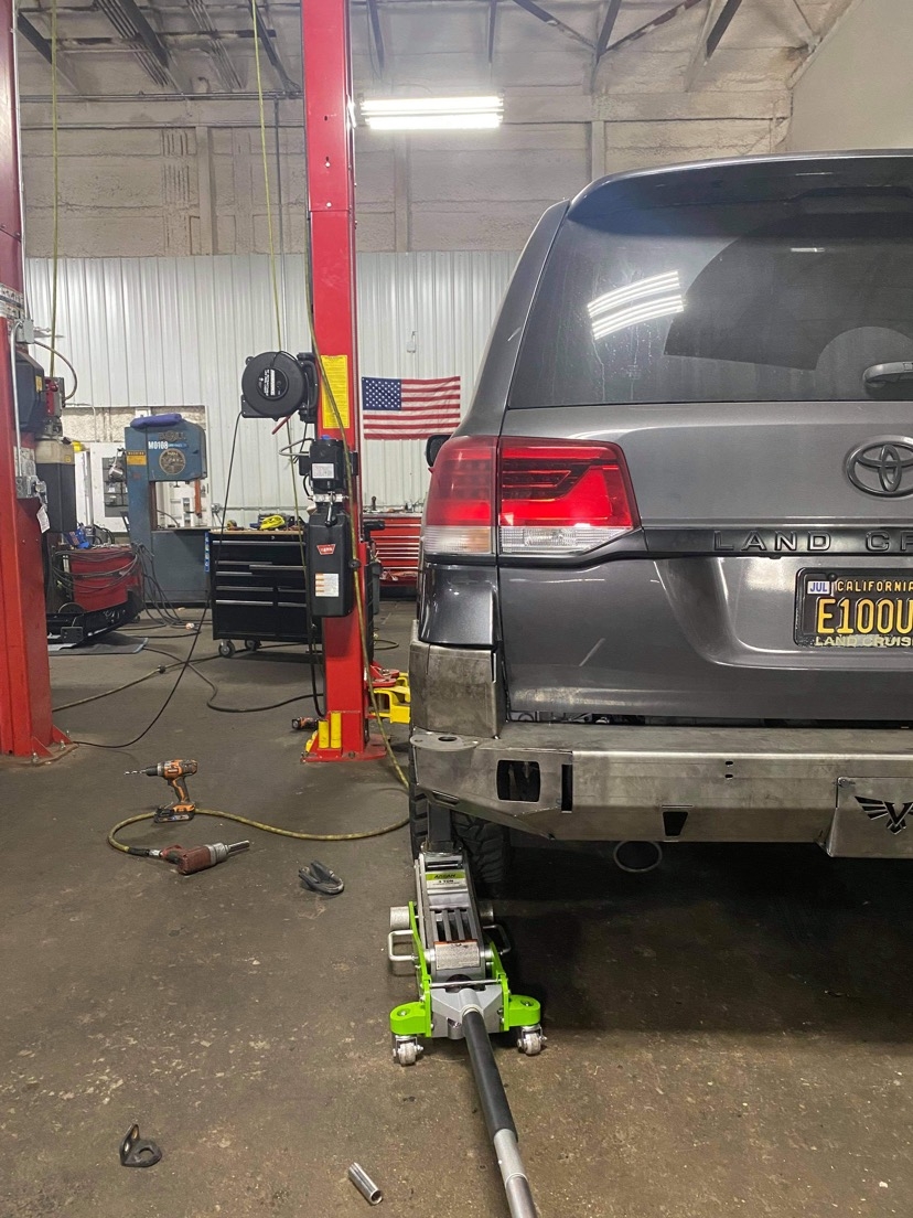

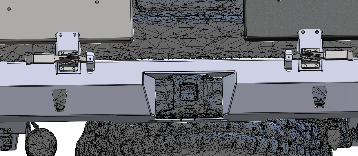

On the rear! Here’s our dual carrier strike. We ditched the hitch cover thing in the photos. Didn’t work like we wanted. See the rending how we updated.
Any option to relocate the trailing wiring harness into the rear bumper? That's been one of my pet peeves.
Are you planning brake lights in the bumper (since tire swingouts often block the tail/brake lights) or are those holes for rear camp lights?
Yes! I am toying with the idea of putting a hole in my factory bumper for this. I have a 40 gal LRA which evicted the trailer plug from its normal spot and is now tucked up well out of reach. I needed to access the plug a lot more than I thought I would and I have been longingly eying up the Dissent bumper for this very reason.
I toyed with that idea too. The problem for me was that the hitch is in the way and forces you to install it actually even further to the side than it currently is. Also there was not really any support for the bracket behind the bumper, and although the bumper is reasonably thick I was afraid a lot of tugging and bouncing around would cause it to crack the plastic and break loose.
You went further down the road than I have yet. Waiting for a free day to pull the bumper and see what’s back there. I had assumed there was some metal bar behind there that I could drill through. I wouldn’t mount to the plastic.
You won’t be able to drill through the metal. If your clever and there’s enough space you might be able to somehow mount it to the frame, but I think the plug is too deep
You can get access to a lot of the inside of the bumper without removing it, just need to pull the black plastic trim off behind the rear wheel
best bet I think would be to get a long piece of 3/16” aluminum maybe 4-5” wide and 1-2’ long, drill that so you can fit plug through it and then use that to reinforce behind the bumper so any movement is spread across a wide area of the bumper
There’s enough room, but you’ll need to take off some of the plastic bits protecting the plug wires:

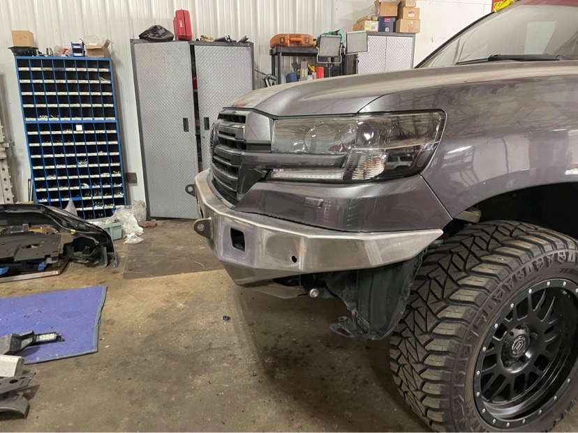

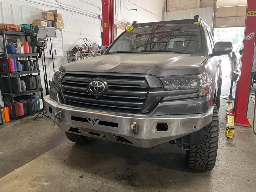

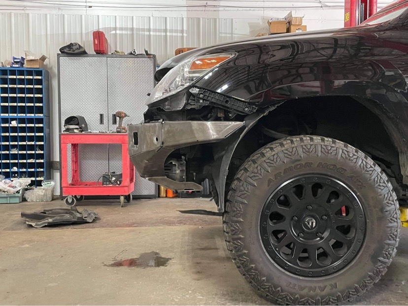

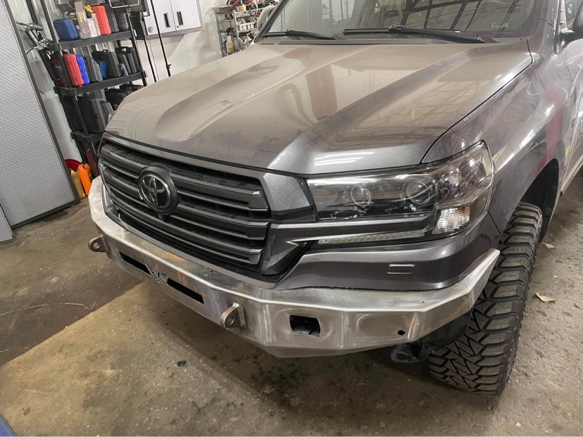

what is the thickness of the metal used? also there should be some gap with a rubber trim taking it up for when you hit things :)
also could you post some pictures of the winch drum access?
thank you
thank you

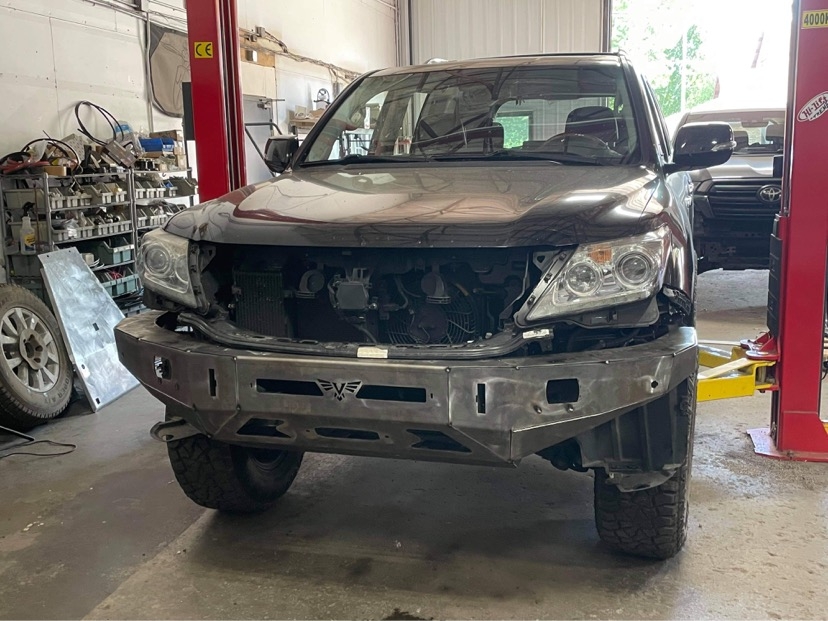

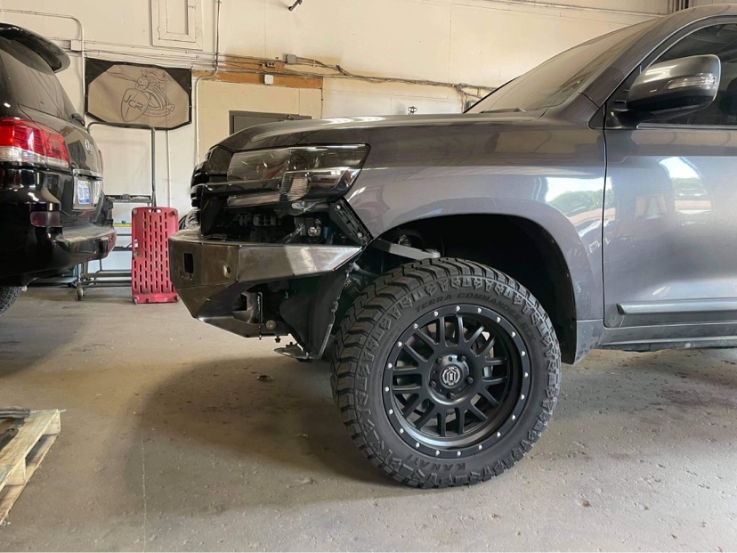

Agreed that cut is extremely tight. There absolutely needs to be a 1/4 - 1/2" gap to account for any bumper and body flex. Looks like even if you went on a dirt road that will bump and dislodge the OEM plastic trim nevermind bashing it on a rock. Good thing it's just a prototype, hopefully the production model addresses that.
@brimy311 i think the key issue is the frame and body move independently, and having no appreciable gap may look nice, but it won’t work well in use.
Seems like most vendors address this with more gap between the bull bar and the body panels and a bulbous edge trim that can fill the gap, allowing for that movement.
I think the Ironman bull bar users here were even having issues with the bumper hitting the tabs on the bottom of the headlight housing.
