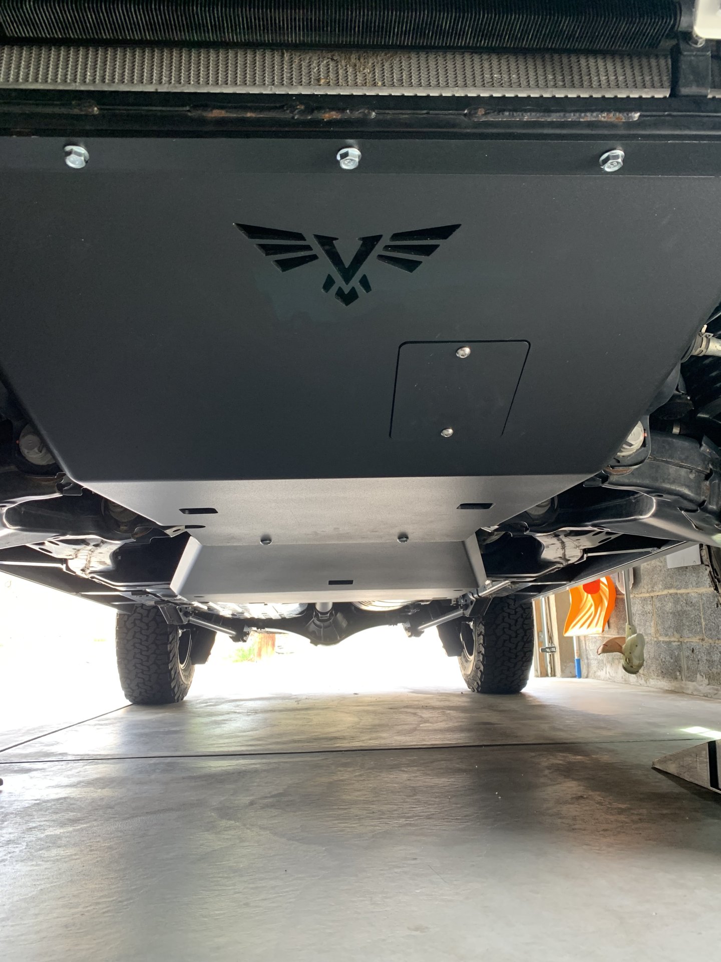

Skids are on. Very impressed with the packaging and delivery was easy one skid at a time. Still waiting for the gas skid but nothing that needs to go on right away. Ordered all three together. Fit and finish is awesome. I have aluminum versions. Took a little time figuring out the best way to get the bolts into the serrated nuts but once you figure out some tricks not a big deal. I like how simple these are. You don’t have to do a ton of steps to install them. Pretty straightforward except I wasn’t sure what the square powder coated spacers were for? I used them on the transmission skid on the back where the big bolts go through to the center cross member. I put them between the skid and the cross member as the cross member has a slight indent where the trans skid rests against. So bolt then washer then skid then square plate then washer and nut from the top. Seemed logical to me and worked well. But I still have two square spacers left in the hardware kit so wasn’t sure if these were spares or intended for another spot. Also few spare button heads and 13 mill bolts included which was nice in case one gets caught on something. Pretty easy to take off when needed. I am curious how the oil filter access panel will work. Definitely need a socket extension and hoping my Jowett filter removal tool fits in okay. The ez drain valve on the bottom of the housing fits well with plenty of clearance from the engine skid. Nice and protected. Nice notch in skid to access oil pan drain plug. Keeps that part of an oil change pretty easy. Thinking I will remove skids every three oil changes or so. So for me about once a year.

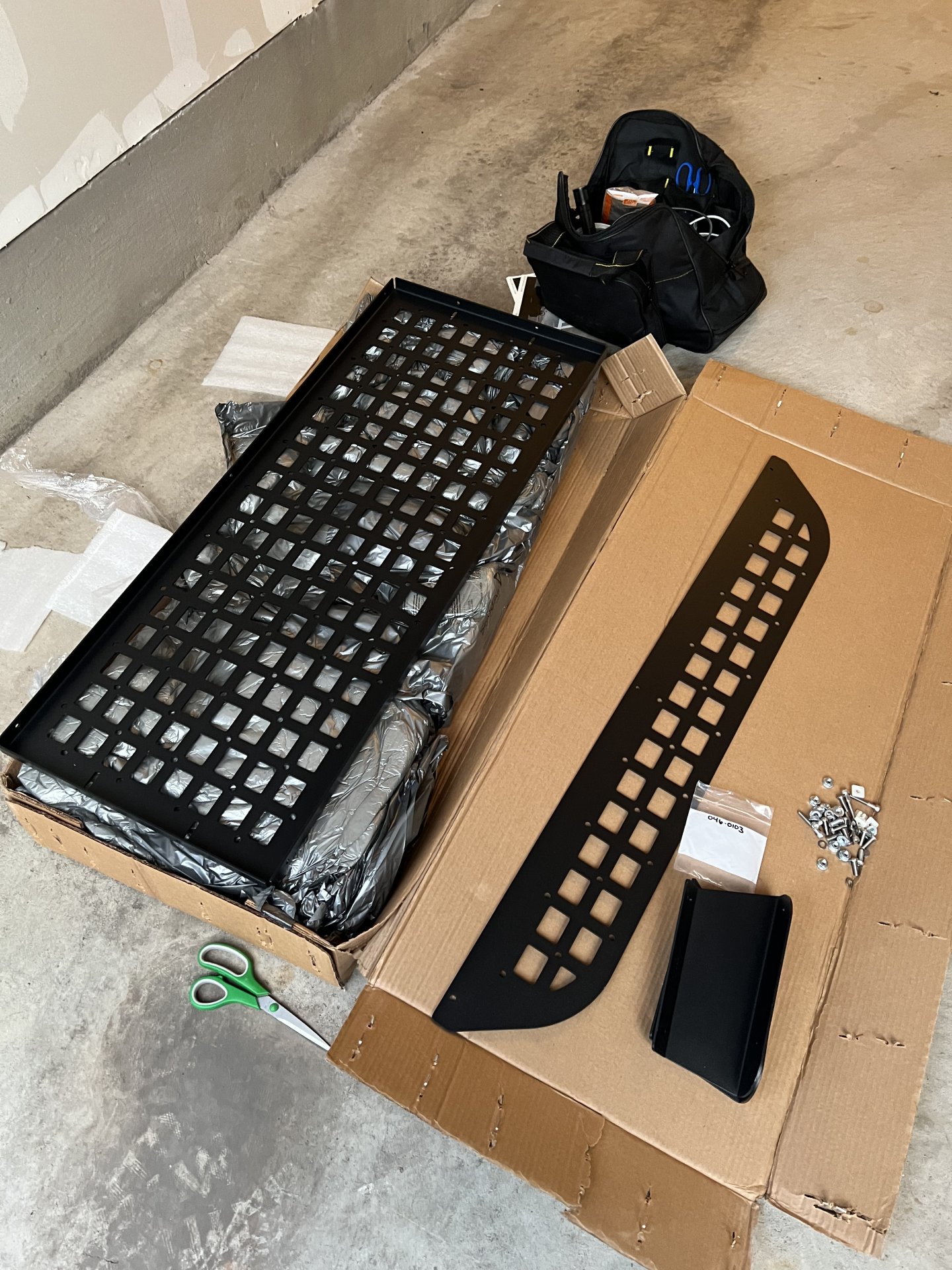

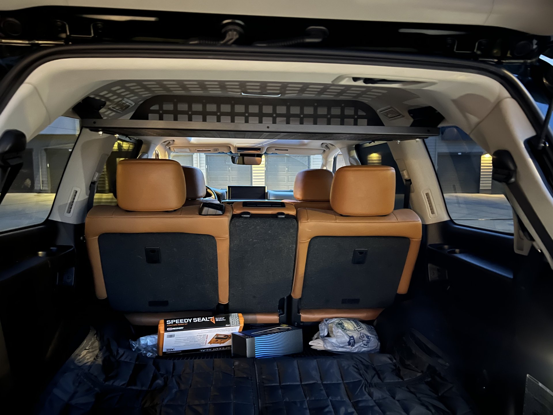

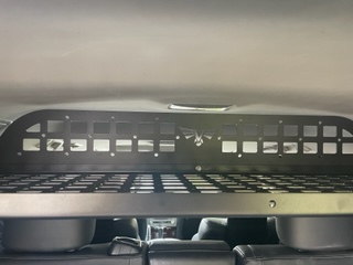

Hi @brimy311,
Does your LC200 upper shelf also fit the LX570 of same year ('08)?
Thank you!
