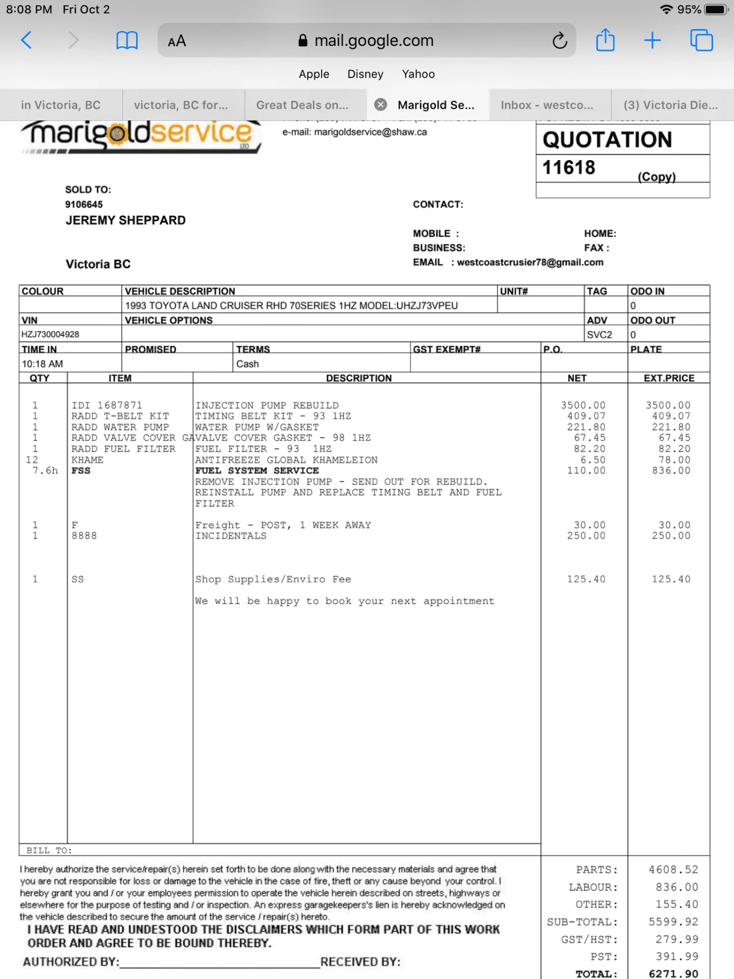

You can buy a lot of tools for that kind of money! Best to learn how to do it yourself. How many kms on your truck? Does the Injection pump really need to be rebuilt, or just resealed? It's a big difference. Most just need to be resealed, but people generally don't understand the difference.
It has 185,000km. I didn’t think it would need a rebuild so soon. Wouldn’t a new injection pump be cheaper than a getting a rebuild?
Absolutely amazing! Good tips from @GTSSportCoupe . Do yourself a favour and get some manuals. Figure out if the pump really needs rebuilding, if at all, or its just injectors. Pumps are pretty tough, filter that fuel properly and keep that oil fresh. Look at the invoice, most of those shops have no clue/don't have the tooling to rebuild pumps and send them out to someone else. If it's gotta come off, pull it off yourself and sent it off to the rebuilder. When it's back its usually just a matter of timing the pump and resealing the assembly. I'll sell you three cans of brake clean and some shop towels all day for $165.00!! F@#K sakes!!! Source a factory NOS one from Europe somewhere, with the money saved, take the family to Japan and tour the assembly plant when the pandemic is over... Wasn't directed at you, just the never-ending gouging from those shops! There's a wealth of knowledge on this site, keep digging into it. Good luck!
Does your truck drive the way it always has, but your injection pump leaks now? It's very typical for the seals of the rotary injection pumps on these 1990 plus diesel landcruisers to dry up at some point and need replacing. I've had to do it to both of the Toyota diesels I've had. It doesn't mean they need rebuild at all. And as I wrote near the beginning of this thread, new seals are only about $50.
If your injection pump was dying, you'd have different issues. They get super clattery, your truck would have a hard time starting, be super smokey, low on power, etc. Even if this was the case, you'd send the pump only out to a specialty diesel shop and have it evaluated with quote before proceeding.
The bulk of the work is getting the pump off the engine, and back on. Most of the job is fairly straight forward though. Between us all here we have the tools you would need for removing/installing and re-timing. Or you could just pay Marigold to do that work, and ask to deal with the pump yourself. I could help you seal it if you want. It just takes a couple hours.

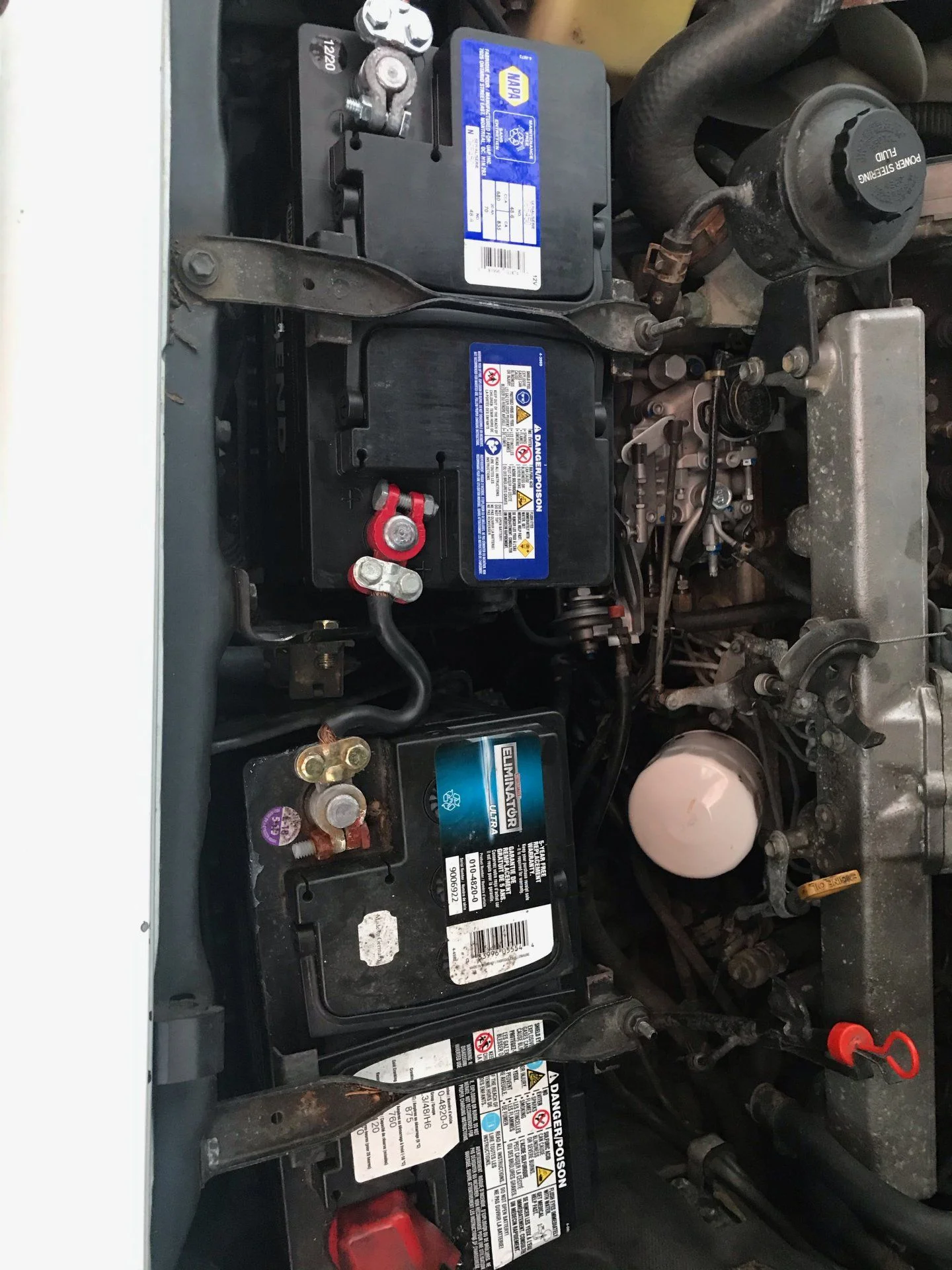

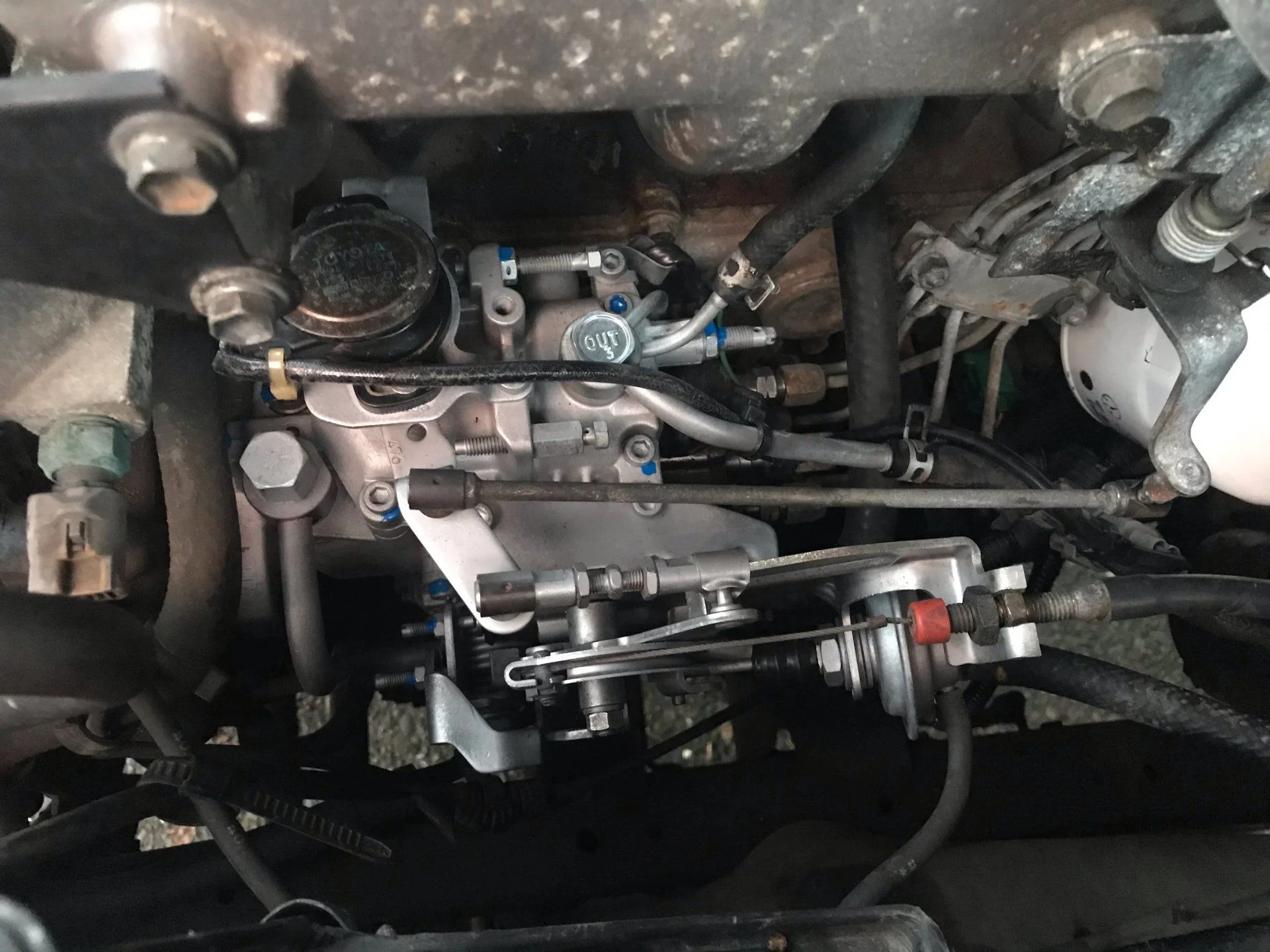

Can you post some pictures of your leaking injection pump? From above and below if possible? I could probably tell you which seal is leaking just from pictures.
@Westcoast78 You should download the manual for your motor and get familiar with it if you haven't already. Toyota manuals are excellent, and a great way to learn how to do your own wrenching. http://repairmanual.free.fr/_1PZ_1HZ_1HD-T_engine.pdf
Also, this is the seller I ordered my seal kits from. You should order one regardless, just to give yourself some options. Toyota 1HD & 1HZ Diesel Injection Pump Repair Seal Kit + Free Instructions (4) | eBay
I tried to get some photos of the pump but the tight spot and lack of light made it really hard. No idea where it is leaking from. I probably need to remove the batteries to get a better view. When I do, I’ll post up some pics. Thanks again for the help!

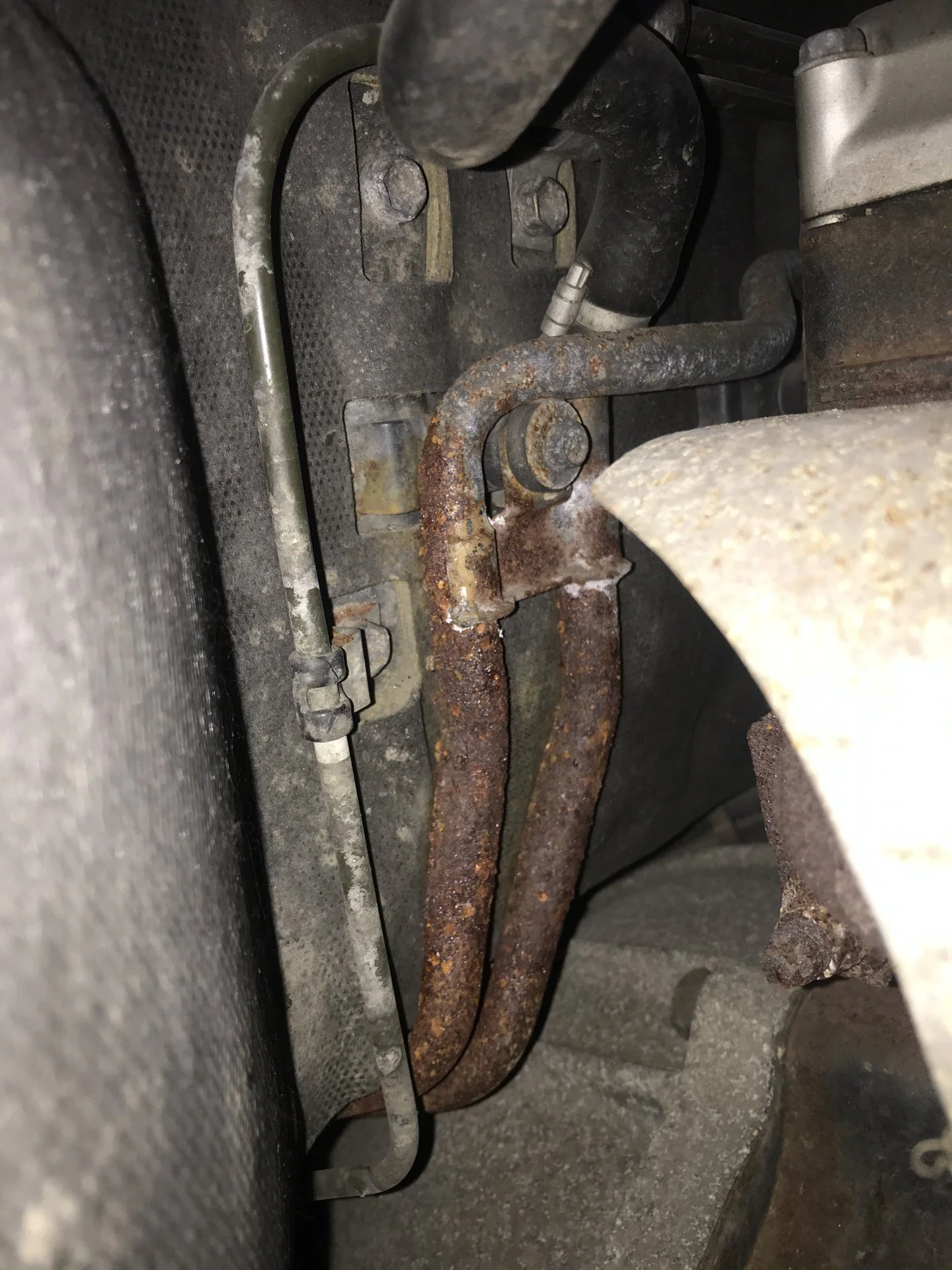

Truck is fixed. Injection pump was rebuilt. Everything works and looks good. Anyone have any idea what the rusty pipes are? The are mounted on the firewall.
I do believe those are the lines to the rear heater.
Probably even rustier under the truck, if you don't use the rear heat you can just bypass to avoid the inevitable leak.
Thanks. I take a look to see how bad they are underneath. The rear heater still works and I use it often because I have my 5 year old in the back sometimes , hopefully they aren’t too bad
