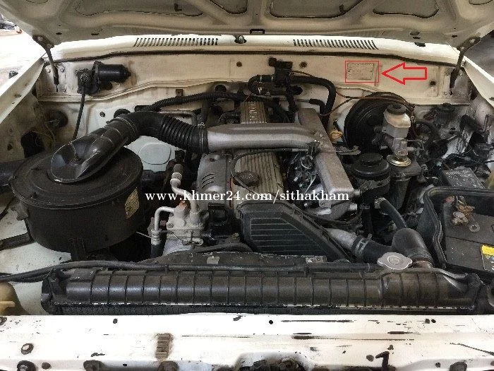

1.) Can someone help me identify this motor? (The owner says that it is a diesel motor. He doesn't know whether it's turbo or naturally aspirated.)

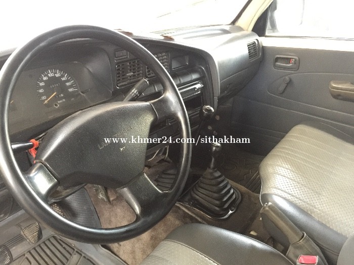

2.) Does it have a locking center diff? (There is no CDL button on the dash.)
3.) If it does have a center locking diff, how is it actuated without the button on the dash? (Is it like the 1993+ 80's?)
4.) Is this full-time 4wd?

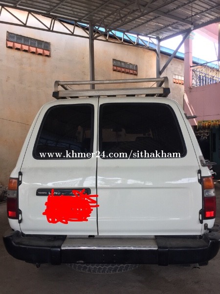

Also, did you notice those slimline handles on the rear right of the truck that serves as a ladder? I've been searching for those online and couldn't find them anywhere, I don't even know what that part is called, which is part of the reason for me wanting this 80 so badly. I'm told the UN had these on their trucks, which is why I'm thinking this may have been a UN truck at one point in time, however I believe the UN ones didn't have the fiberglass flares.
1). No turbo. And no expert here so i'd venture a guess of 1HZ or HD leaning to the latter. Should be some easier identifiers but i am more familiar with petrol models here
2) no idea but assume so.... then again the ctr with VC may have been american mkt item
3) id assume an actuator in top of tcase that locks ctr when in low range
4)no. You pictures show locking front hubs

Steps have been found and added before. Not sure if it was sourced new or feom a part out. IIRC finding the backing plates was the challenge.

Looks like you DO have the factory roof rack on that though...
In the states we got a crappy one that mounts through the sheetmetal. Other destinations got one that is a gutter mount and has "tailored" mounts that fit the body as well. Looks like a nice find.
Also, I believe it has a 1HZ engine. The Cert sticker in the driver door opening should tell which engine, trans, etc.

HZJ80 should be the proper model designation, as it's a non-turbo 1HZ motor. Looks like a cool truck.

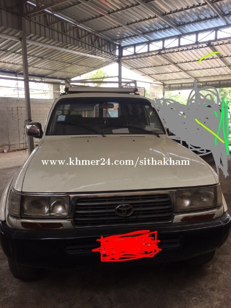

I dig the troop carriers. And ambulance doors. Ideal.
That's what a utilty vehicle should look like, no wonder they are used by the UN in 3RD world countrys. Pure simple design, diesel engine, 5 speed manual transmission, cloth seats with BIG ambulance doors out back, what's there not to like!
I think those pictures show vinyl seats.
On second look, you sir are correct, they are in fact all vinyl. When i first looked at those photos i though the seats had cloth inserts, but thats not the case.
