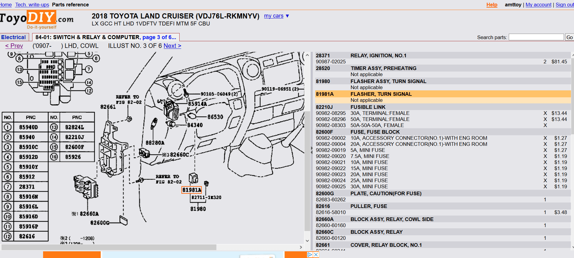

You are looking for something that isn't there. The flasher function is controlled somewhere in the body ECU or the instrument cluster. There is no "flasher". View attachment 1982721
I saw that .. but I could not believe in my right mind why Mr. T would do something like that .?
I actually took out the Cluster and sure that was no more turning light or anything but that also happen on the 80 series ..?
The only comparrison I have personal knowledge of is my 2009 Dodge Challenger SRT8. That vehicle does not have a conventional flasher unit. The flasher function is electronically controlled within the cluster which is a sealed unit.

My 60 and 80 series also have a flasher .. but that's not my complain .. I can understand that part, but why in the FSM state that there is a flasher when is not .?
Makes me wonder how much the FSM can be " trusted " .?

Perhaps your manual does not apply to your year model? Or, perhaps it covers multiple years and you have not found your configuration yet?
Might be the second one .. coz this it's the latest FSM for all 7* series available.
One note is there is a iteration 2012 - on but I know there is a variation on 2016 ( ABS - DPF ) for the Australia Market ABS - DPF go together but in my case not .. mine have ABS but not DPF ..

And to be honest I would ( not possible ) rather have a paper book .. this DVD it's as complicated as it gets .. mines have all data from 199* 70 series and included 80 series .. ( weird I know )

All the info from 199* all the way to 2018 ..
But the info for the late model came as " add on " on another window ..
Here few pics so you get an idea ..
