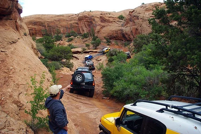

If you going to wheel even moderately aggressively on rock, it happens. The first video is of a step on Zuki Hill, it is a long complex of climbs/obstacles. With a big group there is often rigs working many obstacles at once, so a din of seals barking. The video makes it look flat, the pic does a better job of showing the climb that the ledge is on, where the yellow FJC is.
The second video is some obstacles with seals barking. Often, once an obstacle is cleared there is nothing but an expanse of slick rock, so to unlock you have to rock the steering wheel, blip the throttle, bark the tires to relieve the bind. This becomes second nature, when you have done this, the whole "never lock on high traction surfaces or you will break something" argument becomes :lol:.

I'd still say that is fairly slick rock (no pun intended). Either that or they have their tire pressure way too high. (Which they do look high in the video, but hard to tell.)
But I'm used to wheeling on mostly granite rock. The second video shows it well, the sandstone has been worn very smooth. Granite doesn't wear smooth like that, it tends to flake off or break. In this area, if you're spinning the tires like that you've lost traction. This could be due to being stuck, high centered, tires in a hole, PSI too high, or a layer of super fine dust sitting on the rock (makes it about as slick as ice).
You never spin tires like that due to too much traction. At least not where I wheel. :meh:
