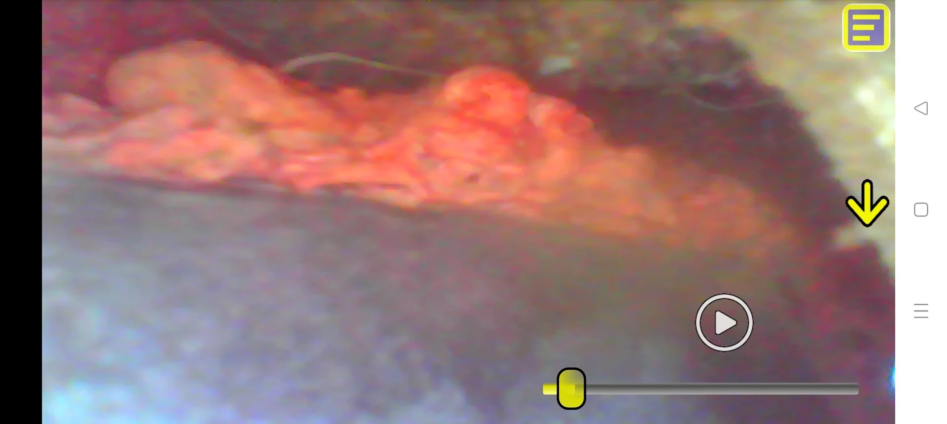

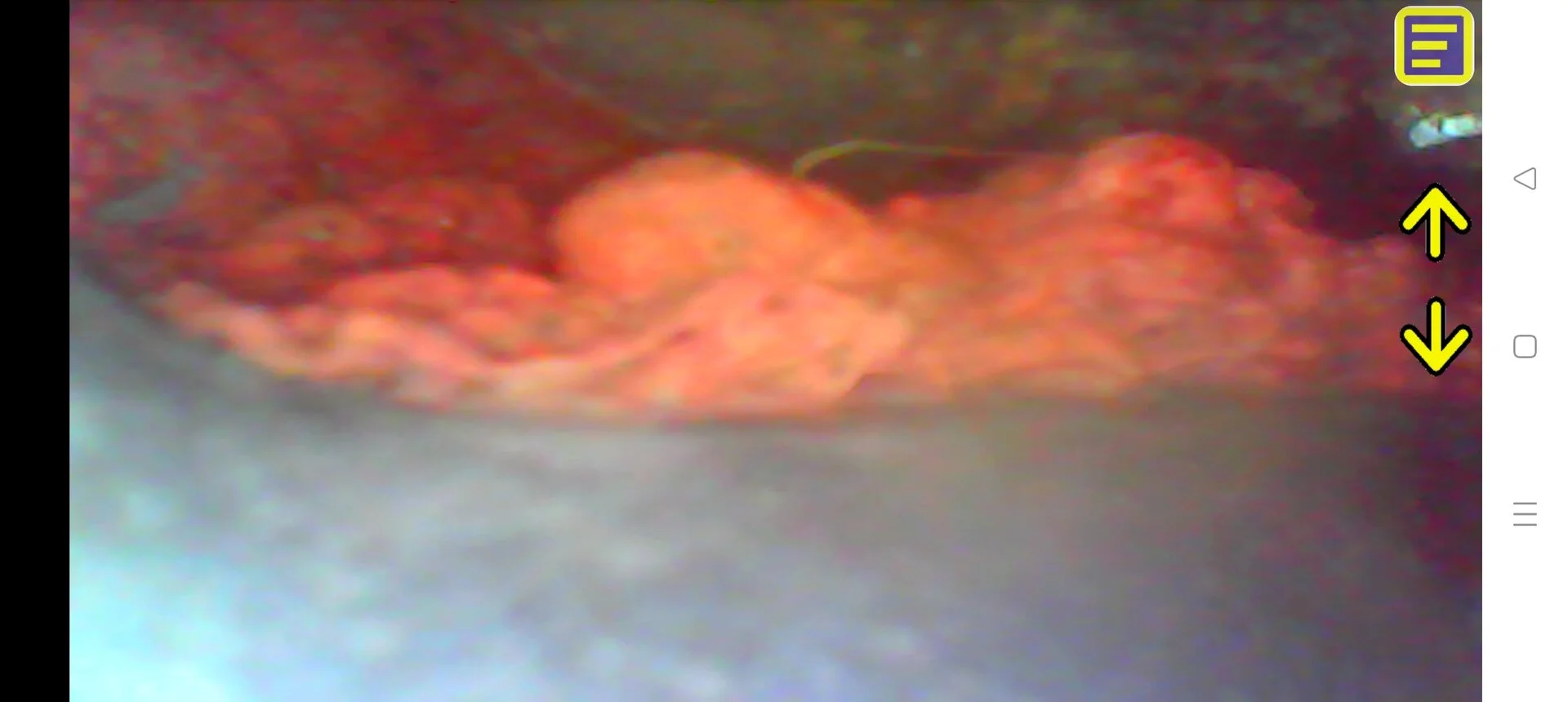

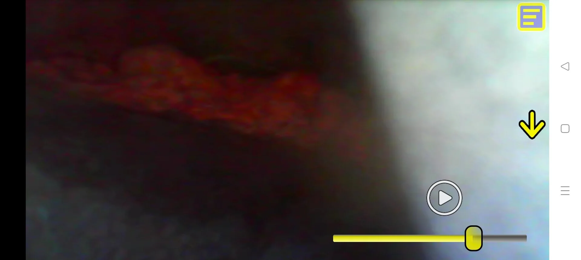

Currently I have it on a lift and I am using a endoscope to take images, I have not found anything yet but anticipate finding something as you guys mentioned. And no I have not seen any actual leaks in the floor or anything. I'll post back with updates today, thank you so much for being apart of the post.

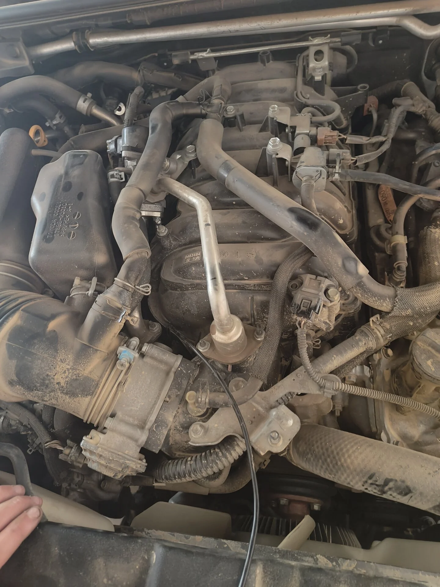

For those of you wanting to know if this could be you, take a endo scope and place it the same area I did and spend a thorough thorough time looking around I spent over 2hrs looking everywhere.
Look I'm the photo to see where I dipped mine down after taking the engine cover off.
