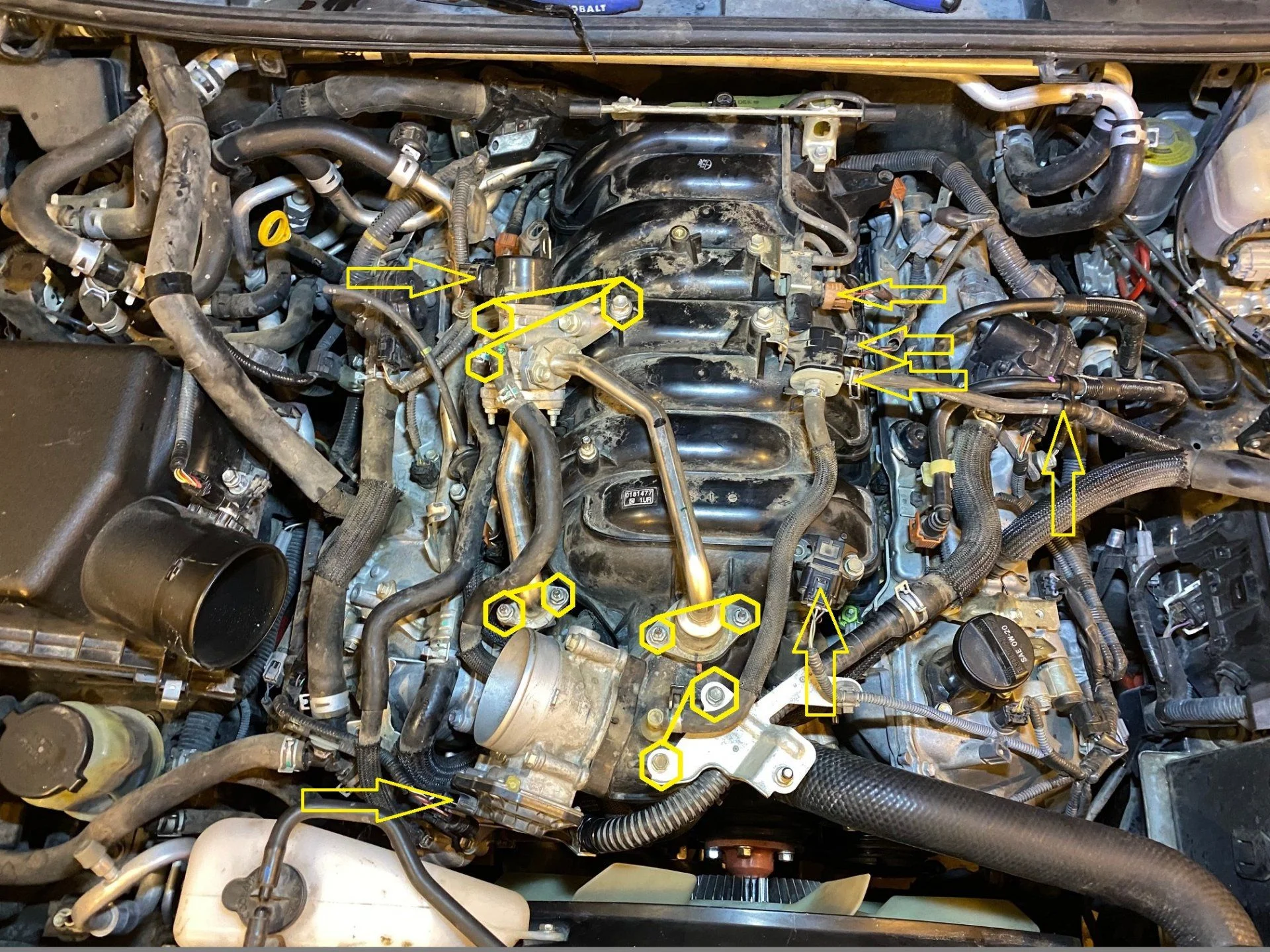

Working on the DIY and am running into the issue where my photos orient themselves as they wish. Example: this one must have been taken with my phone sideways, but even rotating it on my iPhone before emailing it and rotating it once it's on my PC seem to have no effect on the fact that it get's uploaded as an attachment here and is sideways.

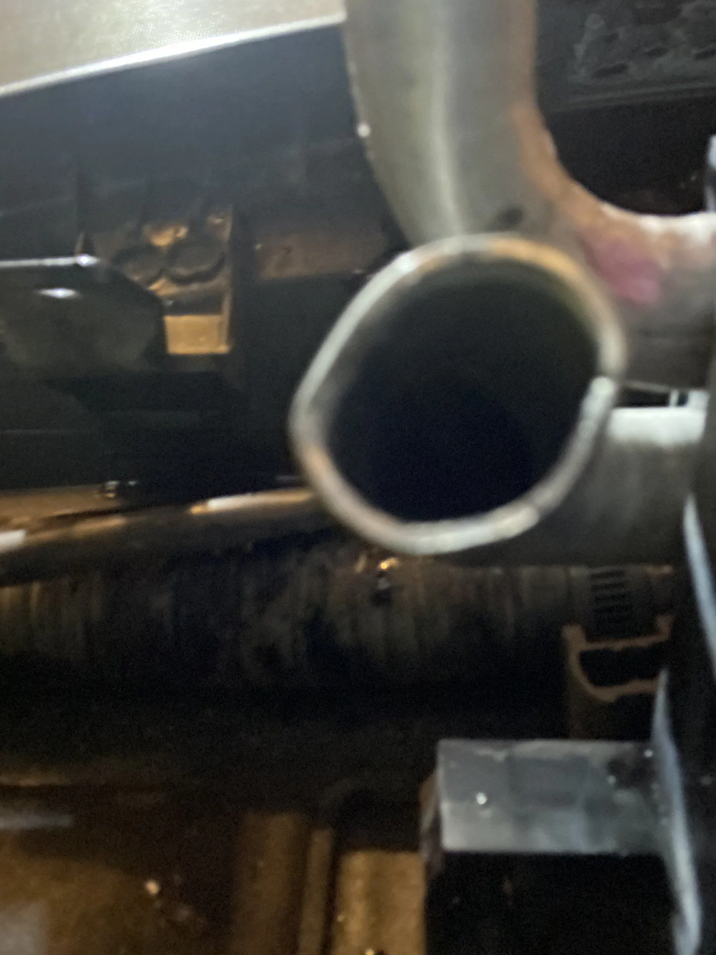

Did you lube the orings on the pipe with something like dc4 grease?
You say it will roll and kink when they are dry hole'd?
Excellent info!
I didn’t lube them with anything other than coolant, probably a good option to, I simply had coolant or a few likely inappropriate lubricant options in the garage, so I stuck to coolant.
Unfortunately, I did try take care to ensure they didn’t go in dry hole’d. I coated the o-rings right up until they went on and even used a coolant wetted finger to run some coolant into the necks where the pipe would be. So O-ring and the surface it slid on we’re all wet with coolant.
I’m guessing my main cause of the kink was two things; a thin layer of coolant wasn’t the worlds best lubricant and the way I connected the pipe to the valley plate first, before stabbing it into the block neck, meant I fought with some weird angles and tweaked the tube a good bit making it all line up. Naturally, some of the jerkiness of install was due to being nervous about getting it perfect in one go.
The second time, I placed the tube into the block first, then joined the valley plate to it and turned the tube a bit to make sure the o-rings settled into their groves before resting the valley plate down where it needs to go.

- noticed a coolant leak that was smoking on the headers on my way home yesterday and found I had wallered up the hard heater line that runs along the firewall just below the cowl and the end connection to the rubber hose wasn’t sealing well. Fixed that by running some needle nose pliers into the end of the pipe rotating it around until the pipe was round again. Is wallered out just a Texas phrase? My wife had quite a laugh at me saying the pipe end was wallered out.

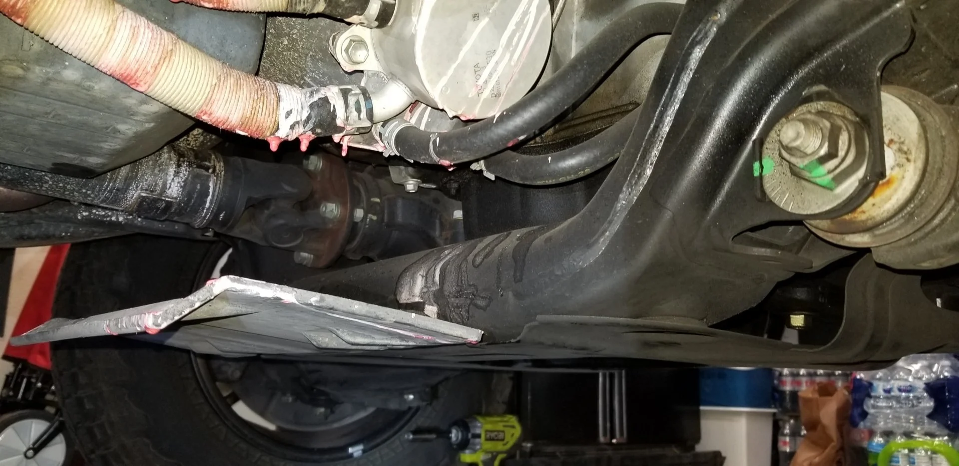

I think it's my turn :( wasn't like this a few weeks ago when I was doing a brake bleed. Changed the oil this morning and saw this... Gonna have the shop do this one due to time constraints, road trip to Texas in 5 days. Anything else to do while they're in there? 167k on truck. no history of water pump replacement at Lexus. Do it?
Bummer man, that definitely looks like the valley pan leak.
Only maintenance items that can be done, with no extra labor charge, are PCV Valve replacement and Coolant drain/fill.
The water pump and such doesn’t come off for the repair, but the coolant system is open/drained, so it might save you a few bucks overall on coolant costs if you want to tackle it at the same time.
