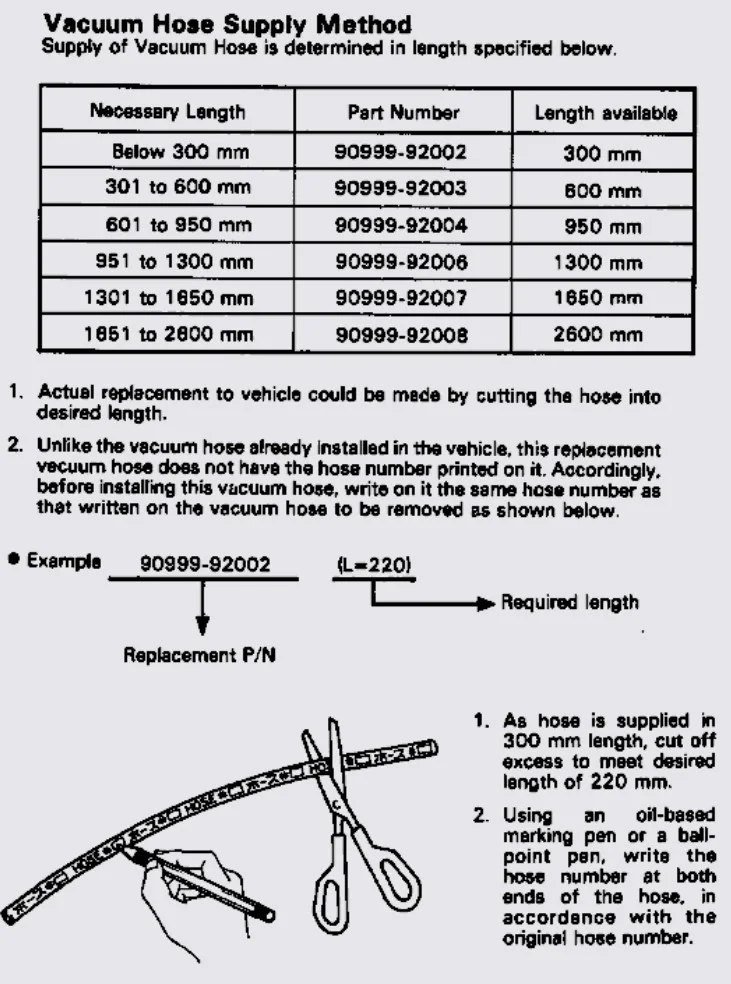

You can find this overview & instruction in the EPC just ordered a bunch of these
