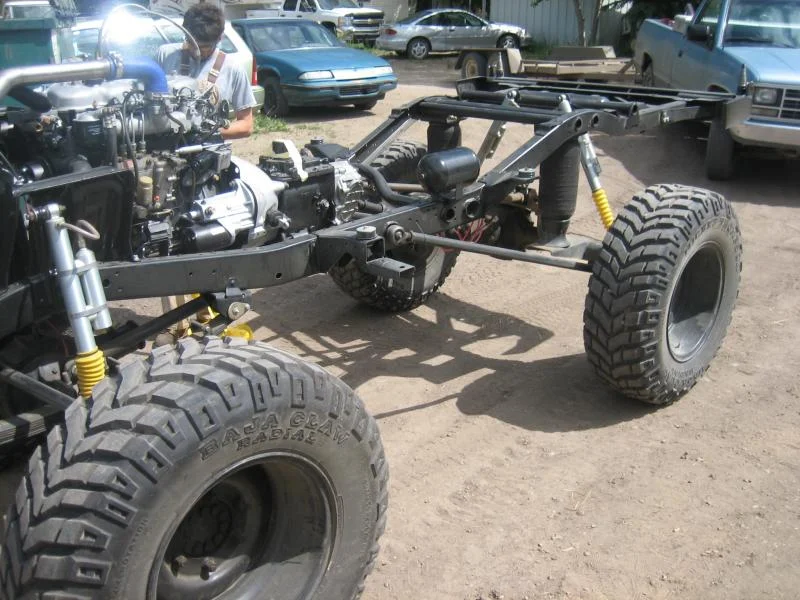

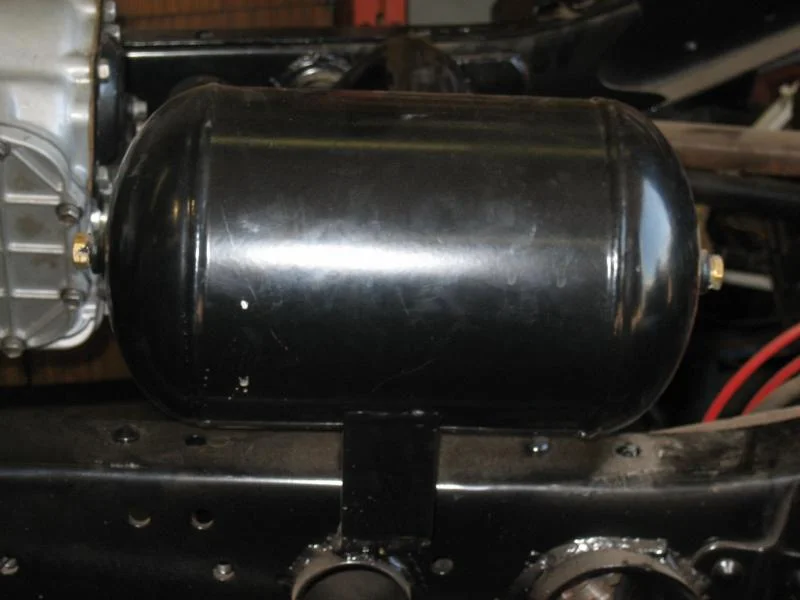

What about a VIAR 1 gallon air tank?
This works perfectly for the BJ46 that this frame is from.
It's nice to have some extra vacuum. I like this idea. To the OP, if it is in the way of your sliders, put it somewhere else, like up higher in the engine bay. Just don't forget the check valve.

I think it took me a couple of hours to make one. Are the sliders tubing? How about the bumper, can it be used as a vacuum vessel? You maybe able to get a nice little tank from a truck shop that services air brakes. It shouldn't cost an arm and a leg to replace.
Nice idea on the Viar tank. Not too costly I already like the Viar stuff for OBA ( here but not yet installed). The only issue is size and space to fit the tank. I also agree with the other poster on some creative solutions for what to make a tank out of, i.e. use a bumper or other tubes that already on the truck. The only concern I´d have is take care in deciding which tube to use. I would probably shy away from making a tank out of tubing that is going to be making contact with things, e.g. rocks, trees, shopping malls parking lot barriers, etc. i would not want to run over a rock with my sliders and have a sharp edge rupture the vacum tank.:cheers:
