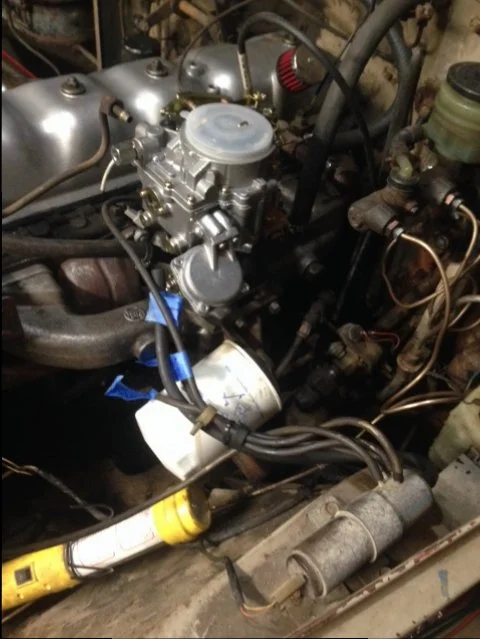

Bottom right.
This is my 11/69 rig which has a vacuum retard dizzy when I was replacing the carb (ended up being a fuel pump issue.) The original carb and VSV are in a box, dizzy soon to join them as I switch to vac advance.
