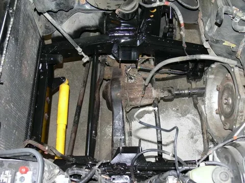

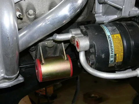

Pics of my A/C hose challenges and Engine compartment paint job. I am cuttinng up the Toyota and Gm a/c hoses and tig welding them together to make a adapted hose. I will be putting the motor back in and starting the final assembly. I have a lot to do and test before CMCC 06.

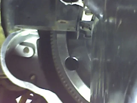

I took the motor in an out 2 more times doing final fit up's. I discovered that the access hole to get the torque convertor bolts in and tight sucks. I choose to machine 6 holes in the flywheel to be able to install and properly tighten each bolt. This worked out great. I am having my doubts about the adapter. Marks omitted a few key bolts from the original mounting pattern b/c the interference with the holden pattern ( the adapter can accept a chevy or holden engine.) I will find out soon if they have enough bolts between the adapter and the tranny.

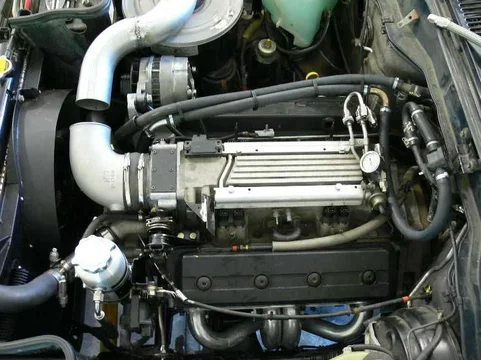

Well it finally runs. After chasing my tail a bit yesterday I found that painless wiring did not have a tach filter in place which took the thunder out of my spark. Today I snipped the tach wire and she started right up.
It is really loud in my garage now, perhaps too loud. She has the typical SBC rumble! One leak to fix up at the heater piping. The power steering feels sweet! I modified the stock corvette pump before install. I ported it for more flow and added some shims to increase the operating pressure. She moves in forward and reverse, dont know about shifts yet.
I am having a fuel supply problem and need ideas from you guys out there with supra fuel pumps etc. Clownmidget, Gary, Jowett, Cdan etc please chime in! With the motor not running I turn the key and the fuel pump primes to about 34psi as it should. When the motor starts the fuel pressure drops off to about 10psi then bounces back and forth. It will not maintain a steady 34 psi like I need it to even at idle. The stock toyota pump should have no issues making this engine idle. I will need a supra pump for WOT operation. My guess is the fuel pump resistor is fouling it all up? I might make it go bye tomorrow. Also, I have a supra pump pn# about how much is it?

I would guess that what is happening at idle is related to the resistor. An easy test would be to connect a jumper lead from 12v to fuel pump +. I have left the resistor off by accident before and the truck would start right up, then die after a few seconds.
