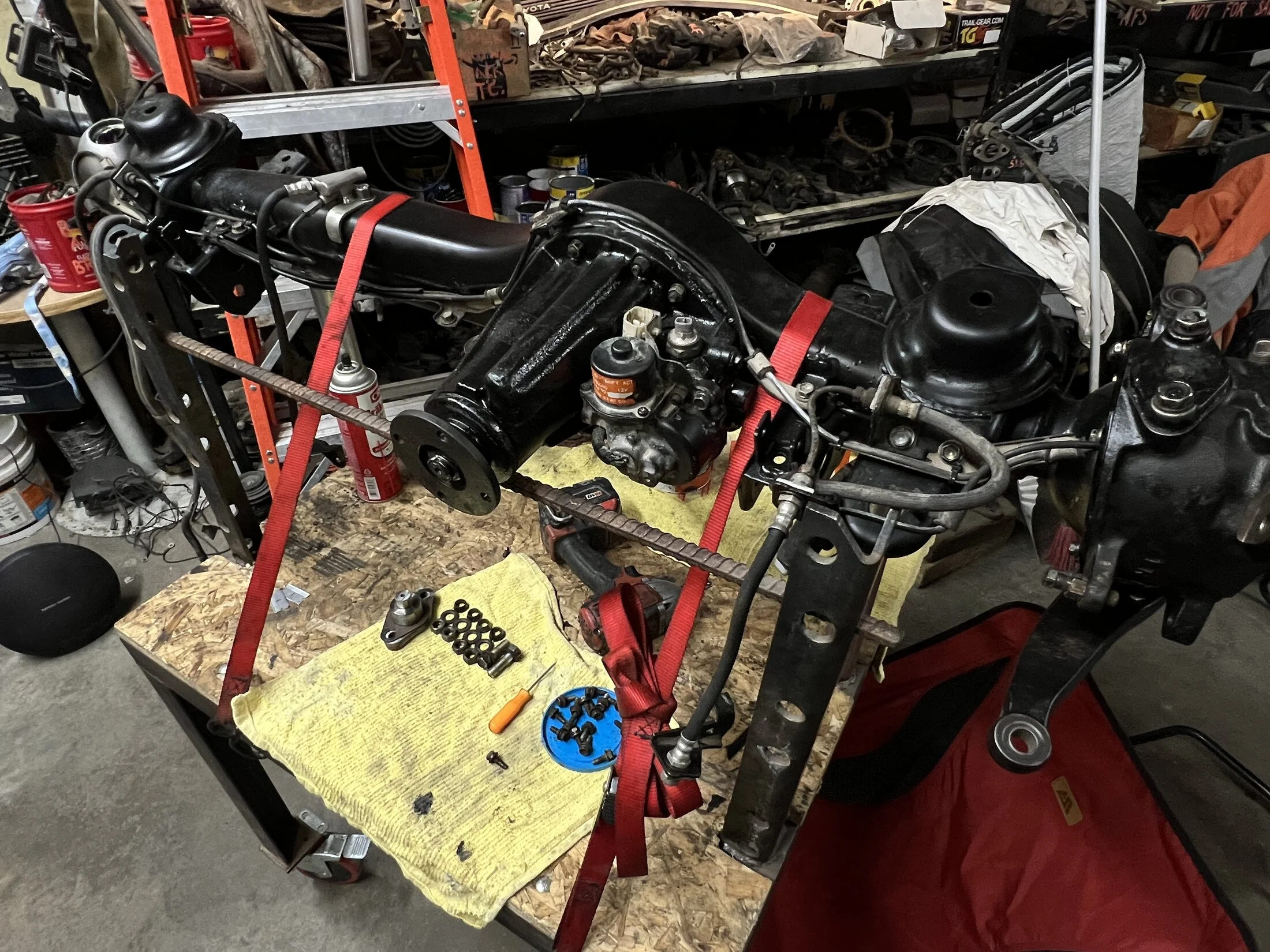

Here is the current state of the front axle. Once they are mounted in I will get some pictures of the completed install/conversion and will answer any questions I can
