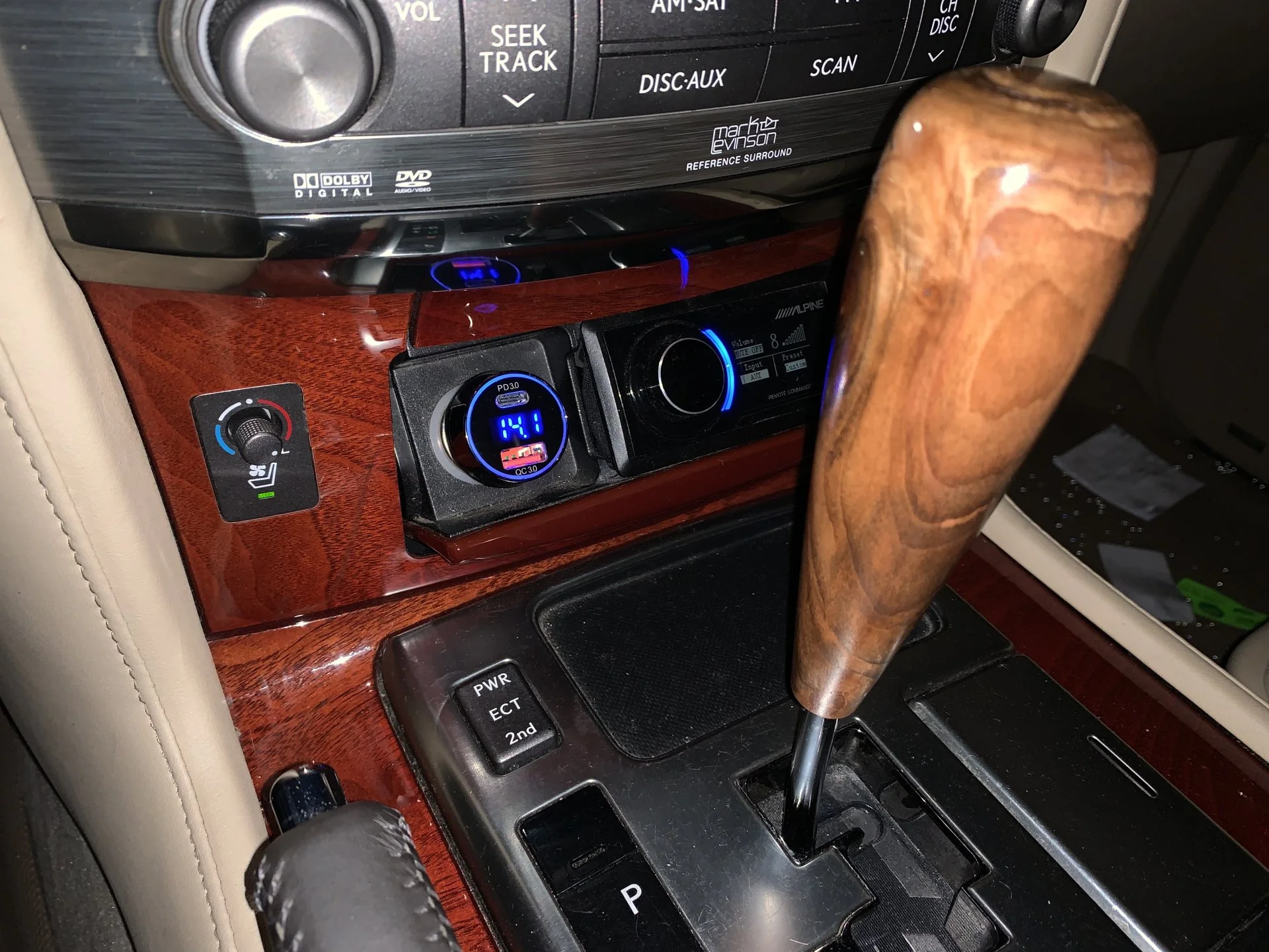

I’m also using a cig plug usb. This one just allows the door to shut. Bonus shows the battery voltage.
Usbc and usba

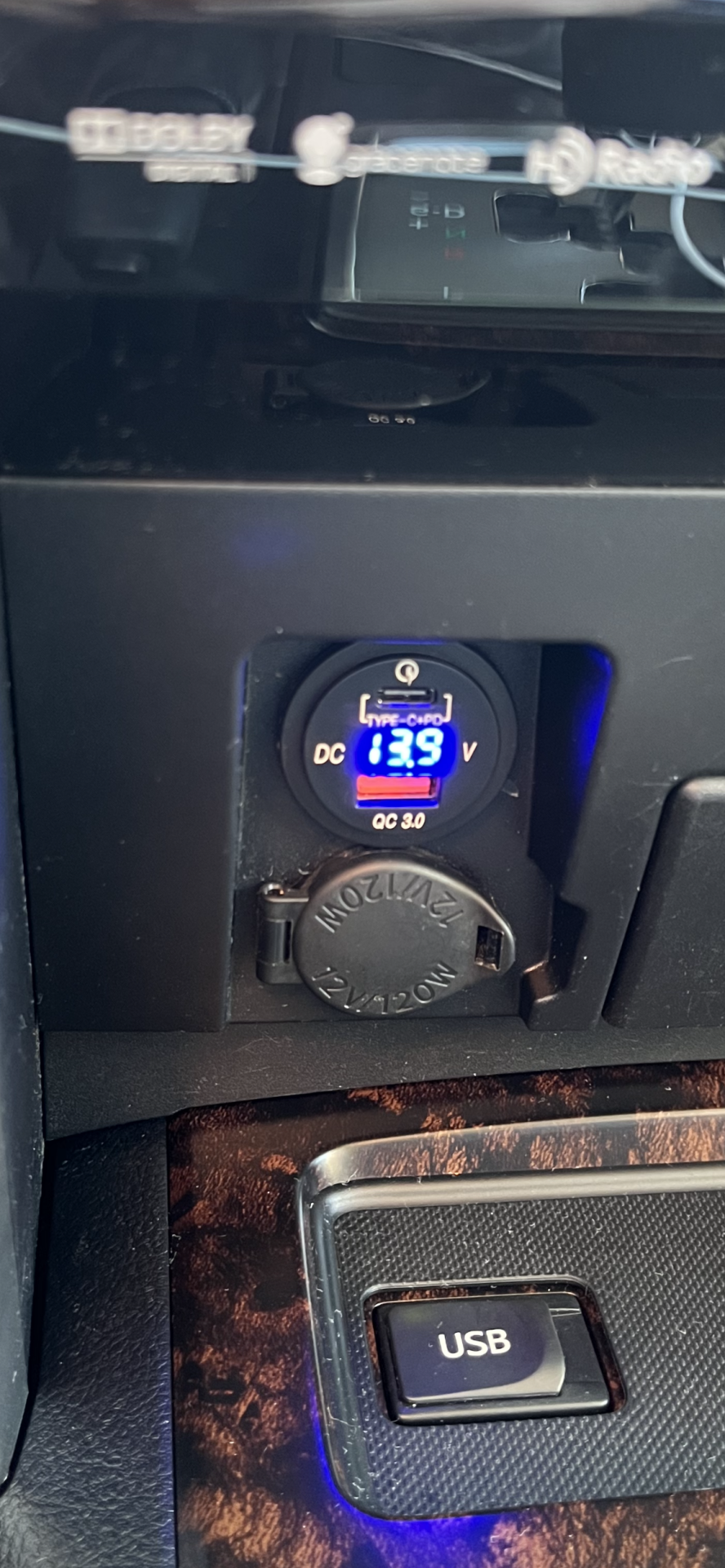

Installed the hardwired usb-c in the cigarette lighter this weekend. Pretty easy job with a clean result.
A few steps:
- remove the leather knee pads from driver and passenger side
- remove one screw on each side
- pull off the silver trim piece
- pull out the cigarette lighter/12v/ashtray module
- disconnect all power connectors
- the cigarette lighter took some work to get out, I ended up having to destroy the white piece that holds the light and keeps everything secured
- widen the hole with a dremel
- install charger
- clip off the old power connector, strip wire, install spade connectors and then plug onto new charger
- put everything back together. I left the light connected but it’s just hanging behind the module.

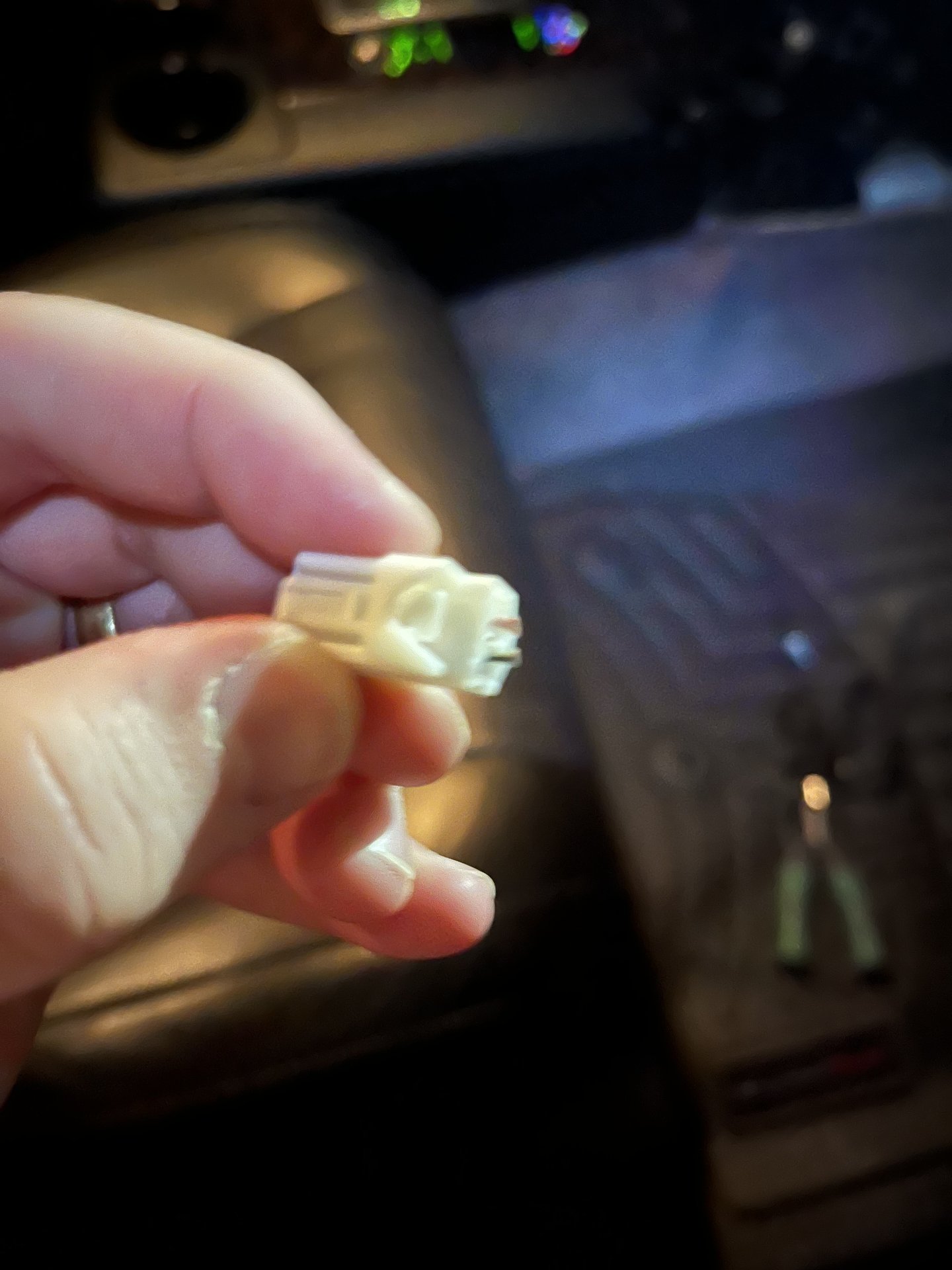

I didn’t get a pic of end product but I just cut off the factory connector (pic below), stripped the two wires, and crimped on spade connectors (came with my usb charger). The spade connectors attach to the two prongs of the usb charger.
Thank you, is there a + - or does it matter?
