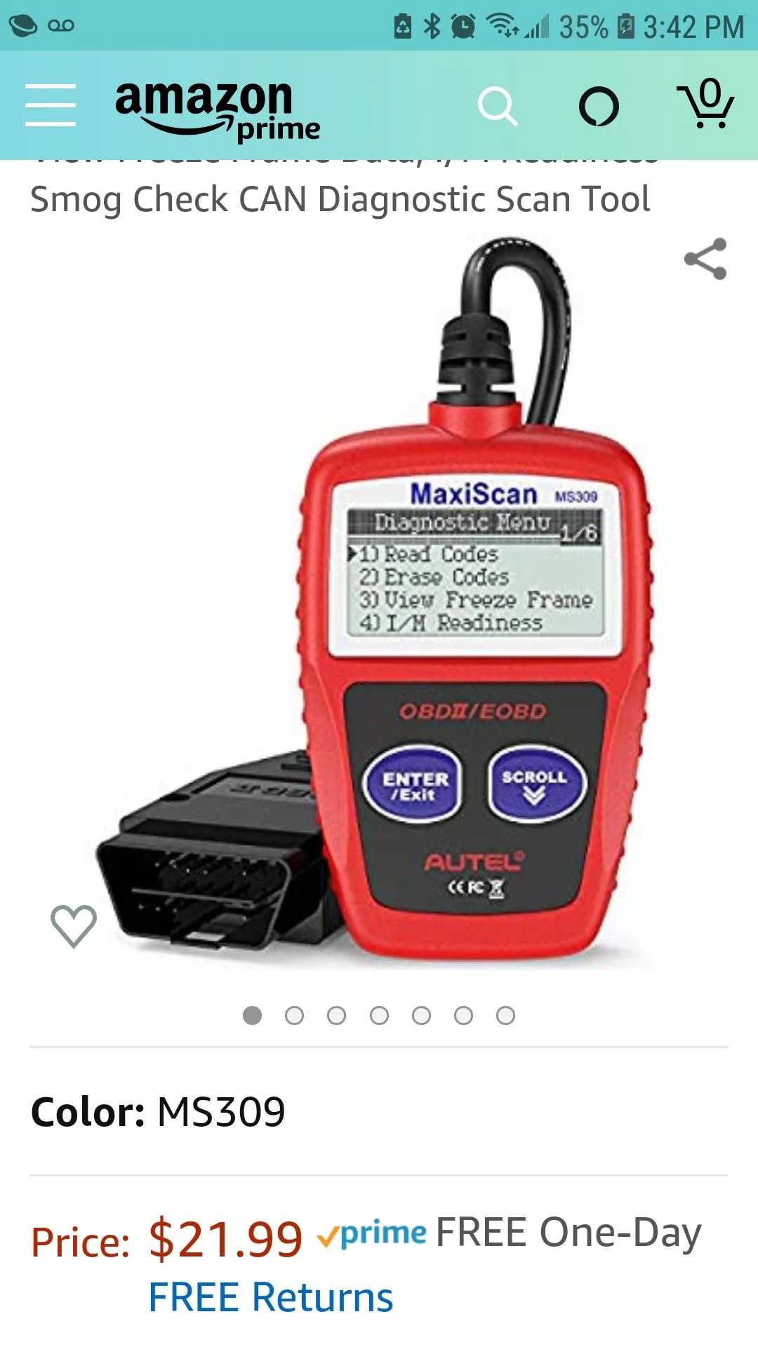

Got a code reader and I had a cylinder 6 misfire. Replaced the coil and it runs great but still needs extra cranks when warm.
