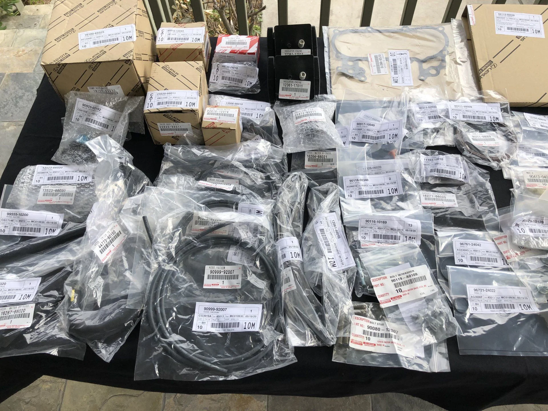

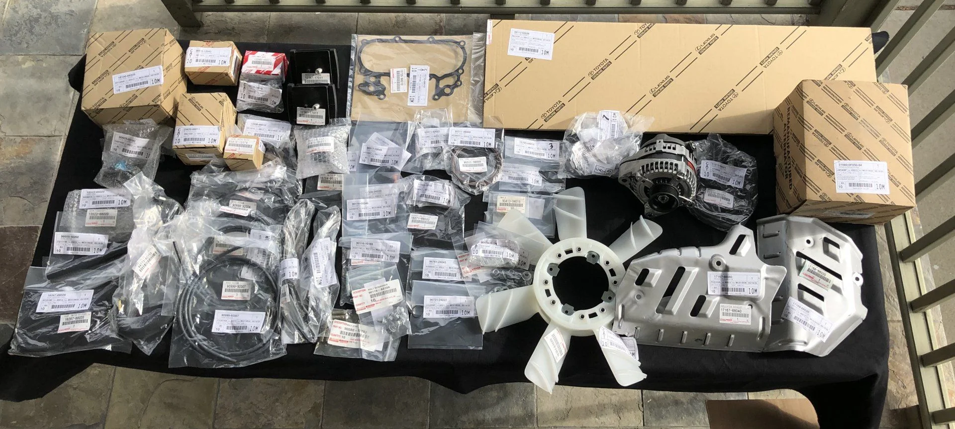

Got most of the bulk of the parts in. Just waiting for the Cometic MLX HG to come it. My 2weeks is turning into more like 4.
I tried to send out parts to different vendors to multitask in hopes to save time. But we know how that goes 😂

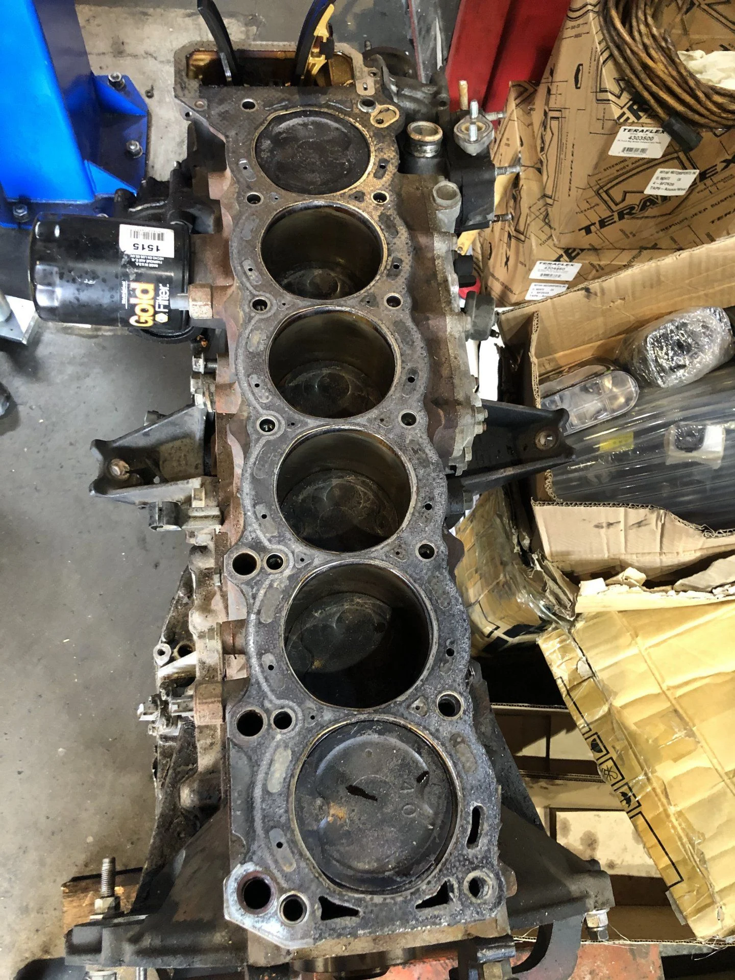

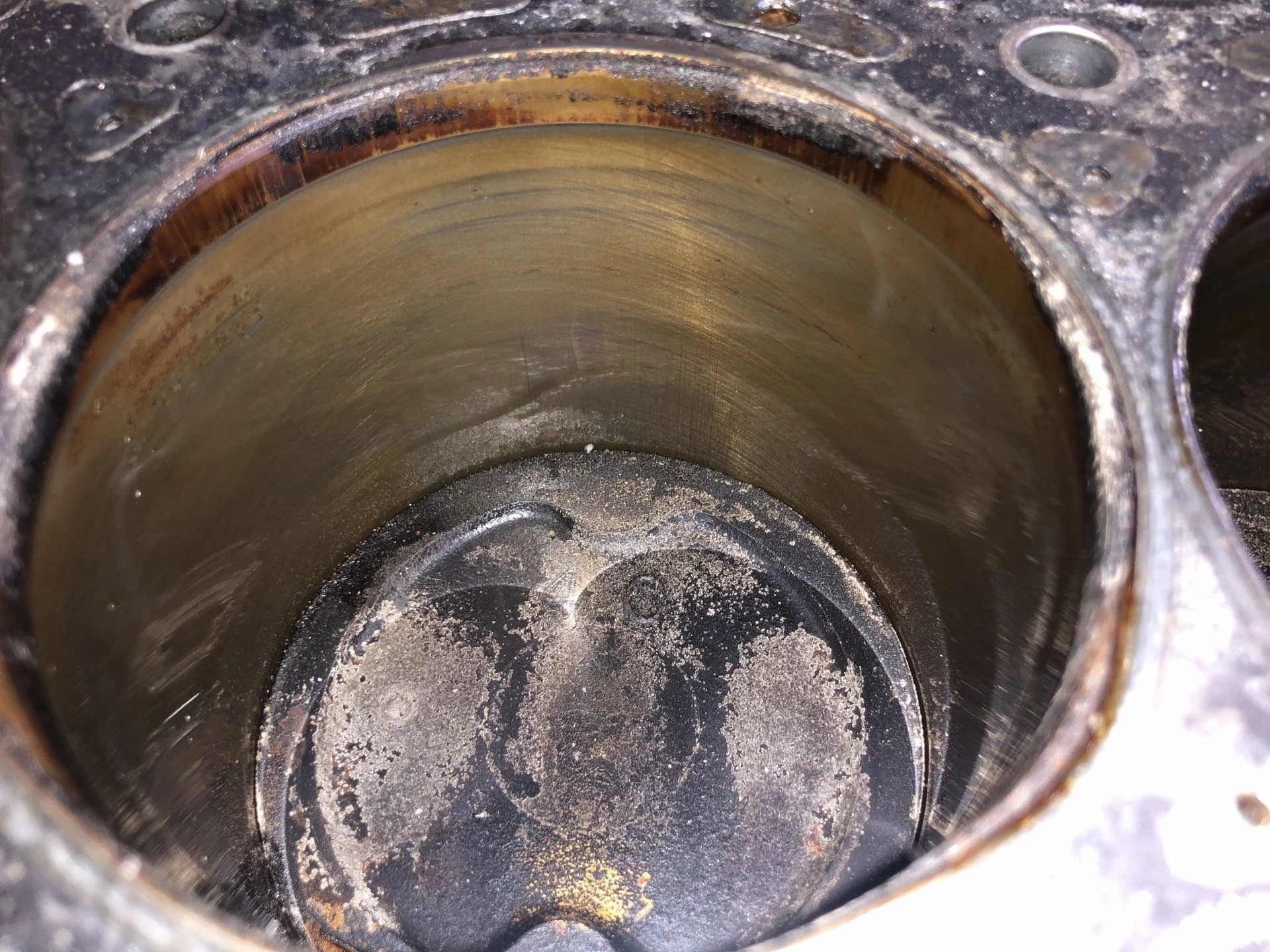

Compression good all across, and crosshatching still visible.

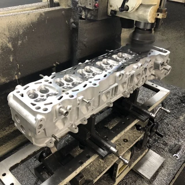

If you plan to use the MLX , you will need to have the block deck finished to a Ra 30-50 per their recommendation.If you plan to use that block with the deck in that condition, the Toyota head gasket would be a safer choice for proper sealing. If the used head is within spec for flatness, it may be able to be refinished to a similar Ra without removing too much material.
Thanks for the heads up and good looking out. Head was straight, will further inspect the block next week.

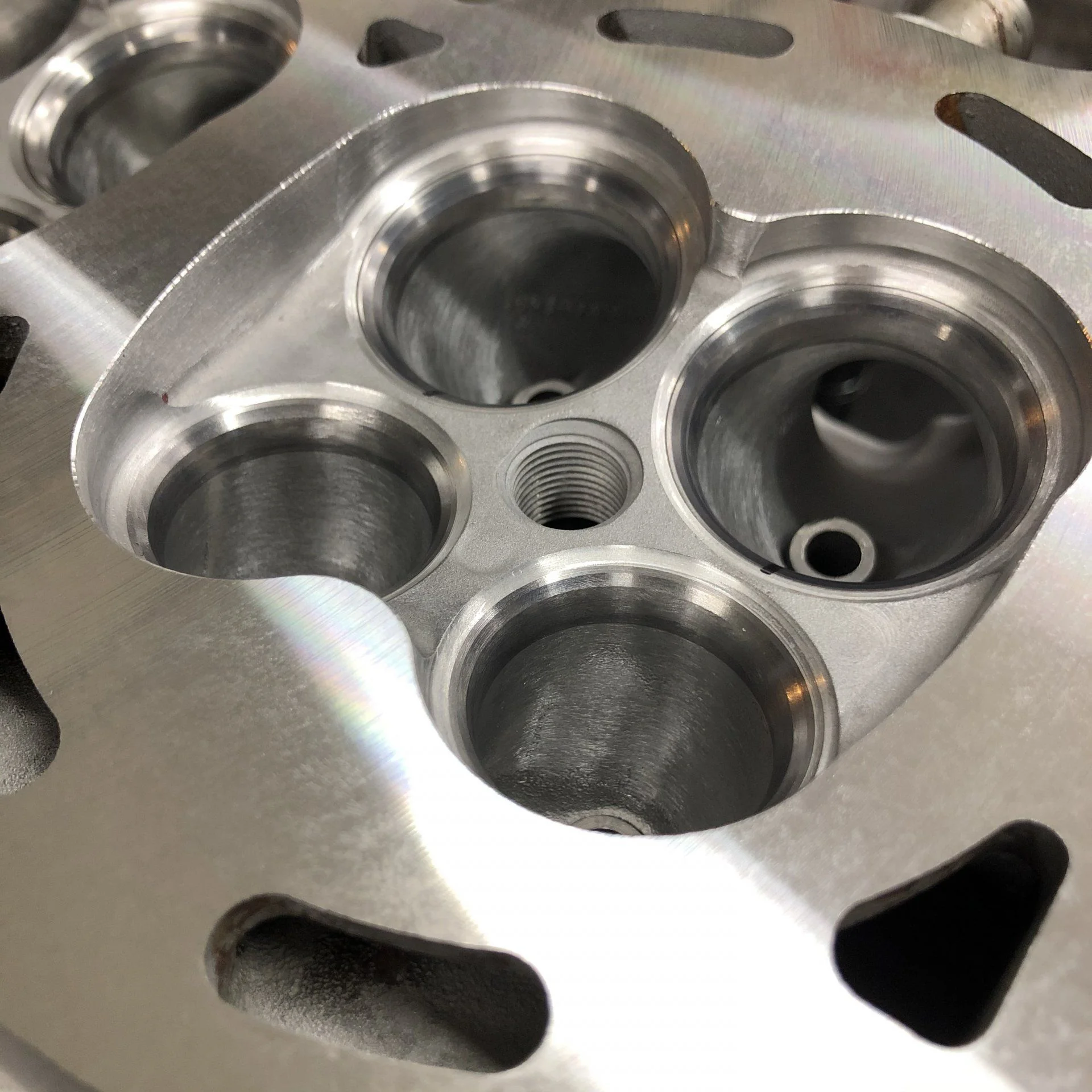

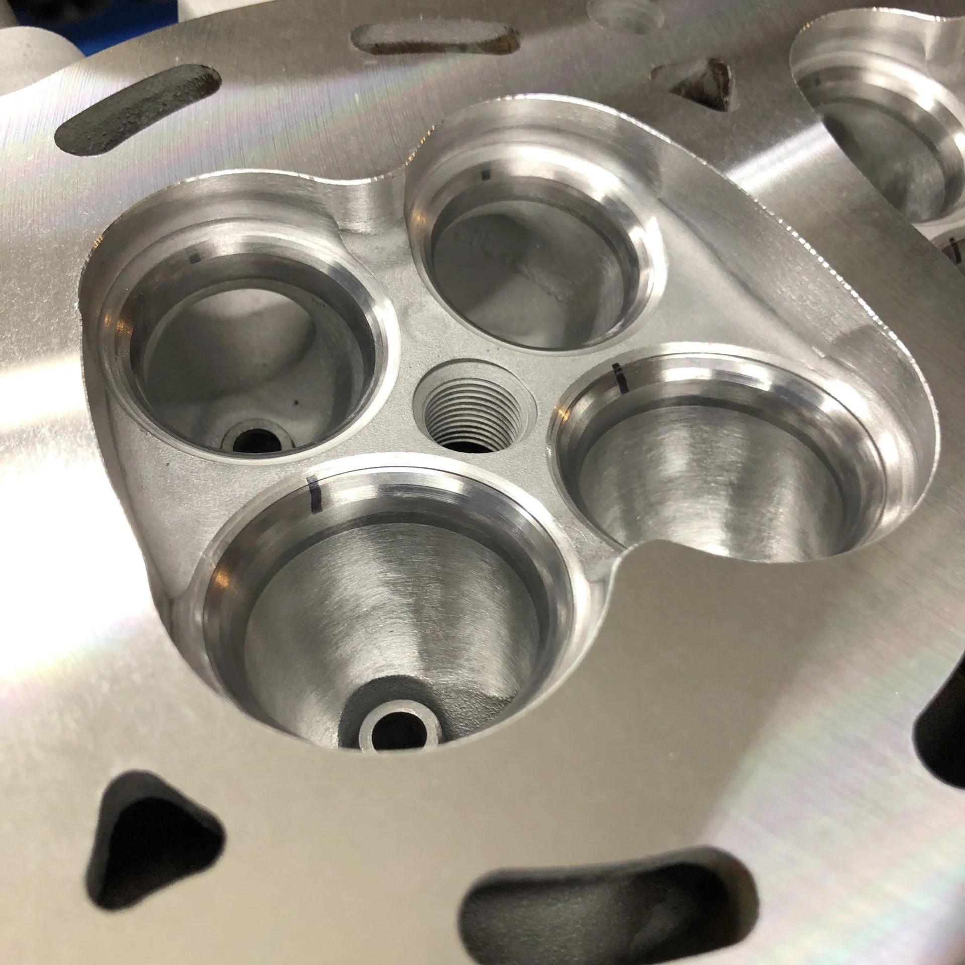

May as well have the head port and polished too.
Thought about that but mostly went with short side radiusing work as well as some bowl work. I think anything more with my cam profile might be really throwing money away. What I should have done was get a FI 200 with 3.0 kings and call it a day. I realized over the years I don't like stacking rocks like I thought I did, lol.

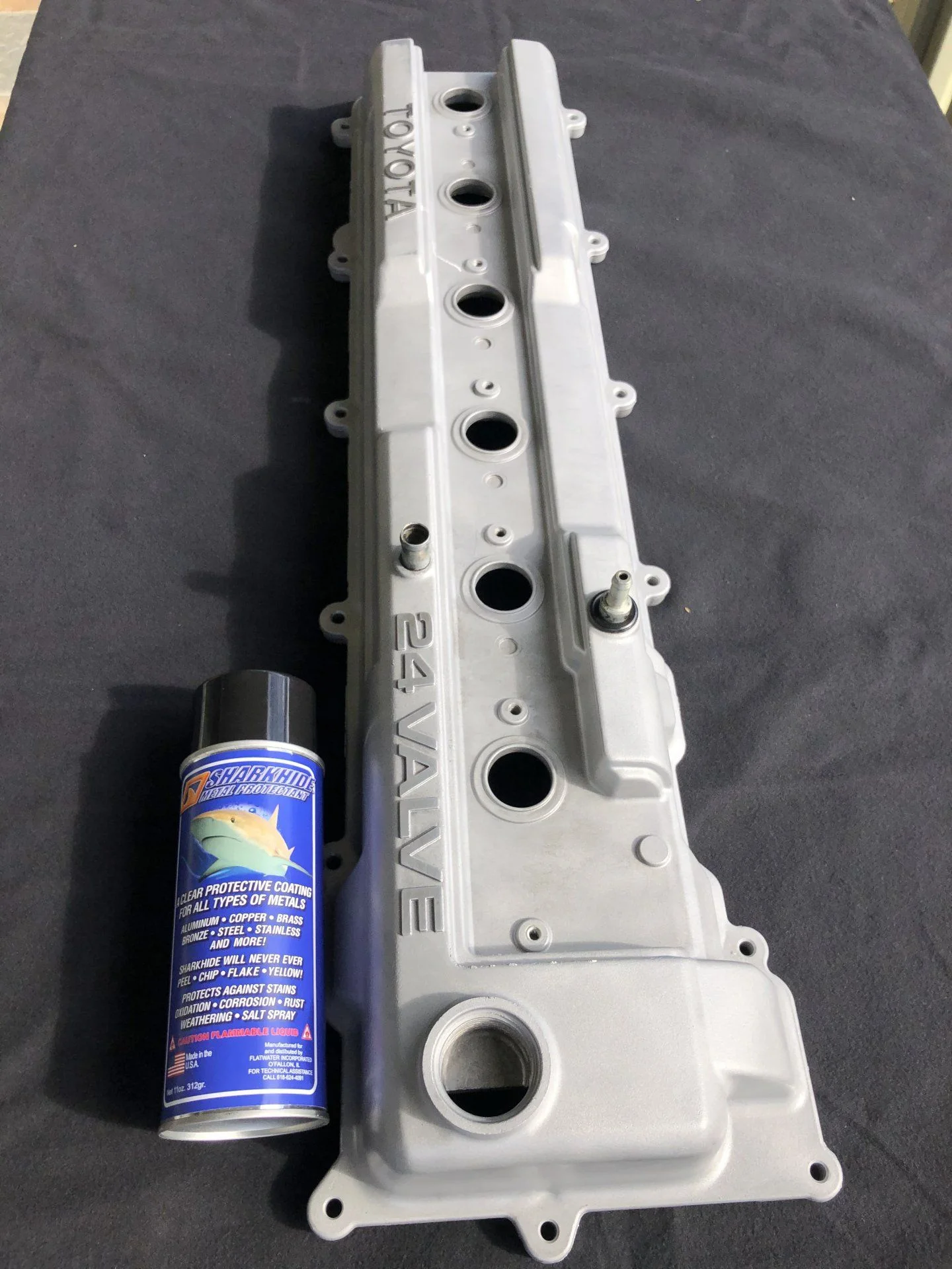

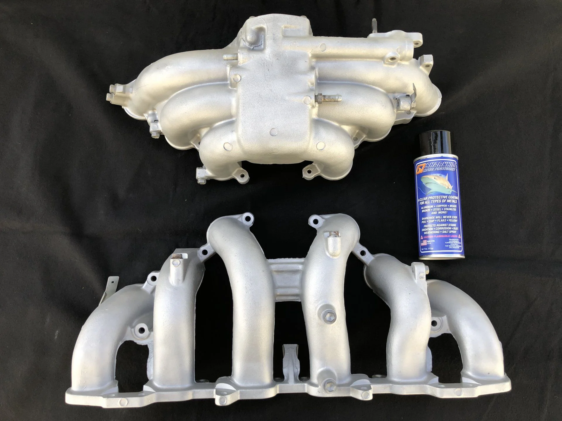

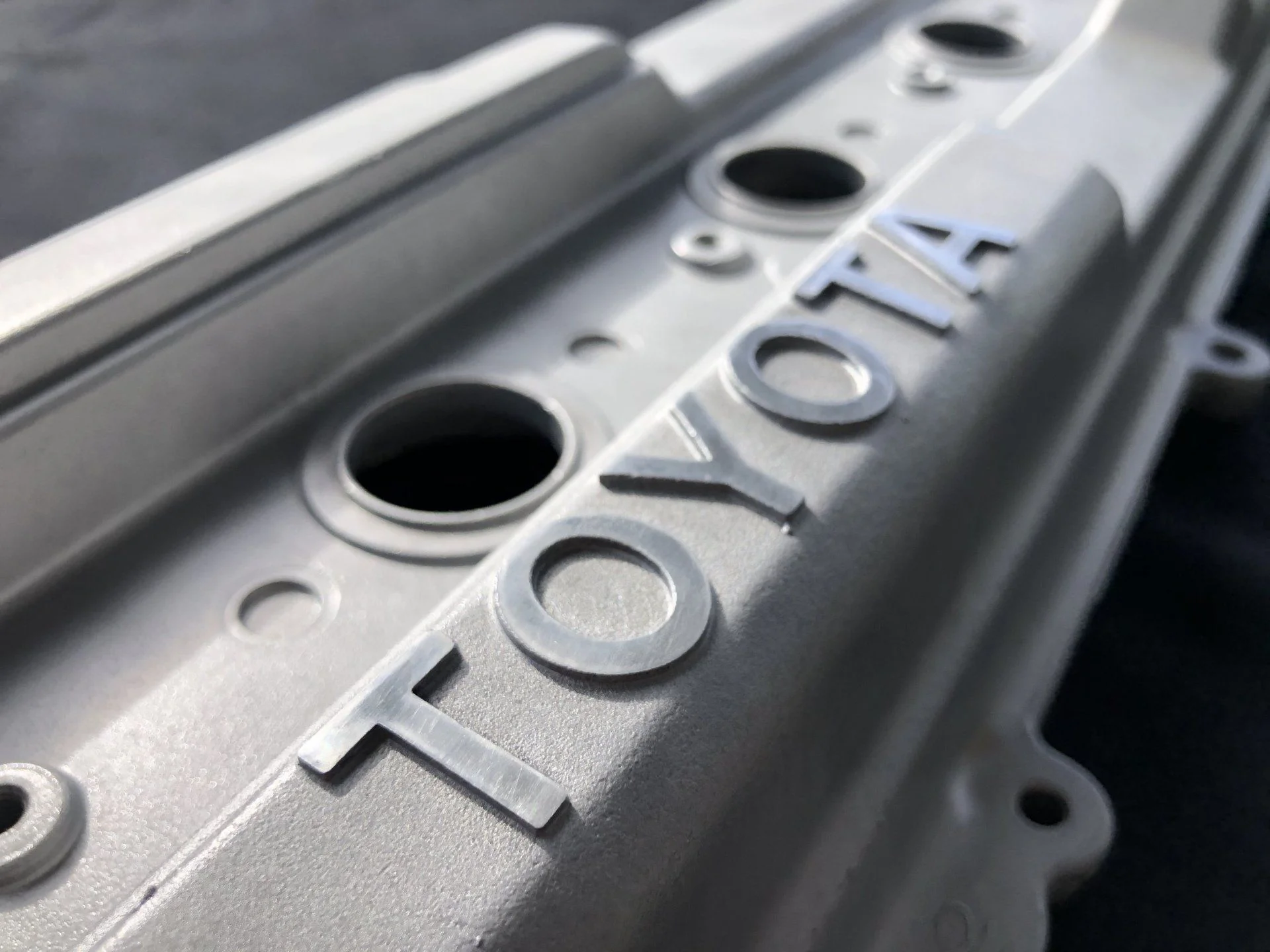

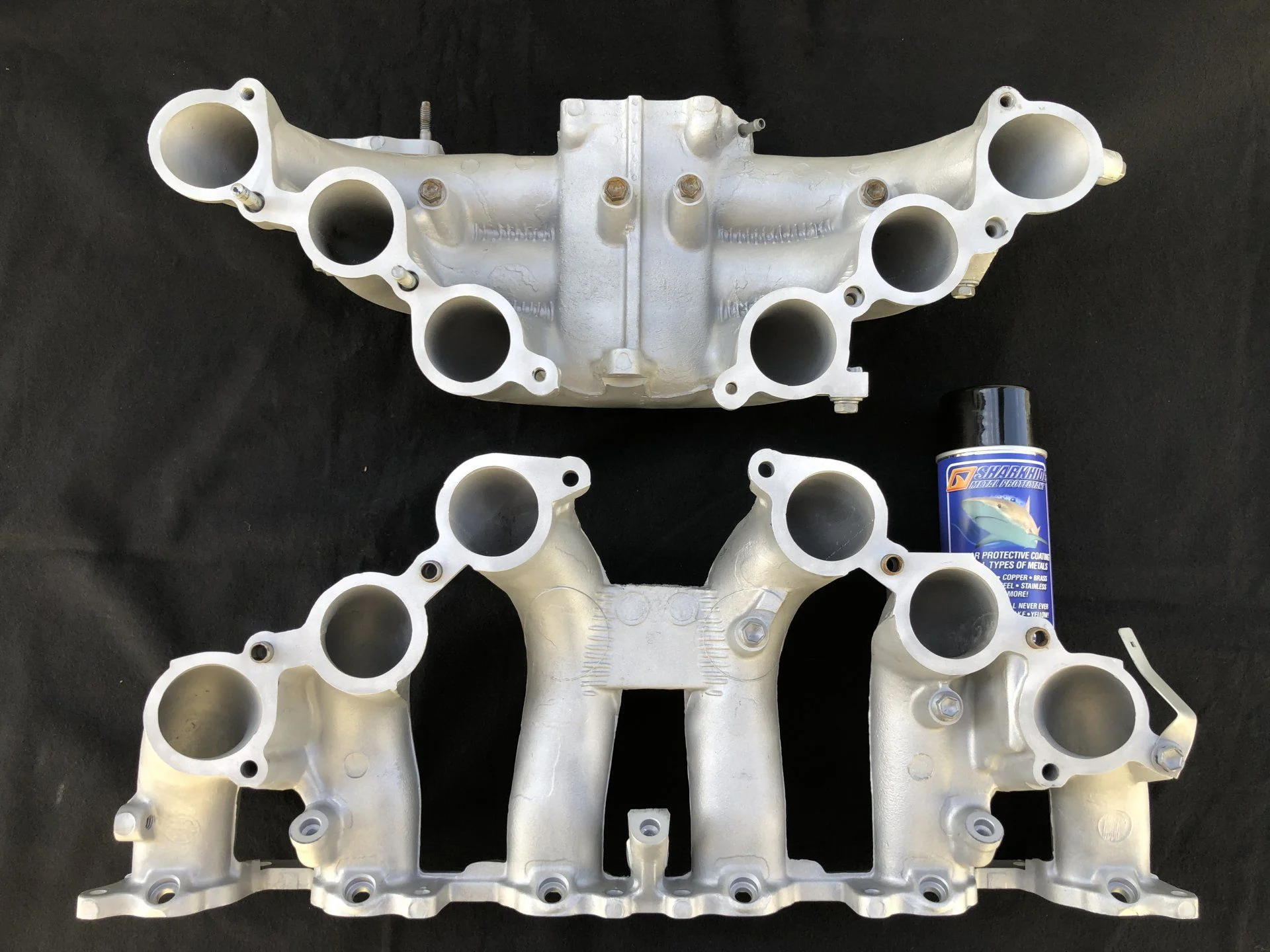

While waiting to get the head and cam specs finalized. Made some time to hit the valve cover and intake manifold. Couldn't decide on how to finish the valve cover. I've seen a lot of nice looking powder coated valve covers from other members. However, I wanted something that was going hold up it's looks and take an occasional blast of break clean here and there. I've had great results before with type III hard ano, but my finishers didn't want to touch cast AL so that idea was out. Plus I didn't really feel like drilling out the fasteners on the baffle. SO, had the pieces blasted for a natural look.
First time experimenting with Sharkhide. I guess quite a few people use it on their AL boats to keep em' fresher for a while. Not sure how it'll do on an engine. I guess time will tell...

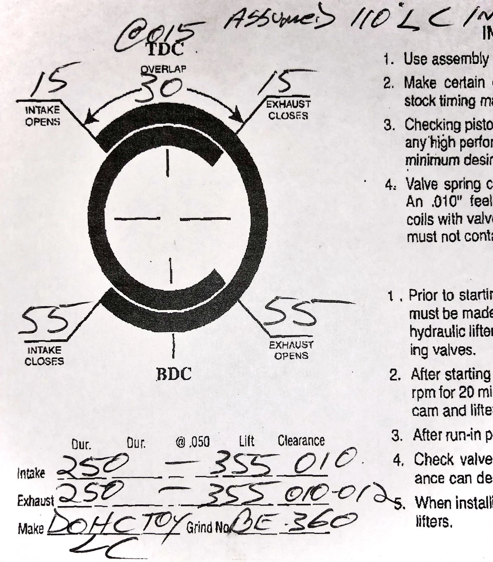

I'd wait until the motor is up and running. To my knowledge there hasn't been anyone on mud that has installed and documented a mild cam upgrade with the stock ecu yet. I'm sure there has to have been, just not documented. I've earnestly searched for a couple years, perhaps my search fu sux. Got tired of waiting and almost wussed out by going the safe stock route. I guess I'll be the guinea pig 😂
Can you advise stock cam specs as well as the new cam specs?

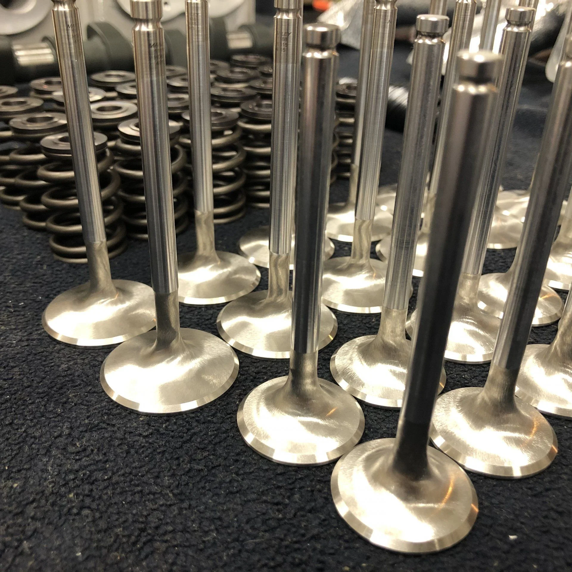

I believe your talking about Thetoyotaman here on mud. Fine gentleman, had some important obligations to attend to, so his project had to take a little hiatus. He was going with Schneider cams and Manley valves. I went with the same valves but just +1.5mm dished on both sides. I was going to go with the same cam profile from Schneider but went with a grind that Steves Machine had suggested. The Schneider grind was a 248F. Supposedly it was/is popular in the UAE for their stock division class. In what race, IDK. Would love to find out.
My question to Schneider and others cam mfgs here and abroad was, would it be to much for the stock ecu. I either got no response or IDK.

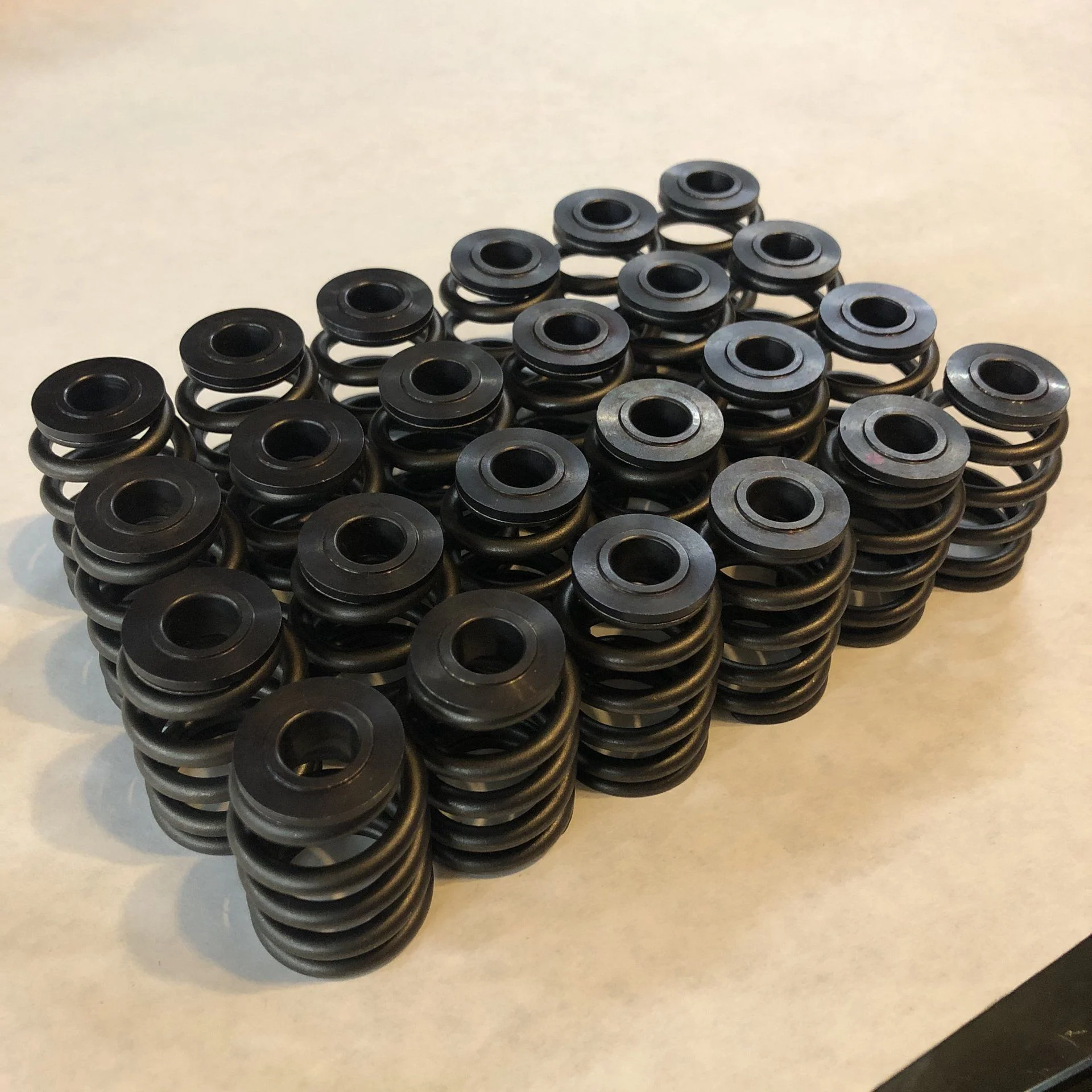

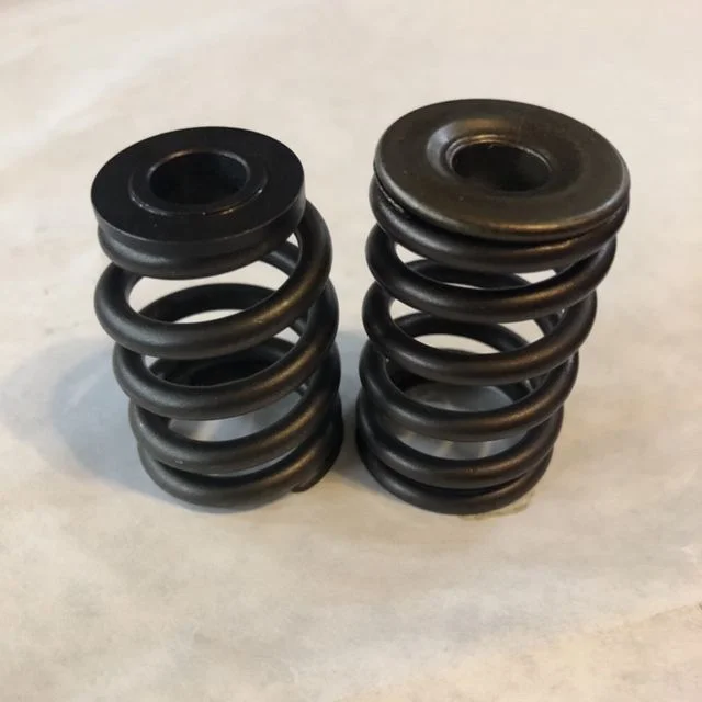

I forgot to mention that my valvetrain weight was shaved almost 40-50%. I didn't know this was going to happen but my head builder swapped out my stock lifters to Nissan GTR lifters. Will have to take some pics and measurements.
Hmmmm. Curious what you mean by ‘lifters’ when we’ve got overhead cams ? ? Direct lobe impingement on the valve(or rather the shim/bucket or whatever you want to call it). But I like how you’re running ovate beehive springs. I’m also wanting to go that route. Weight reduction is usually a good thing.
