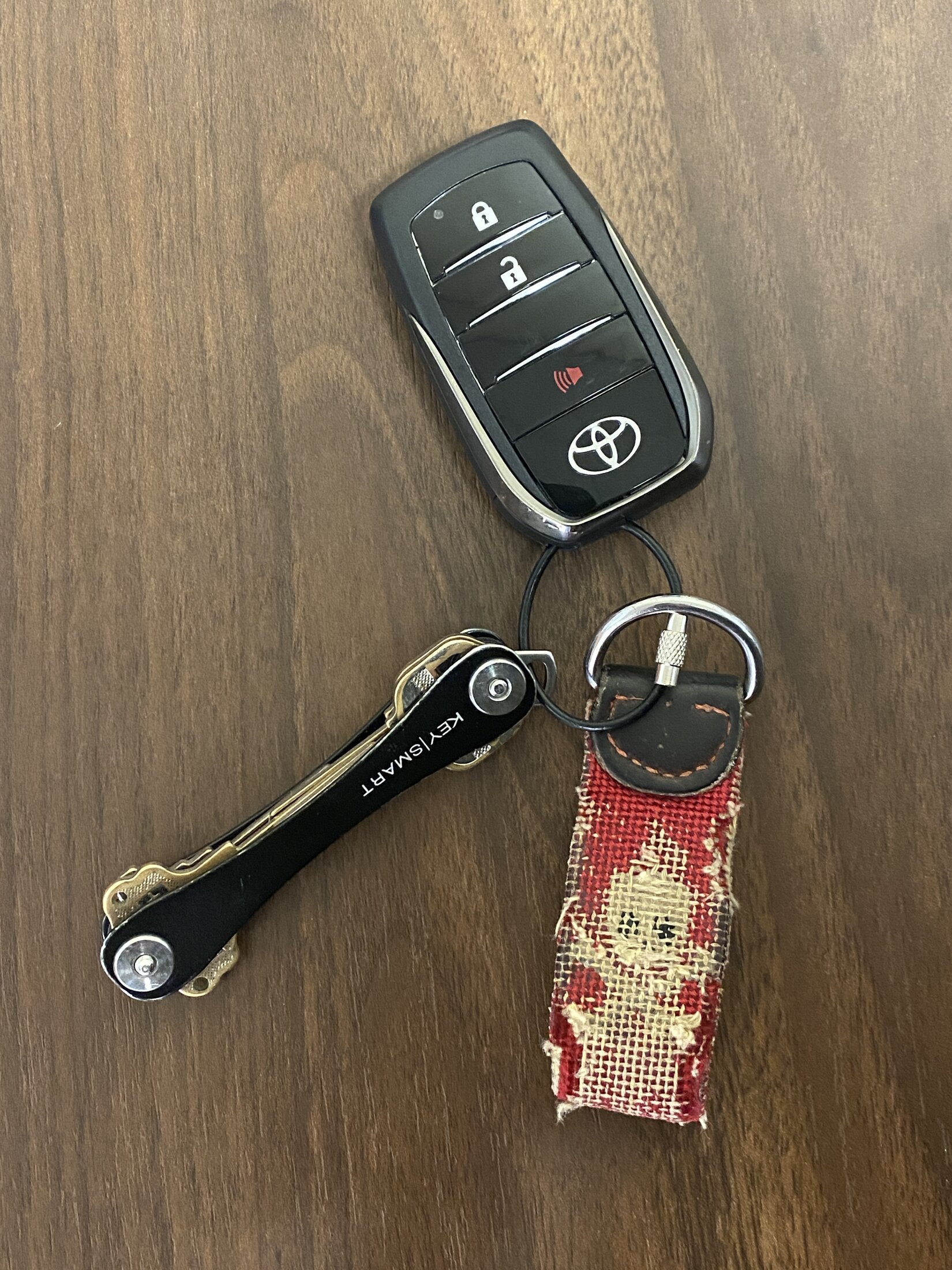

Here's another option.
$14 + shipping on Aliexpress. 😂. Came with a blank key blade that I had Ace Hardware cut for me. They cut it well enough to turn one way but not the other. It’s still a functional back-up/glove box option.

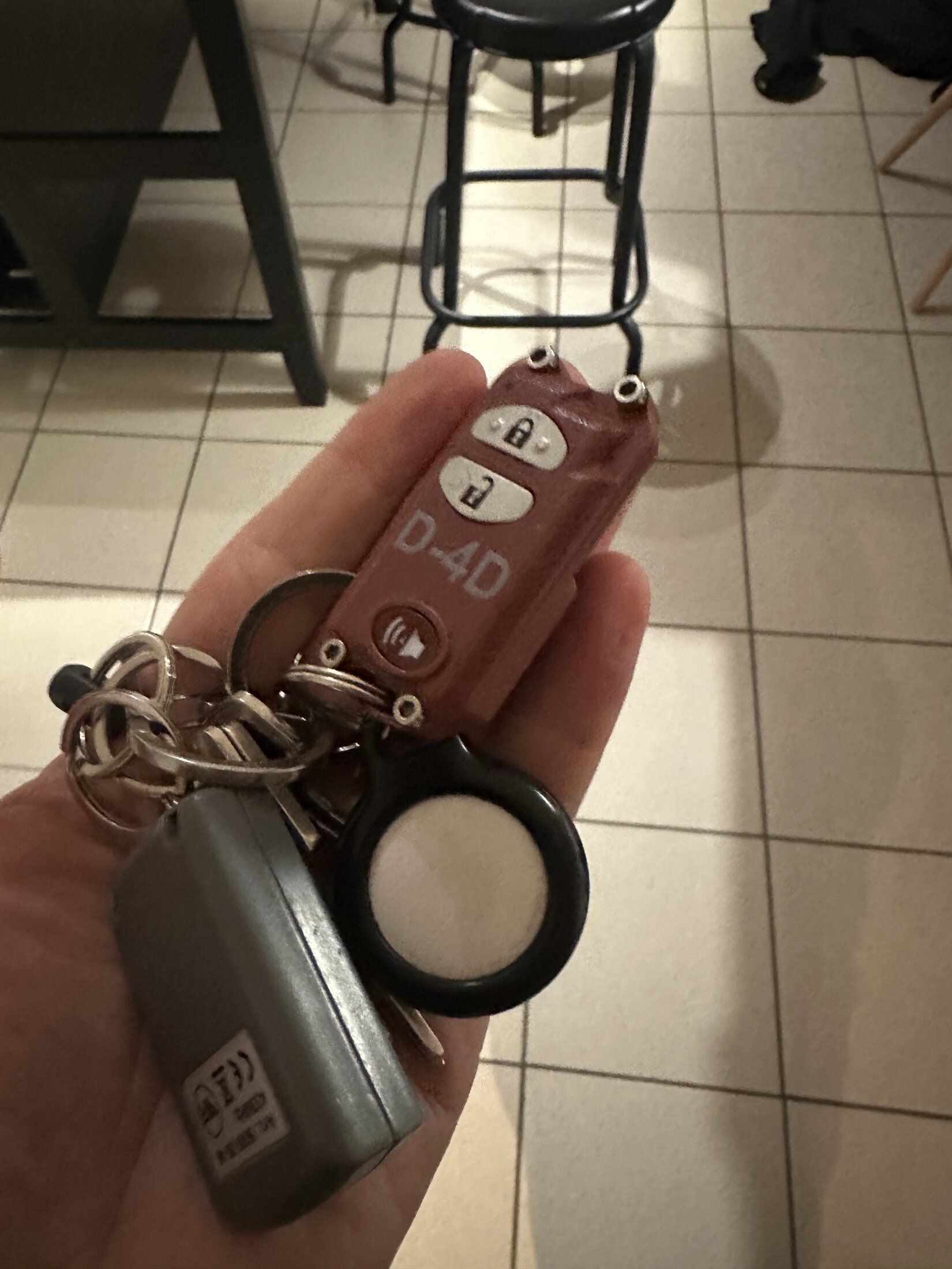

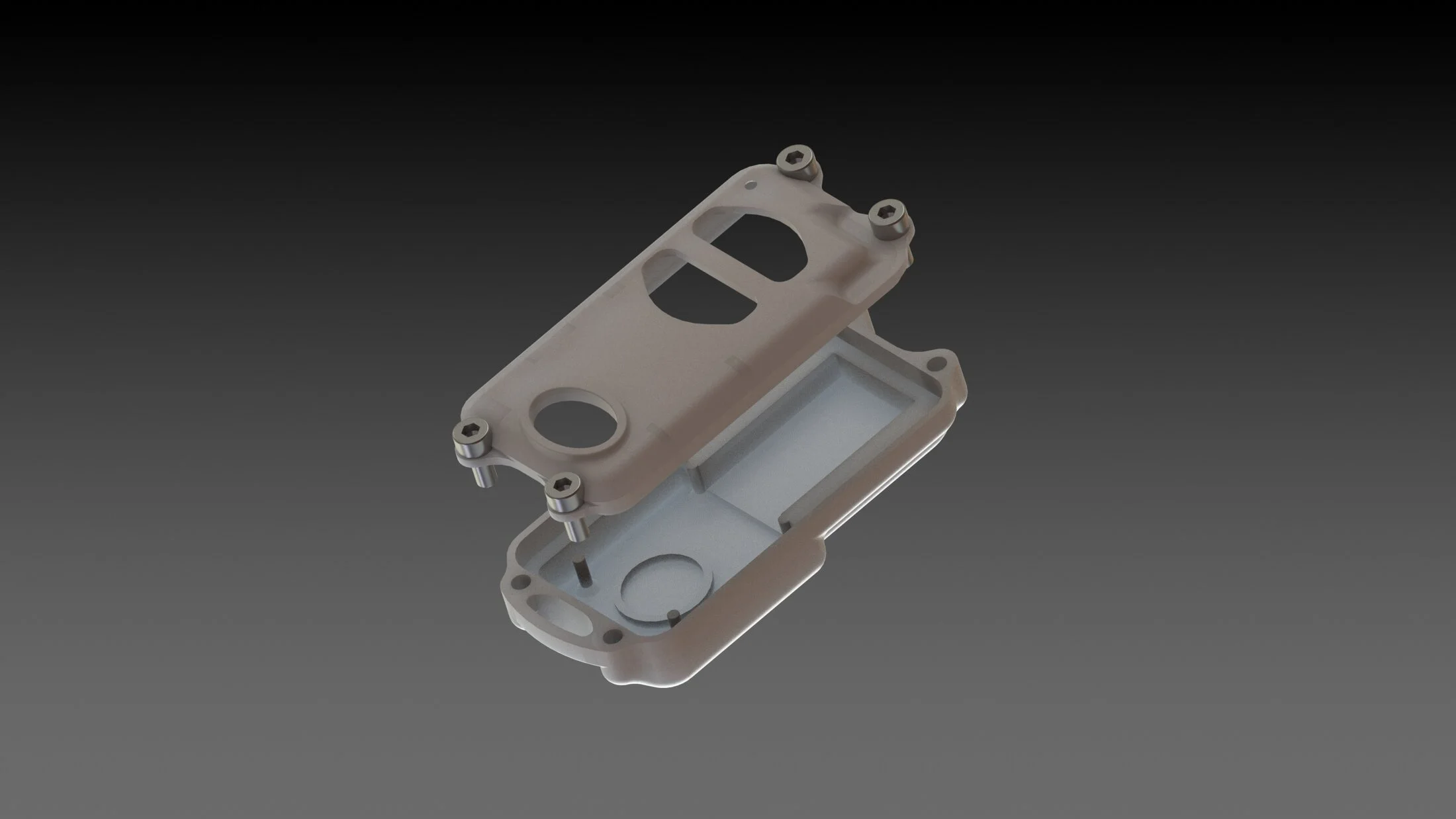

3D print it yourself is also an option. Made it out of PLA-CF and since more than a year it does its job flawlessly

Do you have a .STL file for this? I just picked up a Bambu A1, I'll give it a try.
Sorry for the late reply. Here is a folder with the SolidWorks data and step files (you can import step as well in Bambu Studio or other slicers - with btw better quality than stl) LC200_key_shell - Google Drive - https://drive.google.com/drive/folders/1dCoDFW8aq_DmxT6NoOBojDgpVryL7Y0C?usp=sharing
The screws I used ared M2.5 x 6mm and if you got the AMS for your Bambu I would recommend using some support material (like petg for pla and the other way around) to remove the supports with more ease.
