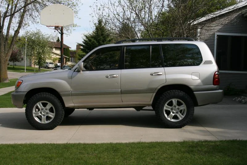

I like my 18s, and considering the fact that I do 90% of my driving on road with the other 10% being forest service roads, etc, I think the sidewall height is a non-issue for me.
attachment.php
Dang Brock, those look really nice! Are those wheels off an 03+ LX?
Will the Yota caps fit the LX wheels?
Hell if I know...the previous owner put them on and I bought a 5th one here for the spare to make them all same since I do 5 tire rotations...Here is info tag

The LC or LX 18s can be used with their respective caps regardless of model 100.
