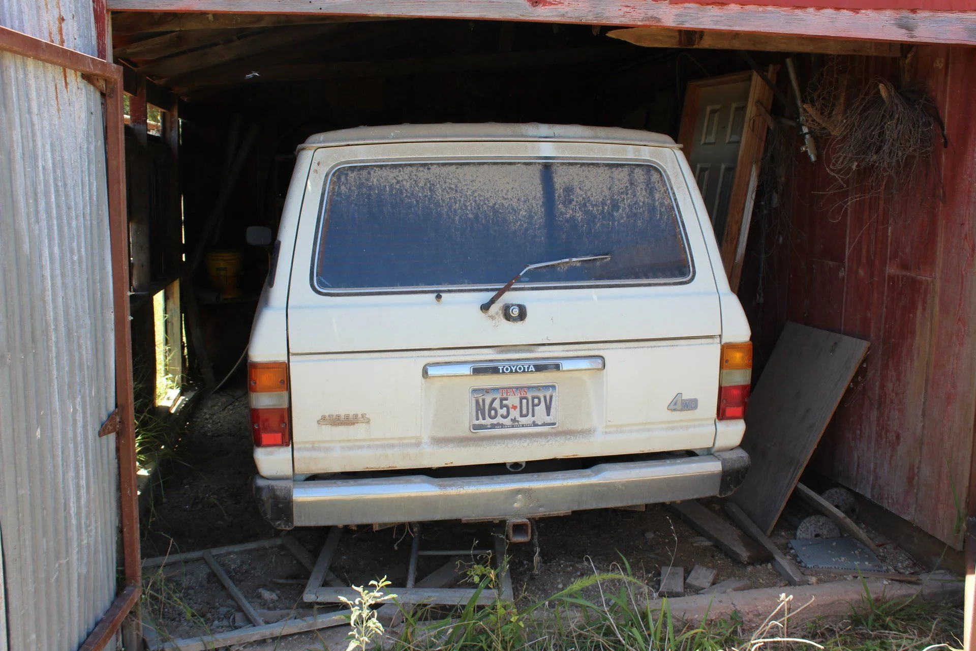

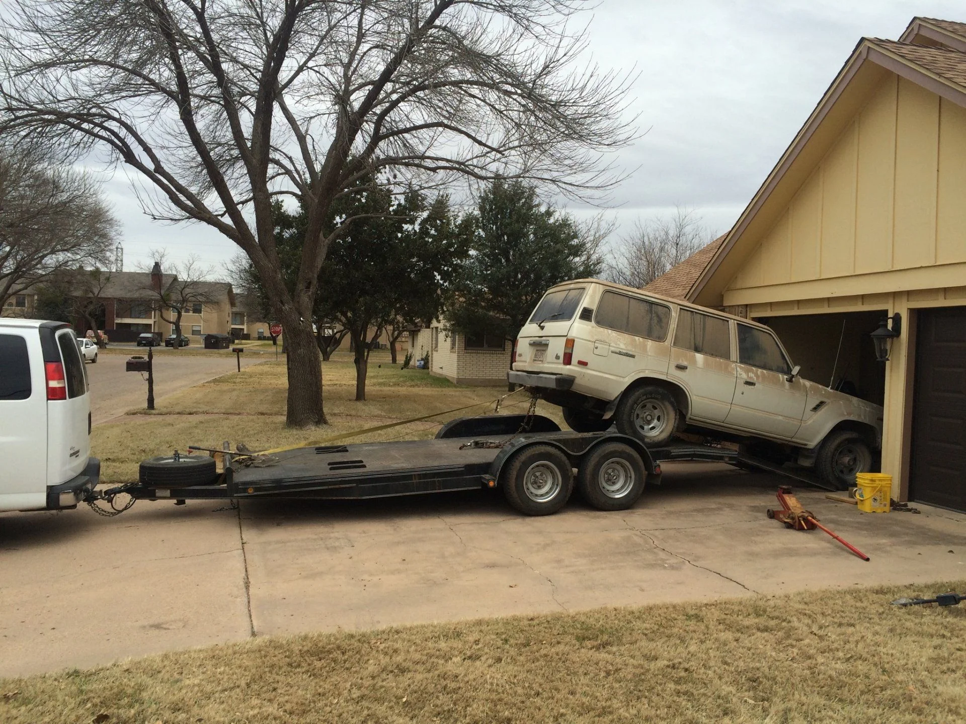

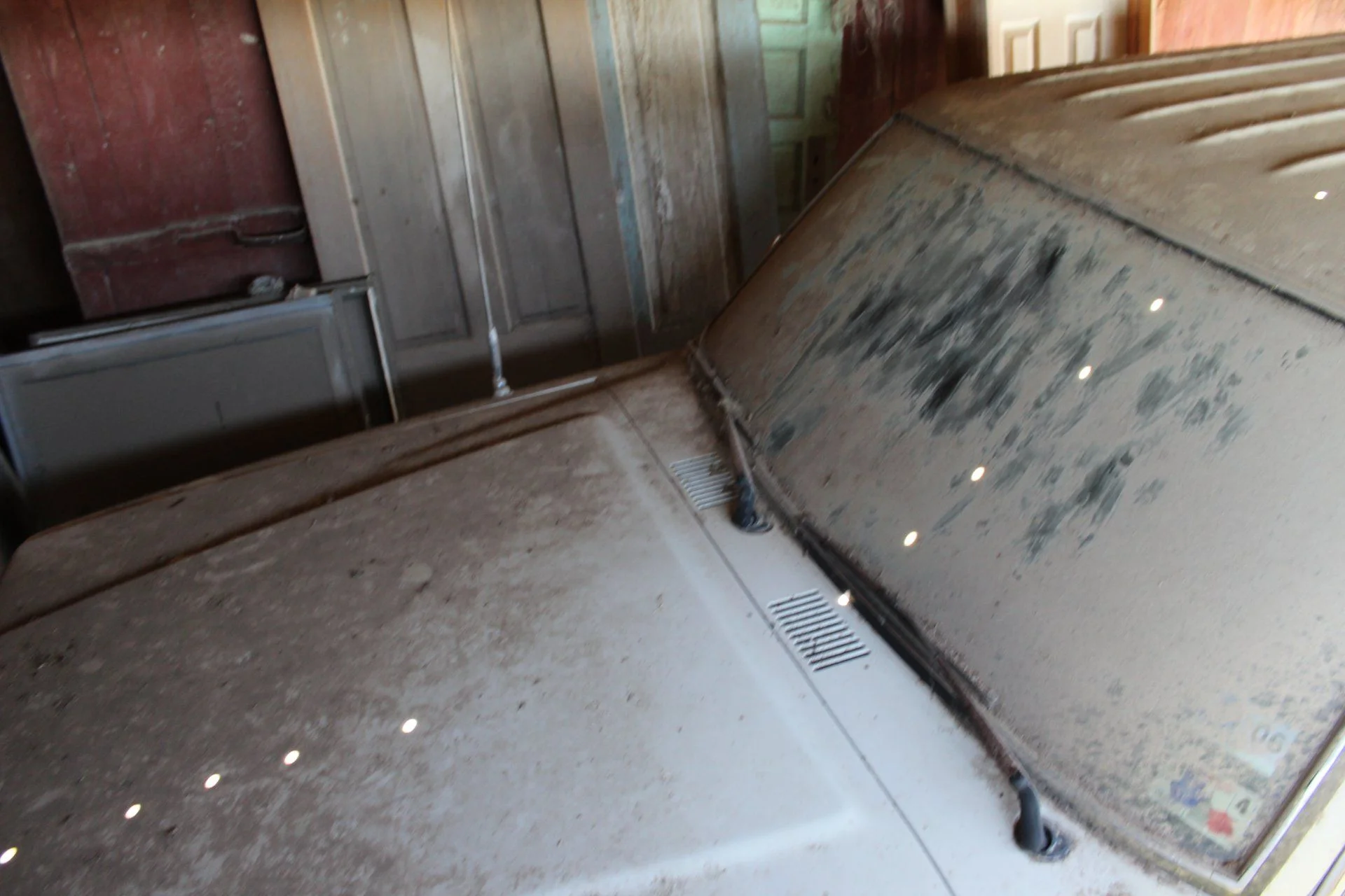

Here are some pictures. Yes I have the ability to rebuild the carburator, but I am interested in checking out other carbs since I will be dropping Smog pump and CAT. Have any of you had luck with the Weber 38? My interest is to improve efficiency.
