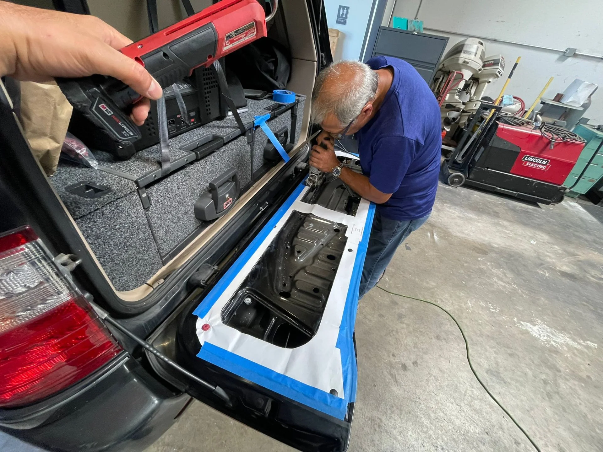

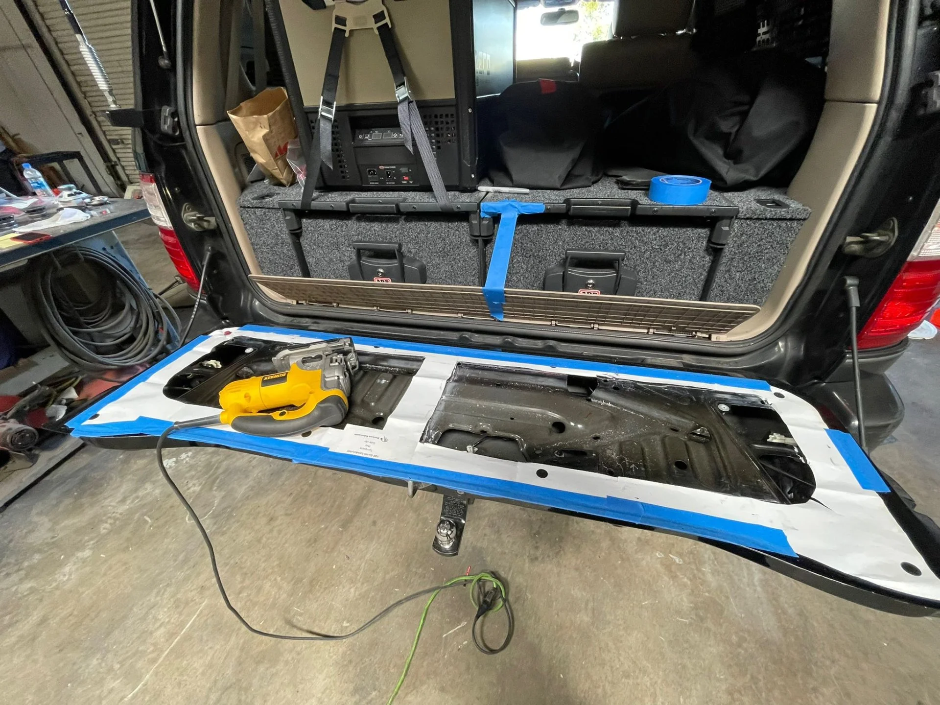

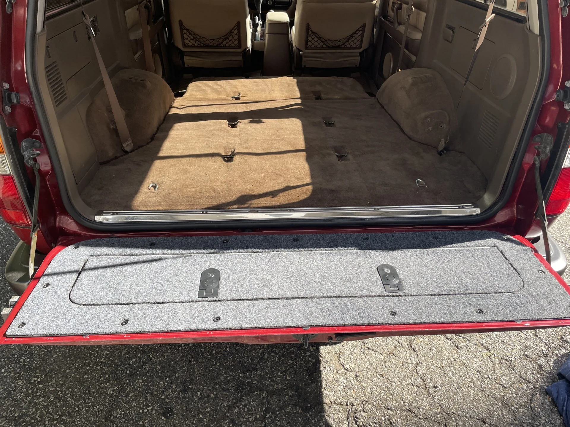

I got mine last week (shipped from TX and delivered within 3 days in CA) Just finished the installation! super simple!

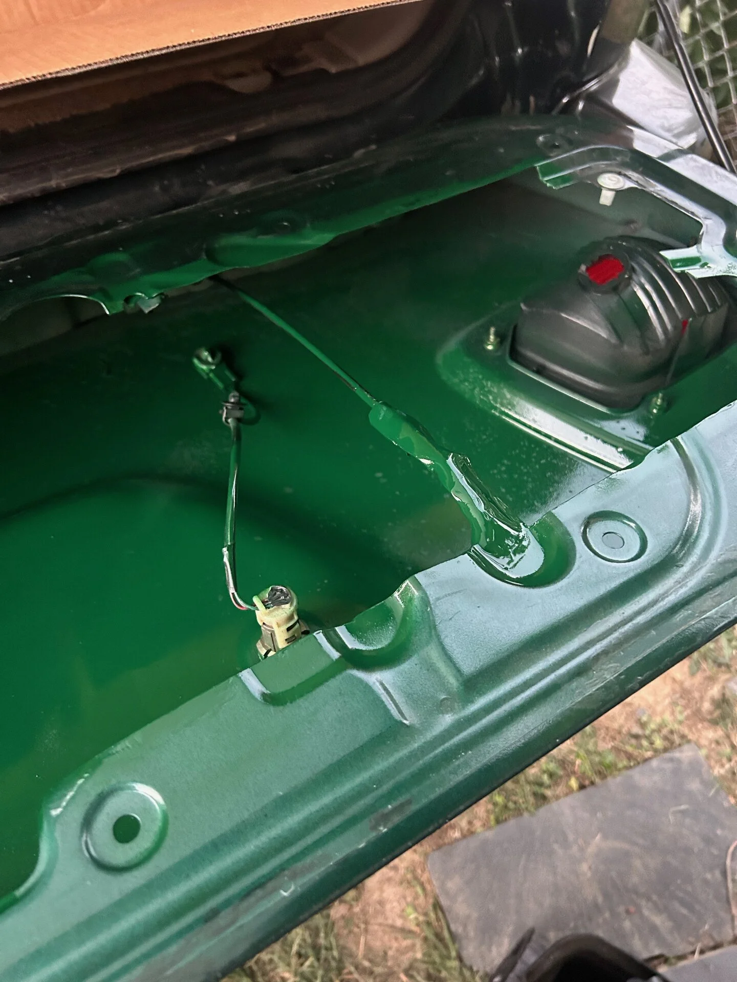

When you get done, turn on the lights and make sure the stop light and reverse light working properly, one of my bulb lights were bad due to cutting vibration.
Thanks to @sleepycruiser, Huracan Fabrication & my neighbor! :)

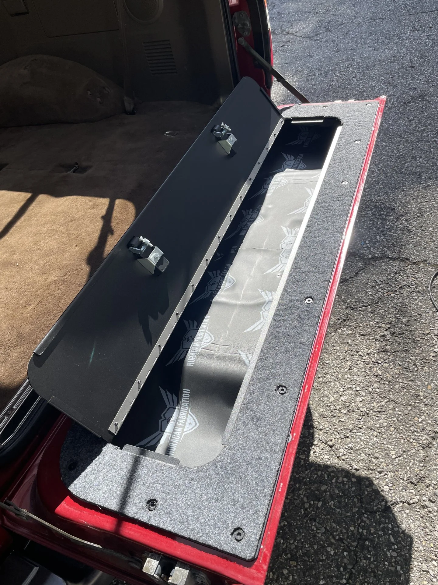

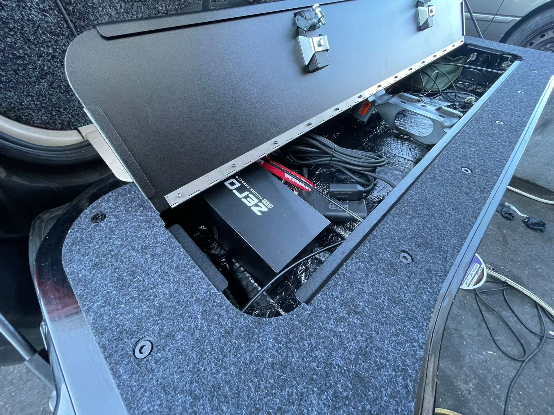

Removing the spring assist makes the tailgate feel a lot heavier. My only regret regarding this mod is that I wish I had taken the time to figure out how to relocate the ends of the spring inside the tailgate, towards the outside, instead of removing it completely.
I ended up keeping my spring tensioners by keeping small parts of the metal in tact. I still feel that I have plenty of room to get things in and out of the new cavity.
