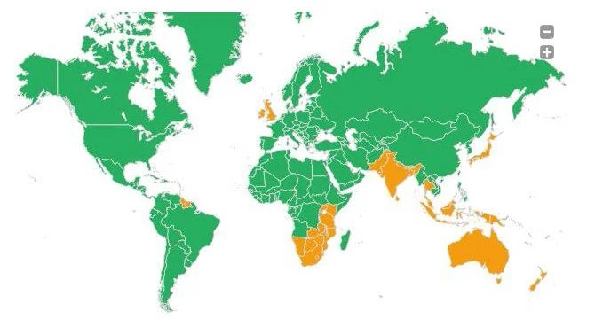

And this is what a Google search says:
Green drive on the right (with LHD vehicles) and Amber drive on the left (with RHD vehicles).
:beer:
PS. And decent headlights should always dip away from oncoming traffic so that's why different headlights should be used.

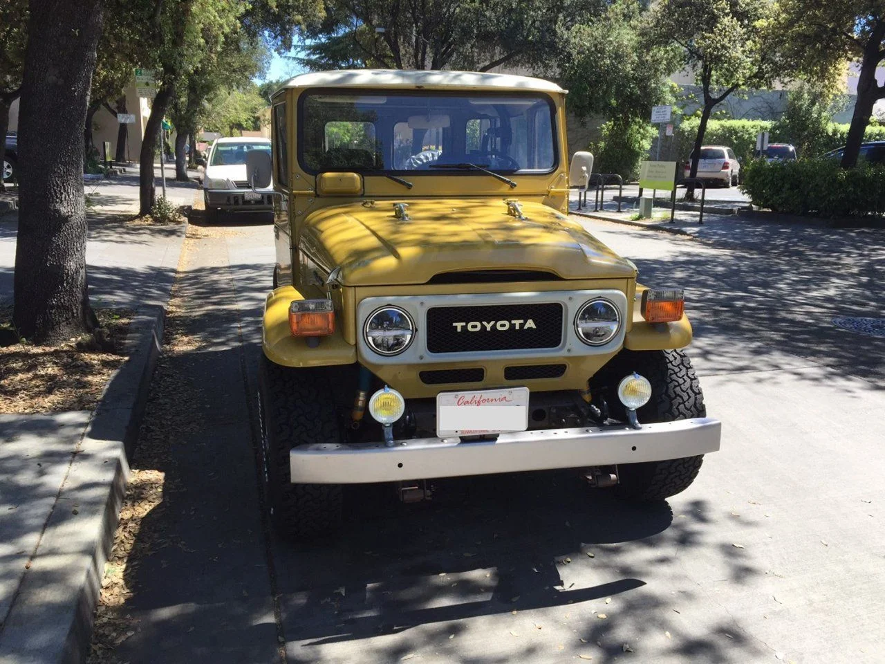

LED headlights are now in stock.
As mentioned, the new version has DOT marking, and DRL. It has an aluminium colored housing, so the appearance is closer to a regular sealed beam light. For those who care, the protrusion is reduced, as can be seen in the photo.

Bulb profile/face looks a lot better , I see those are rear-firing chips , got any night shots yet ? What part lights up for the DRL , the cross bar ?
Also , interested to see what the rated wattage is on the chips, type , color temp and rated lumen output ...?
I've ran across a Rover guy south of me that was using the RHD lamps on his RHD Land Rover - really noticed the profile of that thing at night as it was blinding . Followed him to a gas station to chat - he had no idea why everyone was flashing their brights at him since he'd adjusted the headlights to the lowest possible angle they would go and he could hardly see the road . He's going to swap out his lamps since they are the older sealed beams anyway and going with LHD units instead . I didn't have my 40 at the time but showed some pictures - he's always wanted one and looking for a good used project truck , wished him luck and to be wary and let him know MUD is the best research tool available - maybe he will show up on the forum later...
After looking some more at the head-on picture those led's don't look too bad , at least the divider bar sort of blends in with the retaining ring enough to make it look more at home . Wish there was a way to make a vintage-looking led that would work properly but doubt that's going to happen just due to optics and limitations . I'm definitely interested as I let my H4 conversion bulbs from Shane go with the Taco when I traded it - they just didn't work all that well with the IPF lenses I have .

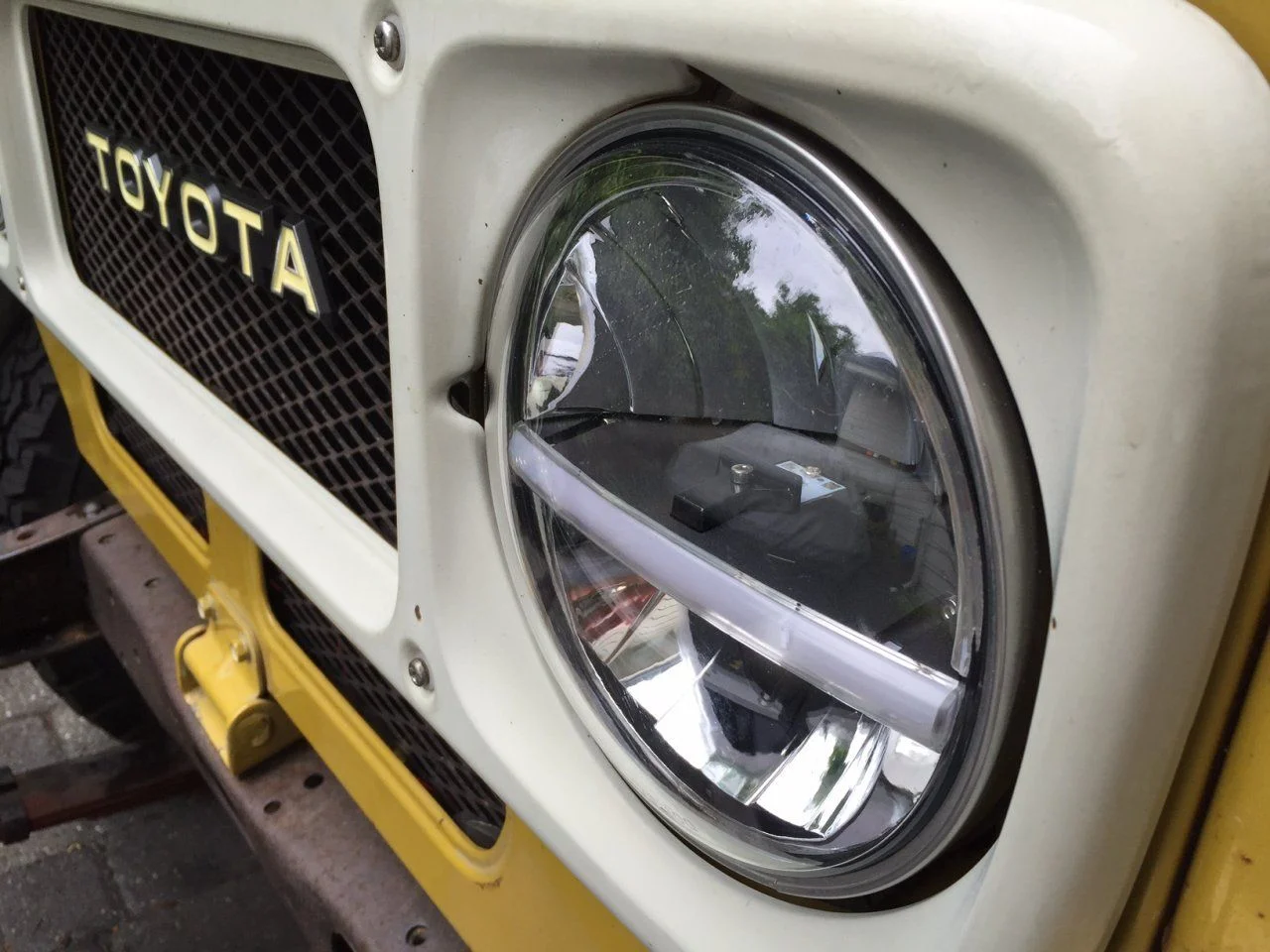

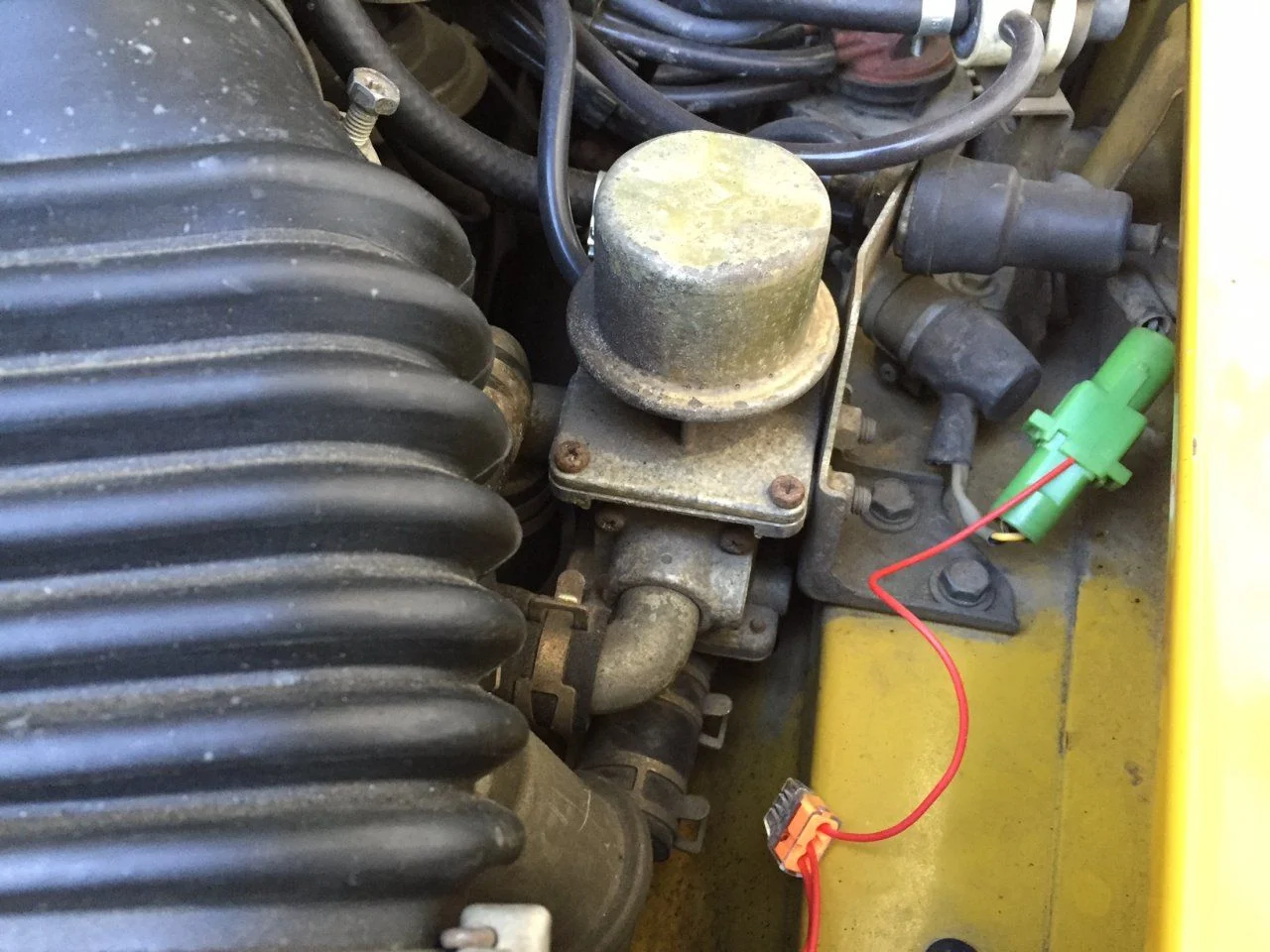

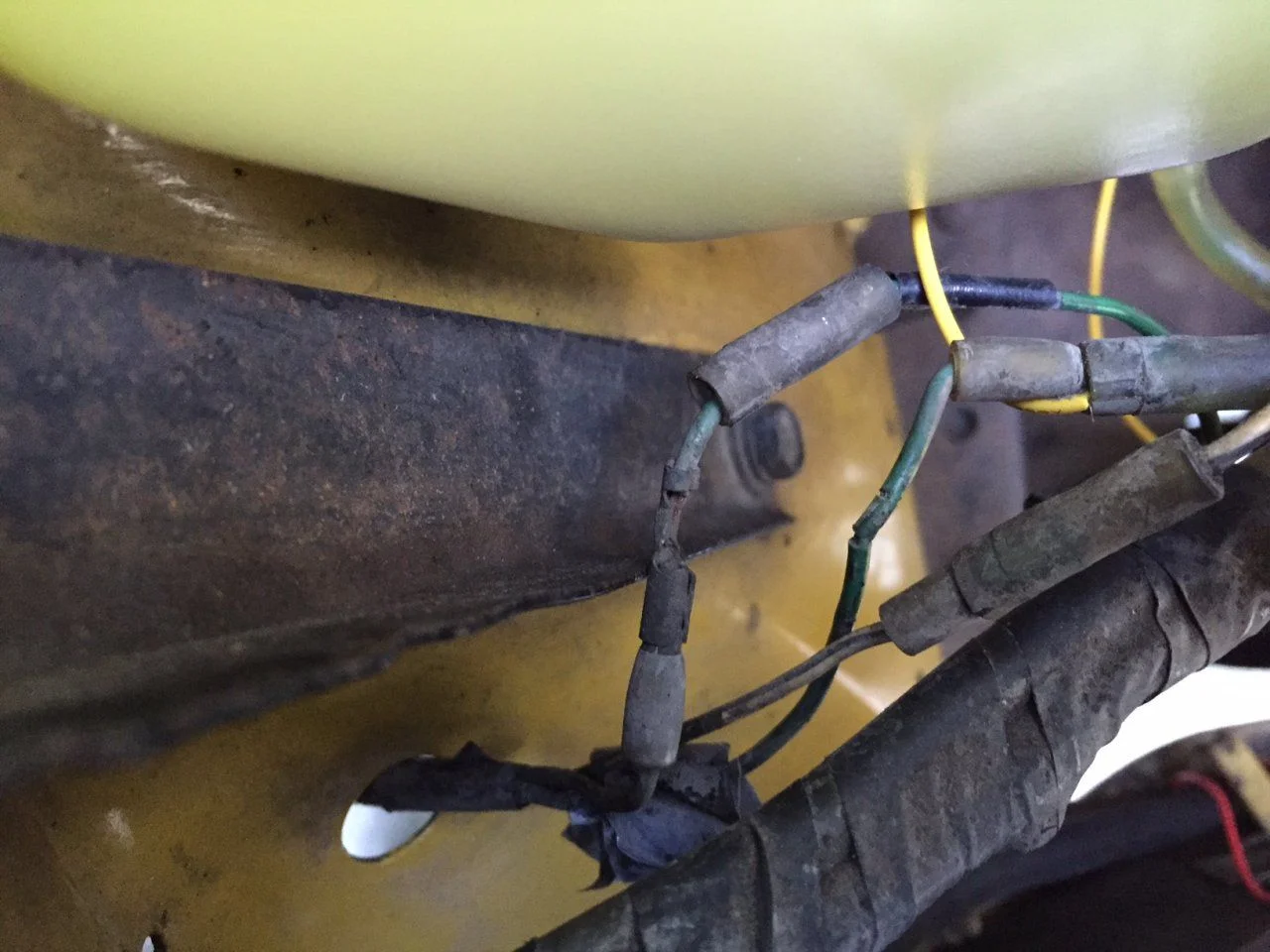

Let's talk some tech. To hook it up, there are 3 connections:
1) The headlamp connection is simply plugging in the standard H4 plug
2) For the DRL, you tap the red wire into an ACC source. The VSV is a convenient source, as it's right under the hood. However, you can feed the red wire into the fuse box if you like. I supply you with the 3 input connector to save you a trip to the hardware store.
4) For making the DRL blink in concert with the turn signals, feed the yellow wires into the turn signal wires on both sides. The turn signal wire is green/black on the left side, and green/yellow on the right side.
I am also interested in night photos (maybe with a comparison) and specs as well...

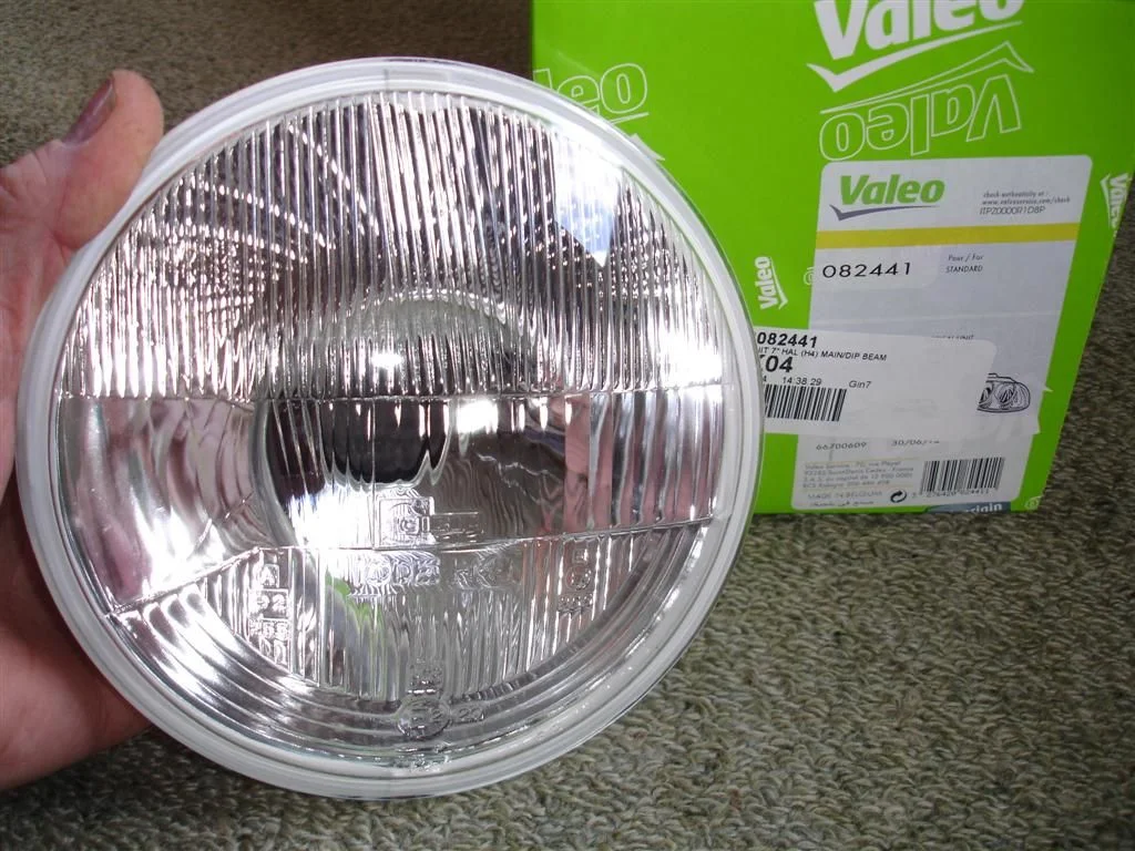

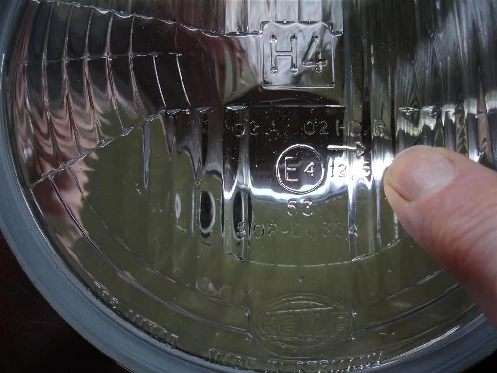

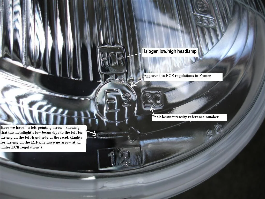

Just another note on the RHD vesus LHD lights ....
Euro spec lights that are designed for vehicles that drive on the left (and it must be noted that these should be used on ALL vehicles that drive on the left regardless of whether these vehicles left the factory as LHD or RHD) should have an arrow on the glass pointing to the left.
Firstly here's that arrow on the Cibie brand:
Near the bottom in this case...

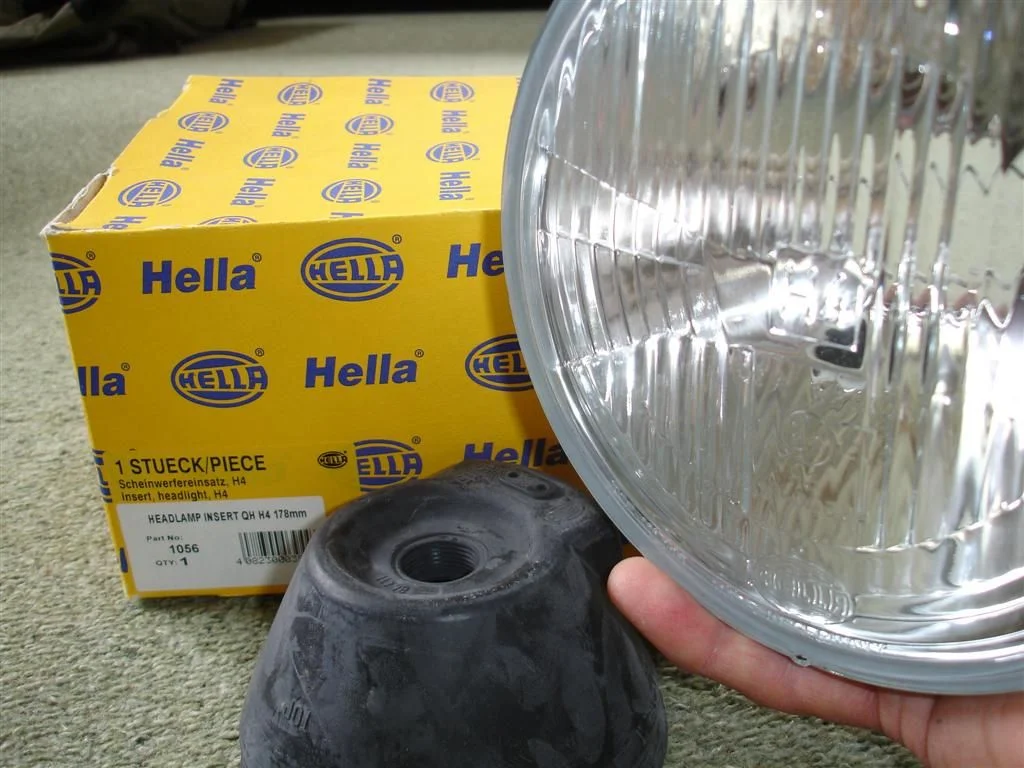

And here's the same thing on a Hella light that is designed for use in drive-on-the-left countries:
So the converse applies too and when a vehicle is imported to the USA from a drive-on-the-left country such as here (New Zealand) or Australia, one of the first things done should be swapping out the headlights (so you don't annoy other motorists by blinding them while driving at night)..

interesting info
so racer's lights(and mine) are correct for folks driving on the right hand side with a LHD truck?
interesting info
Yes I believe so.
I think the only problem would be if someone like me from a minority drive-on-the-left country decided to order and fit them.
